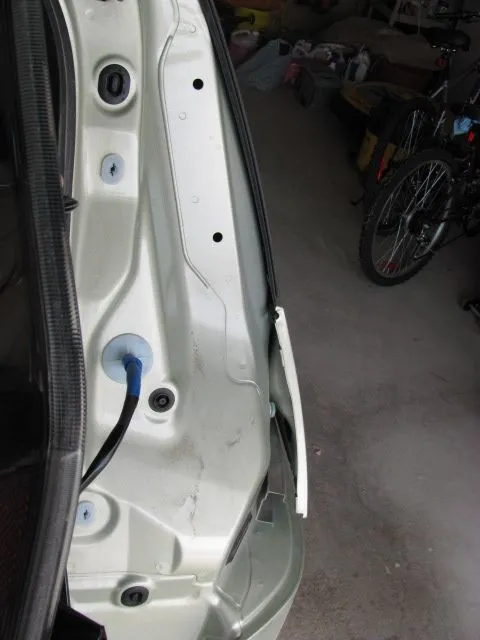

Just got the new 2009 M5 GT and now planning to install this back up sensor, which doesn't need to drill holes on bumper. Have learned a lot from this forum, like how to remove bumper, tail light housing, etc. Now I have one last problem: I need to tap into the back-up light so that it can control the ECM of the senor on and off. I think the best location for the tap-in is right behind the tail light housing, but then how should I run the wires down to behind the bumper? I can drill a hole on the body panel behind the housing, but I am afraid after drilling damages the paint the water dripping down from roof will cause corrosion, or even worse that the water may get into behind the panel.

I installed the same sensor In my 08 5, there are pre-made holes with plastic caps behind the right taillight and under the right side corner of the under body, next to the bumper, just drill a hole on the plastic caps big enough for the cables to pass and when you are done put some clear silicon on it.

There are 3 black rubber caps behind the taillight housing, as shown in the attached pic. Which one did you use to drill the hole to let the wires pass through? or the white one used by the factory wires?

I used the black one next to where the factory cables come out. they work great here( i dont get snow where i live) the only thing I have noticed is that if there is something metal on the ground, like a manhole it will give you a "false" alarm since there might not be anything behind the car at all

If I drill a hole in one of those caps behind the taillight (once removed). I will have access inside the body sheetmetal?... and I can snake wires down to the bumper?

I just did mine, I used the rubber plugs that are already there under the car to put the wires through. Didn't even need to take off my bumper, just went under, popped off the stock reflectors and ran the wires up through the plug and up behind the sheetmetal to another plug right next to the light wires and tapped in right behind the tail light. Easy as sunday morning...haha(headbang) Sorry if I had a camera, I would have taken pics....

sorry Red Headz I meant the caps (I called it plug) it was probably pretty easy for me because I had already stripped the car for Dynomat(squinty)sorry minute detail huh (chair)....
if you lay under the car you can see the caps, drilled a little hole there too...but filled it with silicone to seal it again. so I probably did it the same way as you, besides stripping the interior...
