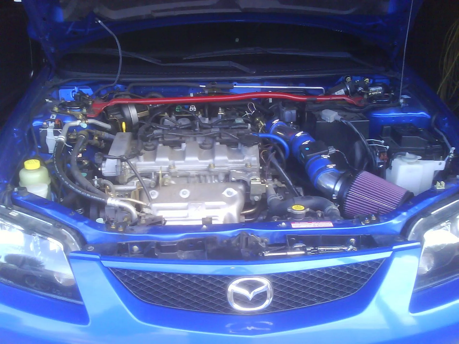

i recently installed a local brand SRI with K&N filter. I thought of buying one from bomz before but eventually decided to support the local. In total, i only spend about $100CAD.
After installing the SRI i hv some questions
1) Is it normal to hv hissing sound when the car is idle? i am afraid i didn't install it properly since this is my first engine mod.
2) I notice my mazdaspeed sport exhaust is a bit quieter than before. Should this happen? cos i always think intake would make the car louder. Now, i think it is better since the MS exhaust is quieter.
3) Did you guys notice any performance improvement? For me, i think the car revs a bit faster between 4-5k rpm. Am I imagining things?
4) I read many people have rubbing issue with their SRI. How can you tell and where are the locations that rub? I know it is the master cylinder and something do with the brakes, but where are their physical location? I don't know much about the engine bay.
Anyway, this is my setup
Yep, you'll 'hv' (wtf? x 2) some hissing from the filter area. If it's from anywhere else, uh...you probably did something seriously wrong lol
It's probably quieter in comparison in that before the engine barely made noise and it was all exhaust. Now you have all that intake noise too.
probably not. It'll pull a little harder.
The elbow from the throttle body to where it connects to the MAF CAN run on the Master Cylinder (metal thing with pipes...where your brake / clutch fluid goes, bolts up to the firewall). If you hear some really loud metallic rattling, there's your problem. If not, you probably have the clearances correct.
Anyway, this is my setup[/QUOTE]
lol yes, or you'll have a special edition 'vented' intake. Unfiltered air = bad...
