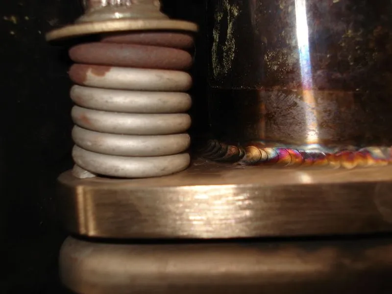

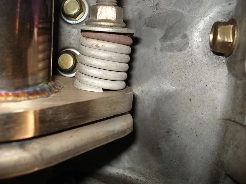

Amsgator: you have the OBX right? How tight did you put the spring bolts?
i didn't use a torque wrench so i cant give exact numbers. why maybe too tight? i might be able to borrow one and get it to what it should be. are there numbers for them?
well, you don't need exact numbers. I mean, did you tighten them all the way down, or is there still some room for the springs to move?
there's still room for them to move but i can try to losen them to make sure. how much of a gap should there be btwn the spring coils?

EDIT: i attached pics of the spring bolts. aMaff asked if they were too tight. not sure... are they? i had a friend put them on for me while i was doing somethin else.
