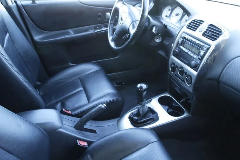

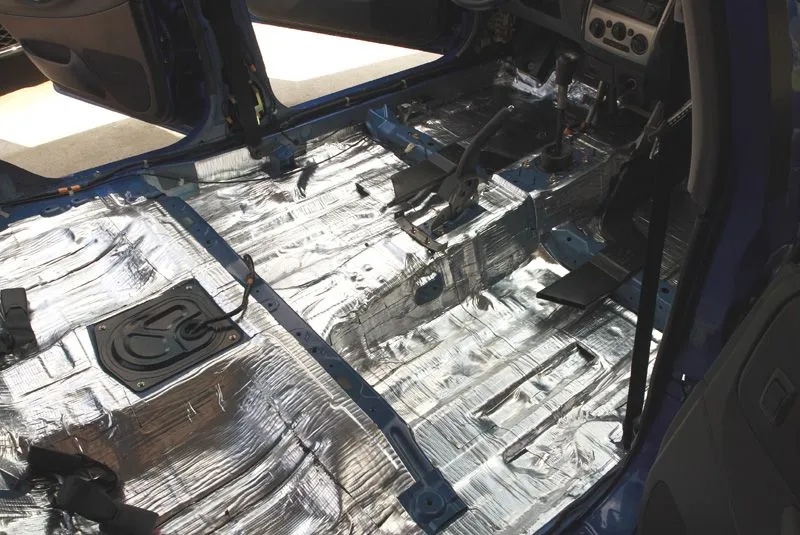

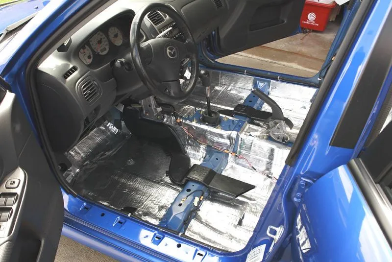

Got everything done and back together - total time about 10 -12 hours including the removal and reassembly of the interior. Only thing left is test drive it.
*Update - Test drove the car and it definitely made a difference. Our roads have a lot of breaks from winter so you get alot of suspension noise. Now you feel the bumps and not the noise, its really muffled, awesome. I actually have the radio turned down too , it was ok before but its an improvement, for sure, worth all the work.
That's friggin major, good job.
Good job (rockon)Are you considering doing the doors?

Kansei said:
yup those are the ones. I had to order though because the napa near here shut down a month or two ago :(
cool, i just bought some for a fellow member silghtly used for 40 bucks
Nope. I personally do not want to ruin the factory sealing on the doors but I feel door hinges have a difficult time as it is holding up such heavy doors so the added weight would just wear them out even quicker and it would not a be huge improvement. Most road noise is generated from it bouncing off the bottom of the car and after an hour drive in the car its really quiet. It just seems a bit better, by no means was it bad before. It's nice to have the car back together especially since it still new to me. I will finish off the trunk area however.
The funny thing was driving around for a couple of weeks with no interior just how cold or hot the floor gets so I think acoustically it will help but maybe it will stay cooler or warmer from the install too, who knows.
