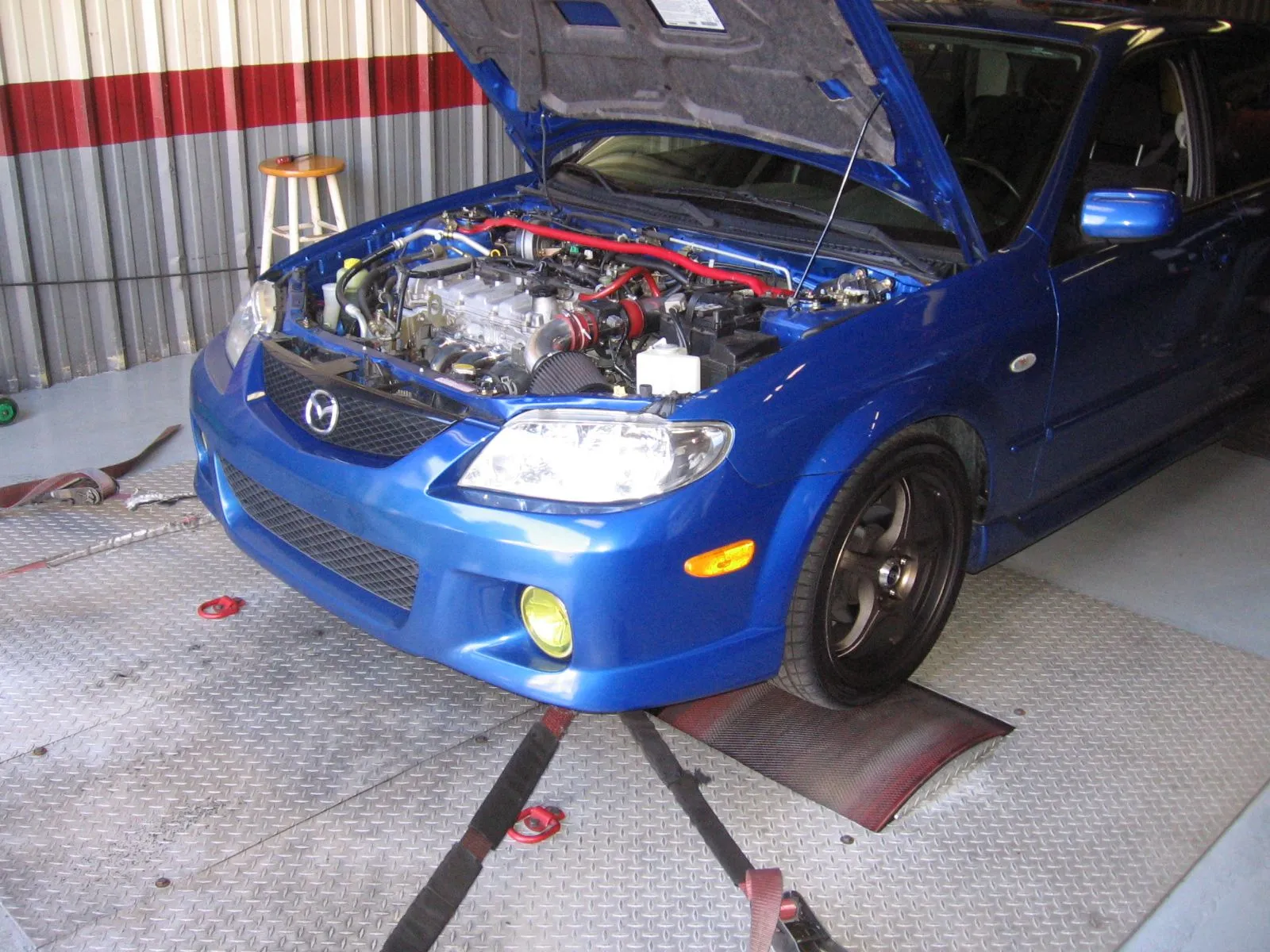

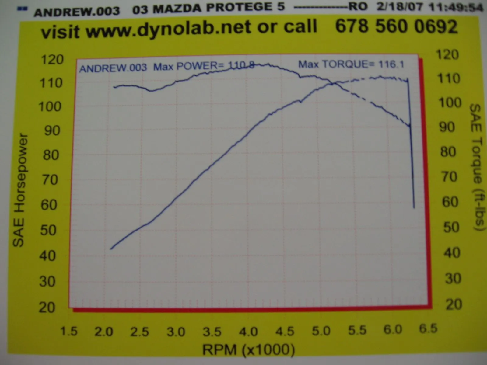

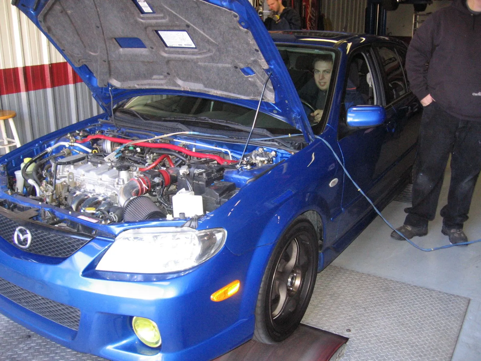

GACC Dyno day! DynaJet dyno. My race car puts down less than my street car lol. Either way, they're both slow as hell. 4th gear pulls took like 15 minutes ;). I'm actually very pleased, comparing my car to other NA proteges there. 110.8 hp and 116.1 lb/ft to the ground. I only had better numbers by about 2 hp and lb/ft than the others, but the BIGGEST (and looking at the dyno sheets, it's huge) difference came in the power delivery. The 2.0L pros running stock ECUs had graphs that looked like they were drawn by someone having a seizure. HUGE bumps, all the way through the power band. With the MP3 ECU, the curve was almost totally smooth. If you've ever seen a dyno of a stock Pro, you'll know what I mean.
The Miata was a different story. Poor girl only made 90.8 hp and 85.7 lb ft. And that was without the air box lol. Oh well. Can only get better from here! It actually picked up 4.5 HP and 4.3 lb/ft from running with the airbox / filter. It was meant to be a baseline dyno full stock. The only thing that detracted from that was my wheels / tires. I would have gained a couple by using the stock 14s, but I wanted to see what the stock motor would do with the car in race trim.
EDIT:
For those who may not know everything, here's what my motor's got:
E-Bay intake with K&N cone filter
Ractive long runner header
Stock mid-pipe / cat
Racing Beat Cat-Back from MSP cut to fit
MP3 ECU

ROFL, Drawn by someone having a seizure is an understatement. I have seen stock Protege dynos and am also impressed with my MP3 ECU dyno.
I was at 116.8 before the new flywheel. I'll see what it is next month. AZMC has reserved a dyno for a club day in 2 weeks.
We have a mini carshow next weekend then the following weekend is a dyno day. Then it off to NOPI on March 17th..
Comparo
N/A on stock ECU, catless 'turbo' back exhaust, stock header (he is going turbo this month, and already has the exhaust on lol), lightweight flywheel.
N/A on MP3 ECU, Ractive header, stock midpipe, RB cat-back, e-bay intake:
When I say it smooths the power delivery, I mean it SMOOTHS the power delivery.
note: that was the filterless run...
But my first two were also very choppy and picasso-like.
(and the exhaust is on b/c I didnt feel like spending $10 on bolts to put the stock one back on. stripped ftw!)
