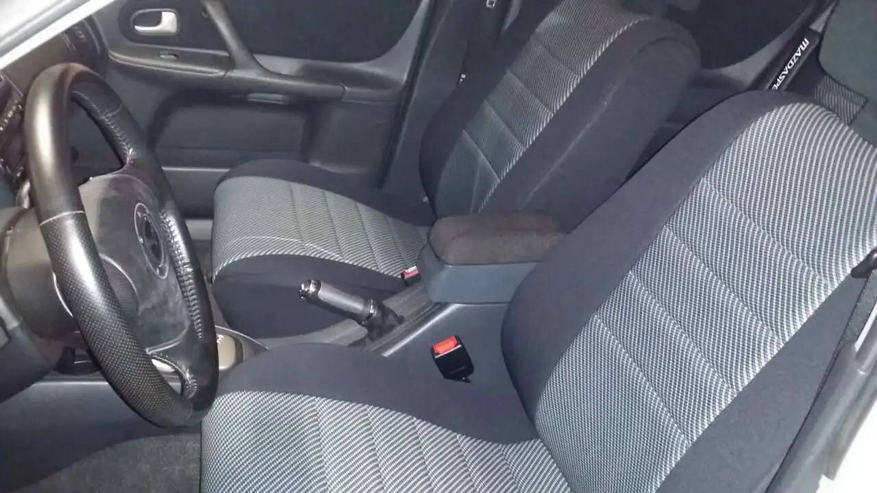

Finally gotten around to installing the EDM fold flat passenger seat I got from Germany weeks ago.
It started raining as I was putting it in, then the hail came after I pulled the car back in the garage. The struggle is real!
That is cool. I like how the seat is cut out to go around the raised arm rest console. Mine has different fabric on the lid. Where is yours from?
