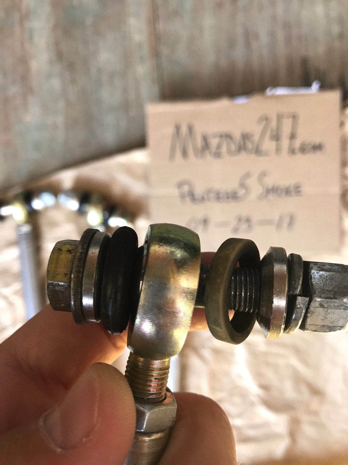

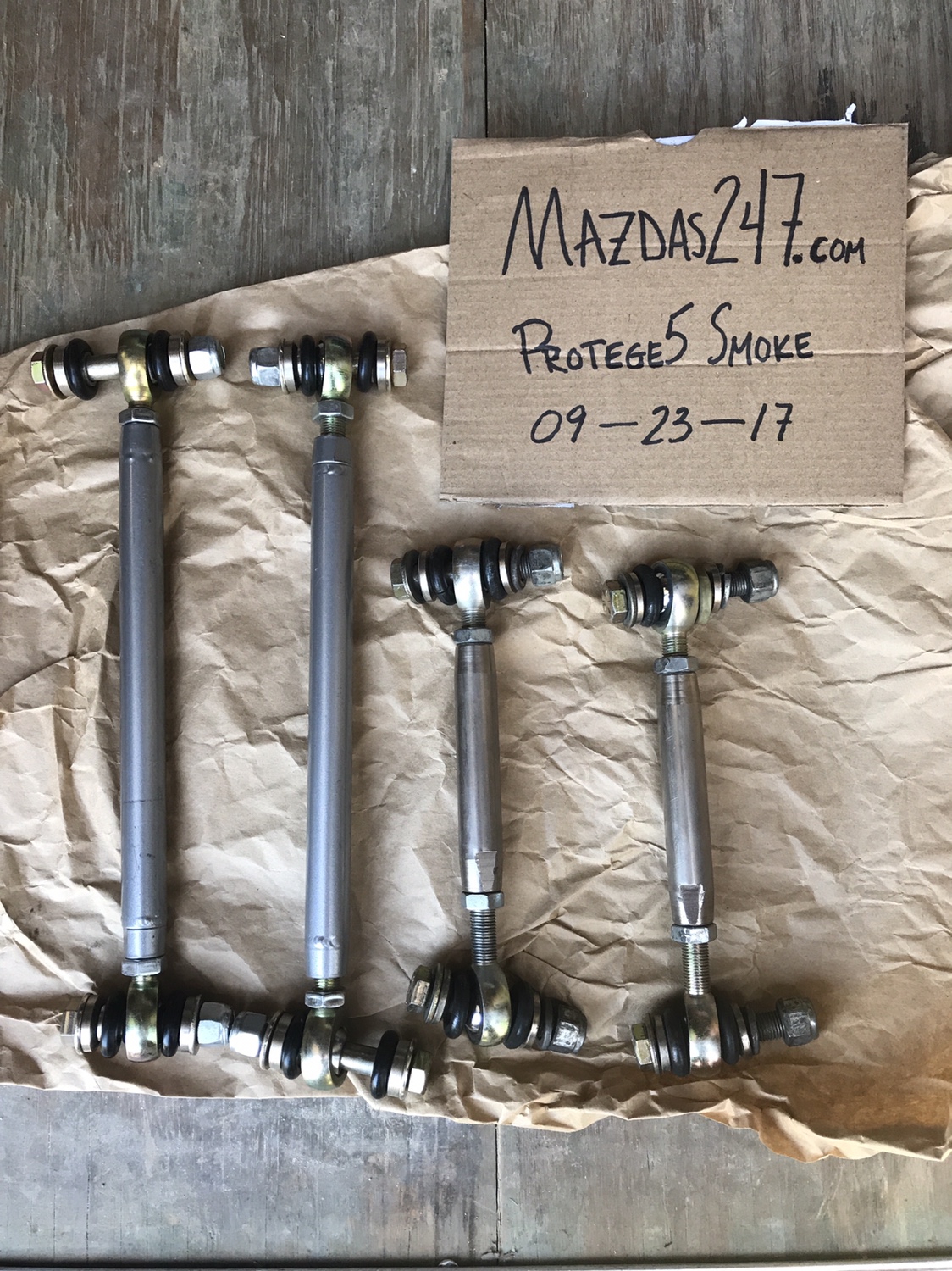

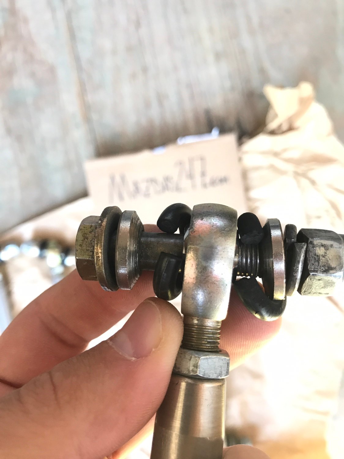

Used never scared me before, post a F/S compliant picture and I'll think about it.. Surely they aren't are rusty as mine.
Ok, here we go, sorry for phone quality pics
The flat o-ring is useable, just different from the rest. Guessing previous owner replaced that one. The other two stay closed, I just pulled on them so the break shows up better. They probably do need replacing tho. $160 what I paid for them, never had them installed

Regarding the orings on those endlinks; Midwest Controls has some rubber boots that fit nicely over the rod ends as dust boots. Part number RS375. I trust them a bit more to keep debris out of the rod ends than the orings supplied.
I'm still hearing a clunk from one of the Midwest Controls rod ends, but I'm searching for one with the right race material (steel on steel right now. Going to try steel on nylon next)
