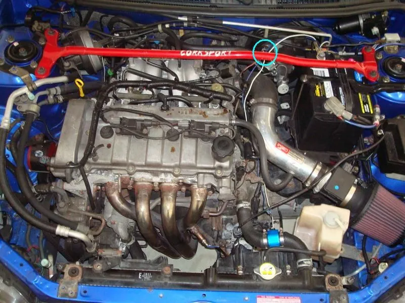

which is the brake booster line? I need pics :(
And once smoke screen is gone, do oil change?
Isn't there a few other places to seafoam too?
I find it easier to start the car w/ the brake booster line off (it will run, just not well) then use 1 hand to rev the car using the throttle under the hood and the other to hold the seafoam cup (or Jen will help sometimes and hold the cup while I rev it under the hood)
bah, its the big vaccuum line comming fromt he brake booster. no pics.
after smoke is gone, change oil and plugs.
putting it into the brake booster is plenty...
pics?
Which hose?
You shouldn't have to change the oil if your only doing throught the bb line to the intake and/or adding it to the tank to clean the fuel system only if you do the crankcase. You will also have to sip a little at a time while blipping the throttle or it can bog and die.
its the one that connects in this region (cant make it out exactly in this pic) and runs back towards the passenger side
