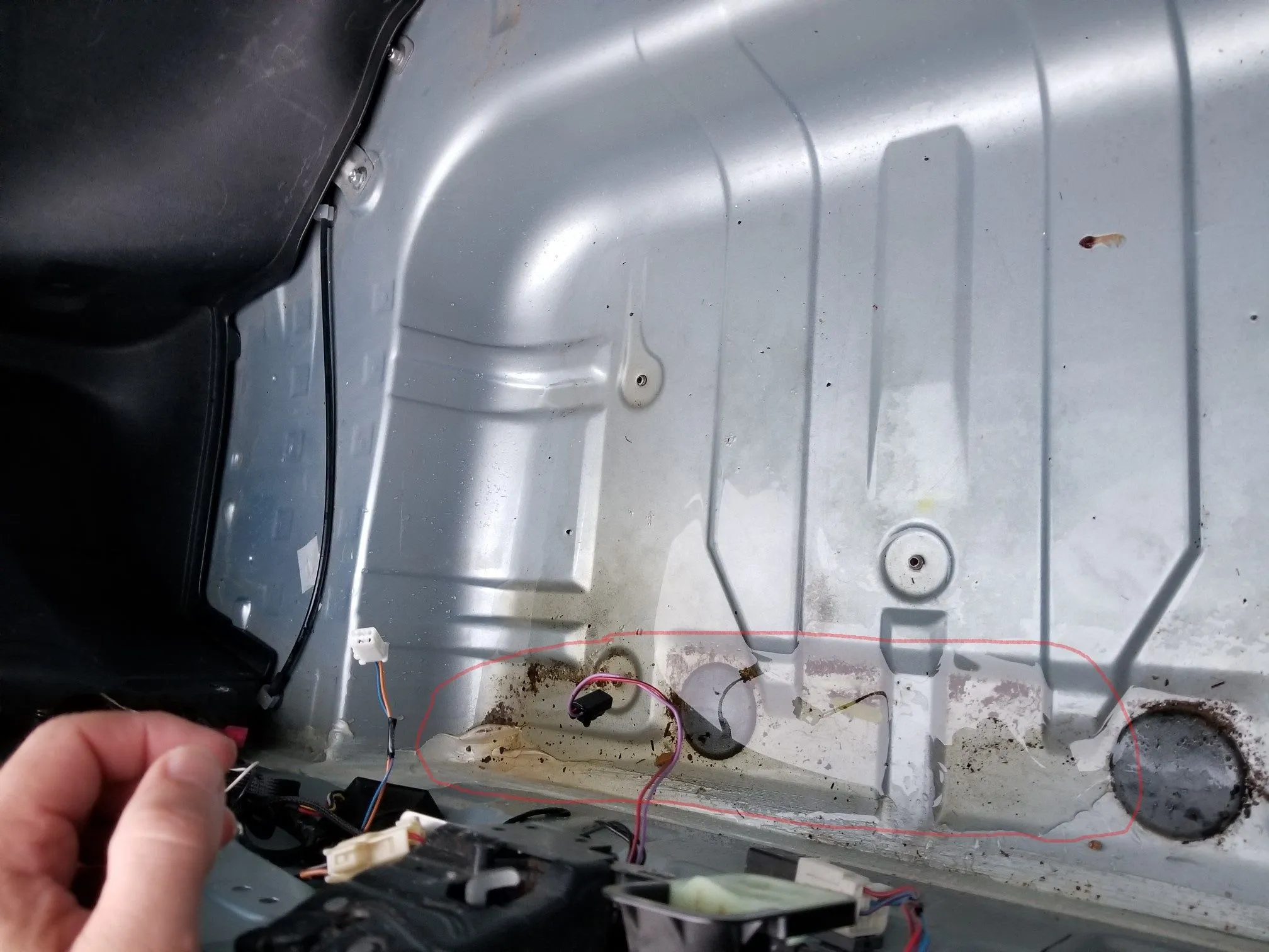

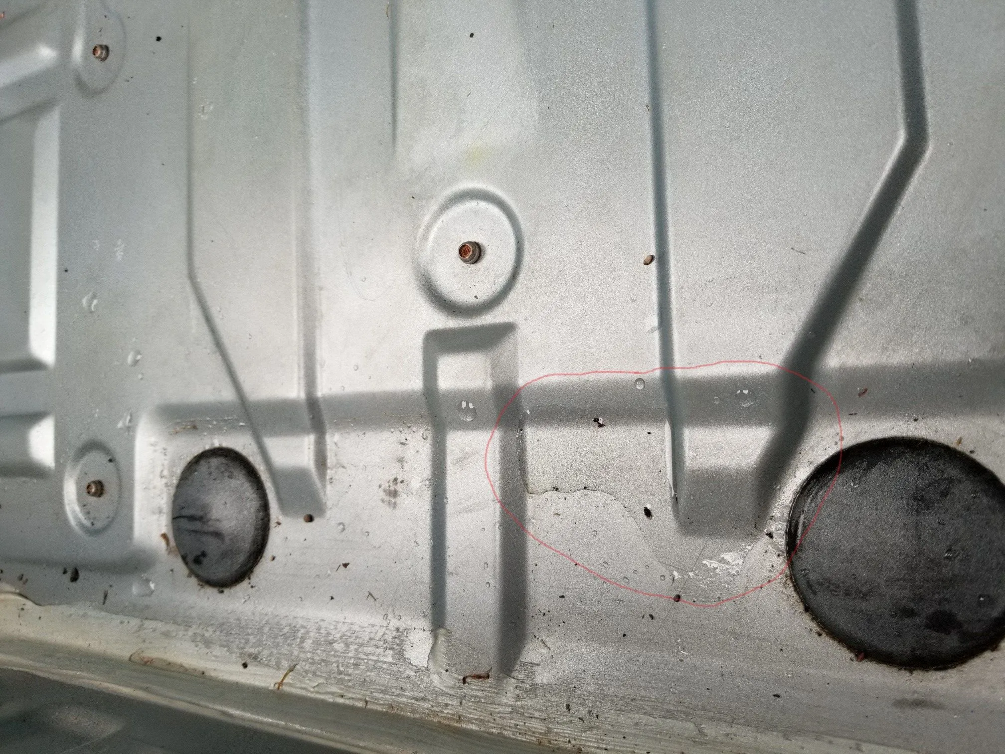

Last week I found water in my trunk. The padding to the carpet was saturated and I could have used the trunk as a bird bath. I pulled the carpet and all of the plastic out and cleaned up the mess. Saturday, I broke out the trombone brush to clean the drains and couldn't get it to push into the tubes (cleaning the NB tubes is much easier!). Pulled up some youtube vids to get some tricks and finally got through on the DS. Not much in debris came out and the brush head was wet to the touch. Get to the PS and I can't get the brush in at all. Waited until I was back in the office on Monday where we taped some welding rod to it to make it firmer and still nothing. Next we tried straight welding rod and can push it through a little but then get a lot of resistance and nothing. Broke out the borescope and verified we were getting into the tube and can see the sludge but just can't get it to move. Lunch was just about over so we packed it in. If the rain clears up today, we are going to try to blow it out with the compressor. Just hoping it doesn't backfire. haha
I'm pretty sure it is the drain tubes as I washed the car on Saturday and made sure to fill the area between the top and the trunk up with water several times to see how they drained. Water was draining under the car but not where the tubes exit. While washing the car, I made sure to spray around the third brake light area, tail lights and license plate lights as I know they can have seal issues. Trunk was bone dry when I finished.
We just got another good downpour for a couple of hours. I went out and checked and had another small puddle. The confusing thing is that I can not figure out where the water came from as the rest of the trunk was dry?
