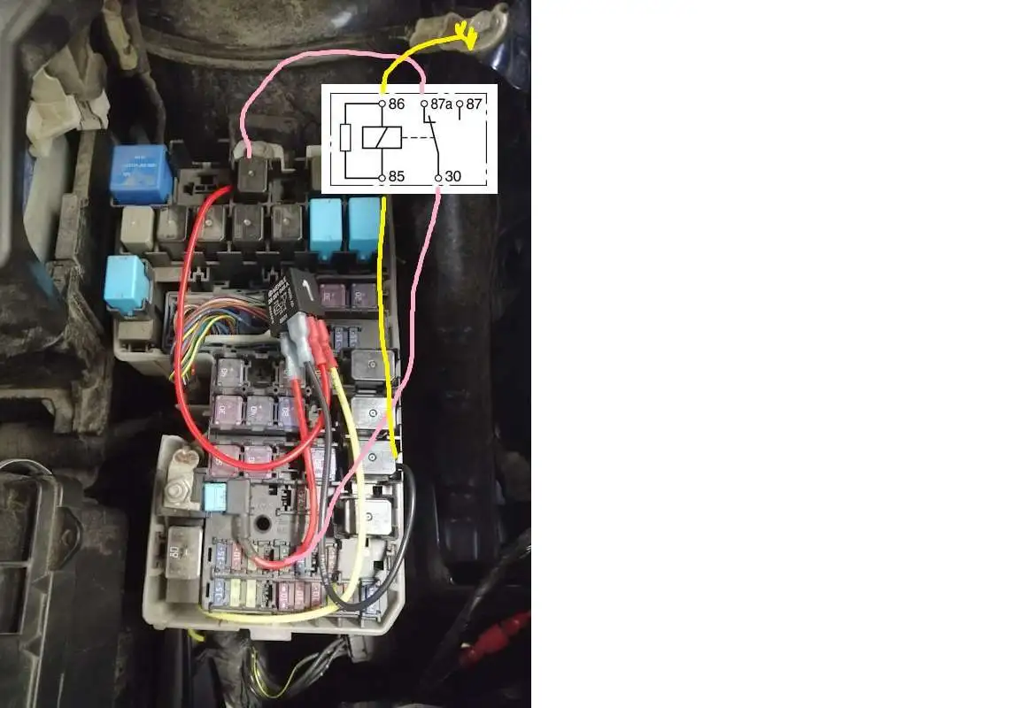

Finally success for me! I founded instructions/wiring diagram for four relays to use high beam bulbs as DRL's.
With those relays bulbs are in series when DRL, so half the voltage.
And in normal situation they are parallel, so they get normal voltage and are bright.
I installed relay pack near to fuse box, on the airfilter box wall.

I actually had that before, one relay in fusebox to light up fog lights as DRL's..
But I didn't really like it, because it would also light the light in instrument cluster every time.

Did you use parking light (turns on dashboard) as the trigger wire? If you use a 12v ignition power source to trigger the relay it would not light up the dash -you still have fog light toggle as master switch. I agree the +12 gen has large black covering with anemic sized fog light that looks out of proportion. I like the look of OEM fogs on 1st gen.

My previous connection was like this:
Power comes from injector fuse and triggers fogs relay.
TNS relay triggers my relay, so it opens when parking lights up.
Simple and works fine, but instrument clusters fog light lights up..
Also one nice feature comes with that, that injector fuse is power about 20sec. after shutting engine, so I have now also coming home -lights. :cool:

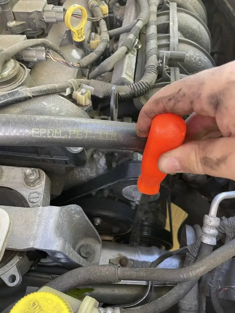

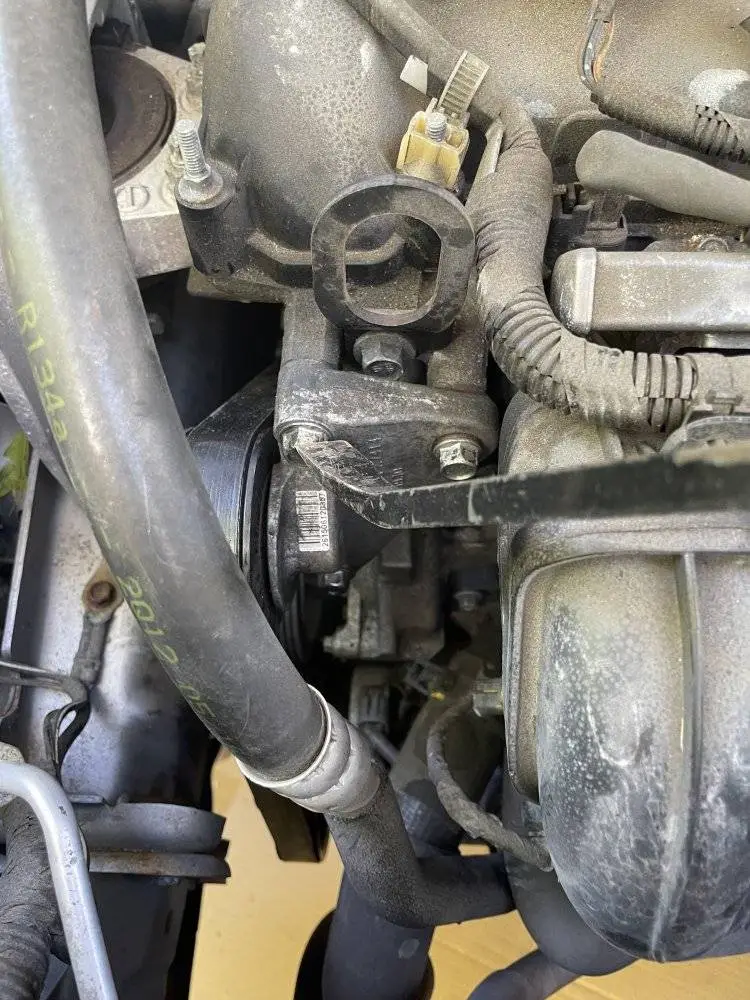

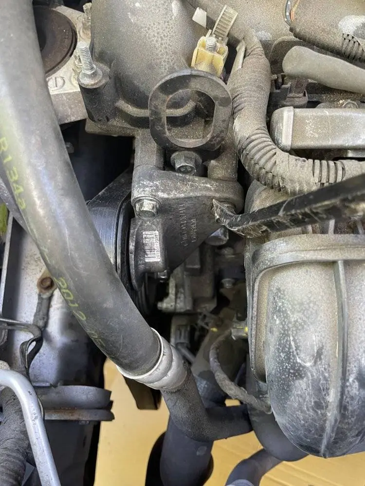

Serpentine belt today at 104k miles. Original was severely cracked. Looked at a bunch of instructions and videos, all of which suggested using a little plastic wedge tool to get the belt to stretch into place because the ‘12 model doesn’t have a tensioner pulley like the 1st gen models. Then I found one video by a mechanic who apparently had to do a bunch of these and decided to find a better way.
Cut the old belt loose, and route the new belt around every pulley except the top forward one. Then loosen the top two bolts holding the top pulley bracket in place. The whole pulley/bracket will rotate towards the right of the car when you loosen the bottom bolt. Pull the belt over the pulley, and then using a pry bar between the frame and the pulley mounting bolt lever it up into position. Stick the top bolts back in and torque them down. Less than 10 minutes including jacking up the front end so my son could help guide the belt around the pulleys from below. No special tools needed. (13mm socket, ratchet, 3” extension, and a 2’ piece of pipe because I can’t find my long pry bar)
I will soon be doing front and rear end links, RSB bushings, tire rotation, transmission mount, rear engine mount, and an oil change. Just not today.
Remove these two bolts
View attachment 303319View attachment 303320
Pry here (I used a 2’ pipe because this pry bar wasn’t long enough)

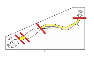

Hi Silent,
I didn't mention in my post that there was also a leak where the hanger is welded on the short piece of pipe between the cat and resonator so what they did was cut out that section and weld in a piece of stainless and a hanger, reused the resonator, and welded in a piece of aluminum custom bent pipe from the resonator back to the flange at rear of mid-pipe.
So cut at the red lines and replace the pipe in yellow.

Hi Silent,

Thanks! I need to fix/replace this section as well, and patch a leak in the piping that runs to the exhaust. The hanger attached to the short piece is soo rotted, I can bend it easily. Do you know/ask the shop what type of material their pipes are made of? This is my biggest concern that affects cost and durability.
I've only used Walker O2s and they are ok but def not the OEM fit/quality but you can DIY this section for $88. Maybe pretreat it as an extra safety measure..?
confirm part# 54830
buy part# here b/c $88 shipped.

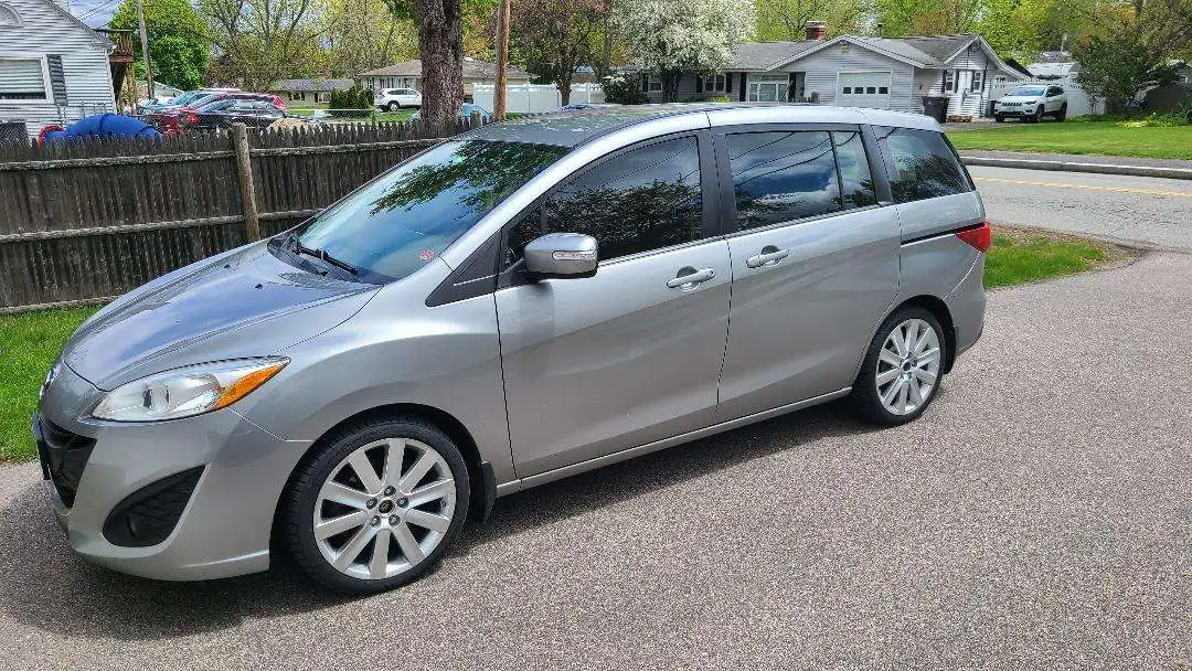

This past weekend I finally found that tire busting pothole! I had a decision to make. Buy two new tires, or mount the tires on the new (used) wheels I got over the winter. I just had to put on my new wheels. She looks great. Now I am pondering whether I should leave the ride as is, or lower with H&Rs.
BTW, does anyone know the part number for Speed3 wheel center caps? I bought a set on eBay which claimed it would fit Speed3 wheels, but they did not.
I like those wheels. What model are they from???
