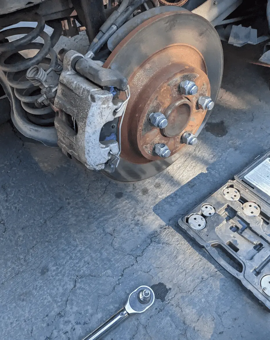

Yes, the pads still had something left in them, but after 9 New England winters, the brakes needed some attention. I would have loved to have enough time to clean everything and paint the calipers, but that will be something for another day :)
My wife finally relinquished the Mazda back to me. Heavy cleaned out all the kid stuff (thinking it might be her and not the kids). Wiped and scrubbed the interior for the first pass - will need a few more to get it the way I want. In the last month:
All the brake pads
Rear discs
Rebuilt all 4 calipers - right rear was dragging
Replaced the brake lines (were my culprit for low brake pedal - see the saga below)
On a mechanic’s recommendation replaced the master cylinder and sent out the ABS module for testing and possible rebuilding - it tested just fine.
Replaced the water outlet - the seat holding the gasket broke which started all of this.

Serviced the brakes, it was easy.
The rear brake pads no longer squeal when reversing, it was getting on my nerves!

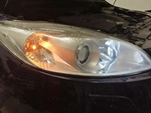

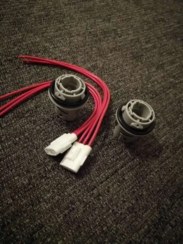

I got from AliExpress new sockets for front blinkers little while ago.
So now I can use #1157 bulb.
So I made US-blinker mod.
Now the amber lights up same time as normal parking light.
Normal to you US people, mod for us in european market.

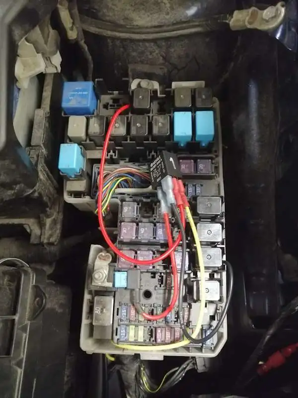

I also installed relay in fuse box, so now I have front fogs as DRL's

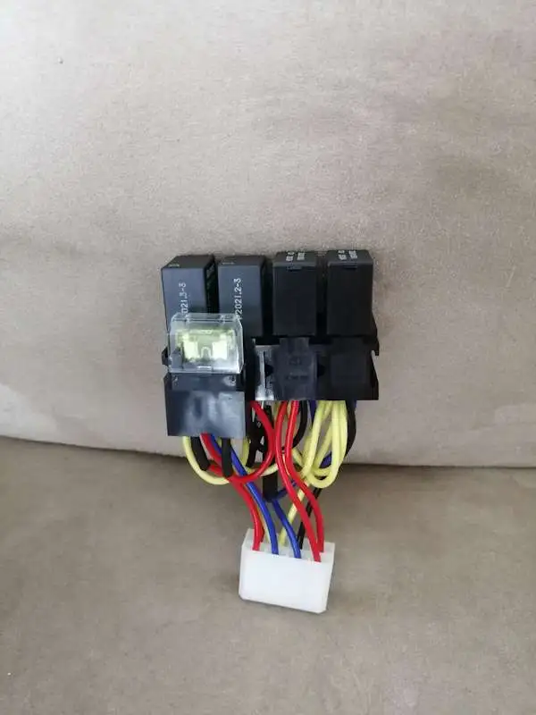

Finally success for me! I founded instructions/wiring diagram for four relays to use high beam bulbs as DRL's.
With those relays bulbs are in series when DRL, so half the voltage.
And in normal situation they are parallel, so they get normal voltage and are bright.

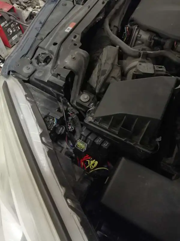

I installed relay pack near to fuse box, on the airfilter box wall.
Hard to take pics from lights. 😂
