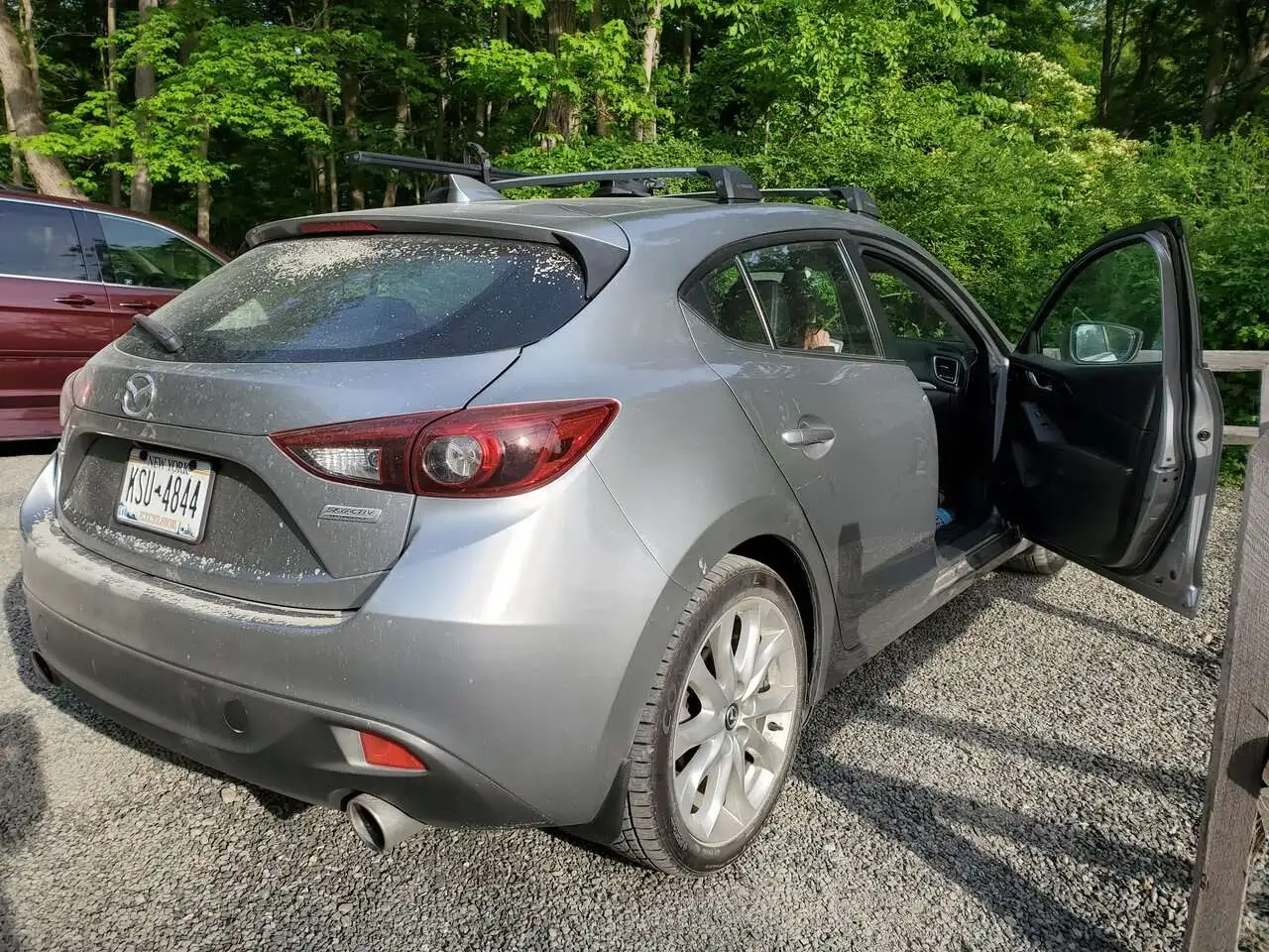

Blasted down a bunch of unimproved roads.
View attachment 321219View attachment 321220

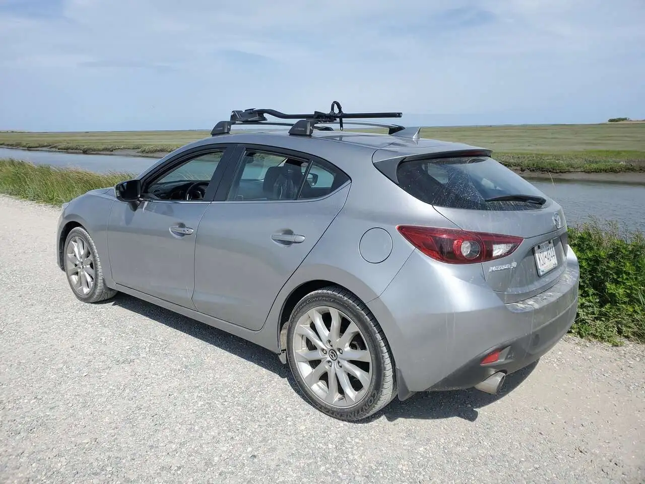

Sold this recently. Kinda regret it - just don't think there's anything out there (US) that's this affordable, fun, reliable and economical! Barely got above 3000 RPM in this video clip, and it was throwing gravel and rocks up against the mud guards and breaking traction, was a lot of fun!

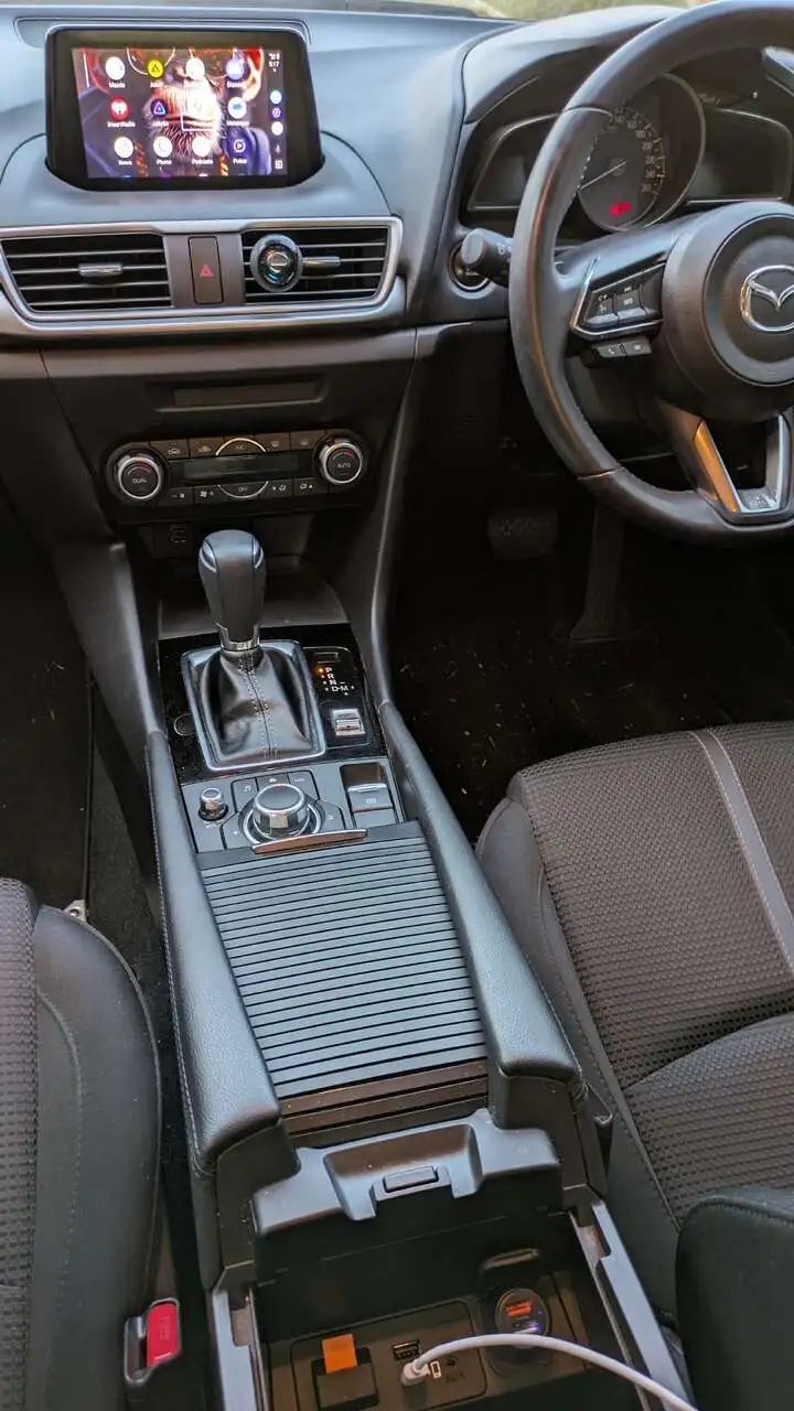

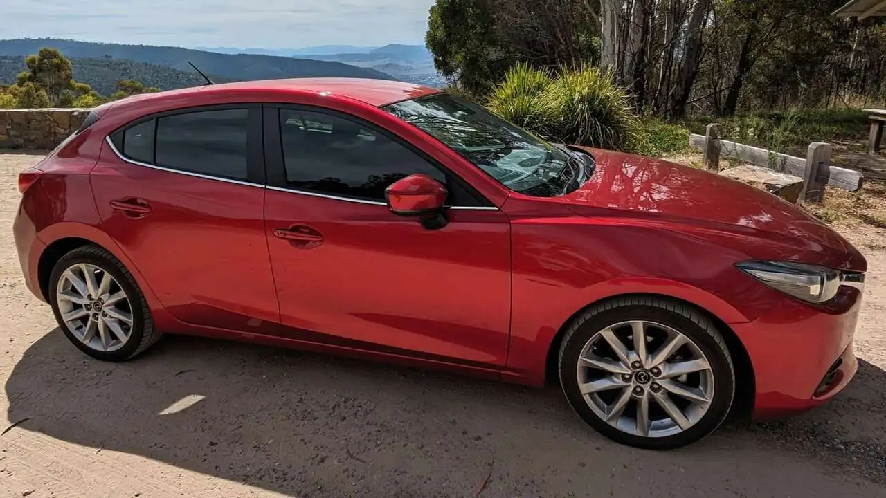

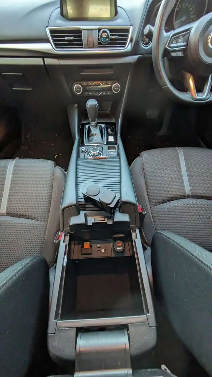

Added Apple Car Play/Andriod Auto to my recently acquired 2018 SP25. Made the job harder then needed by putting the new USB Media Hub in the back of the console where the box with fake sockets sits. I noticed some higher models have the USB Media Hub here and it makes sense to place it there to hide the wires and phone etc, they are the exact same size and clip out and in.

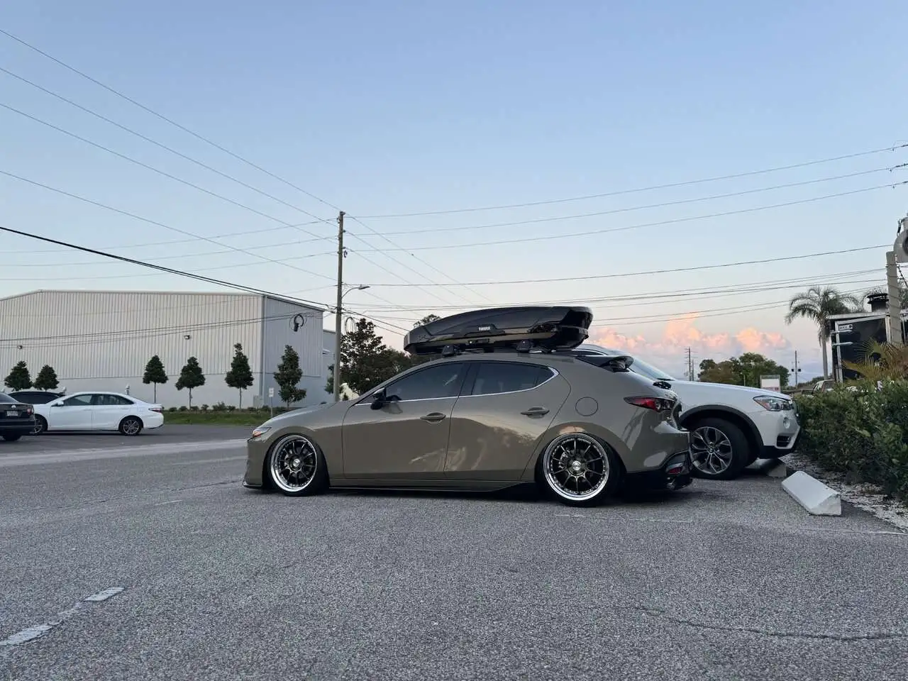

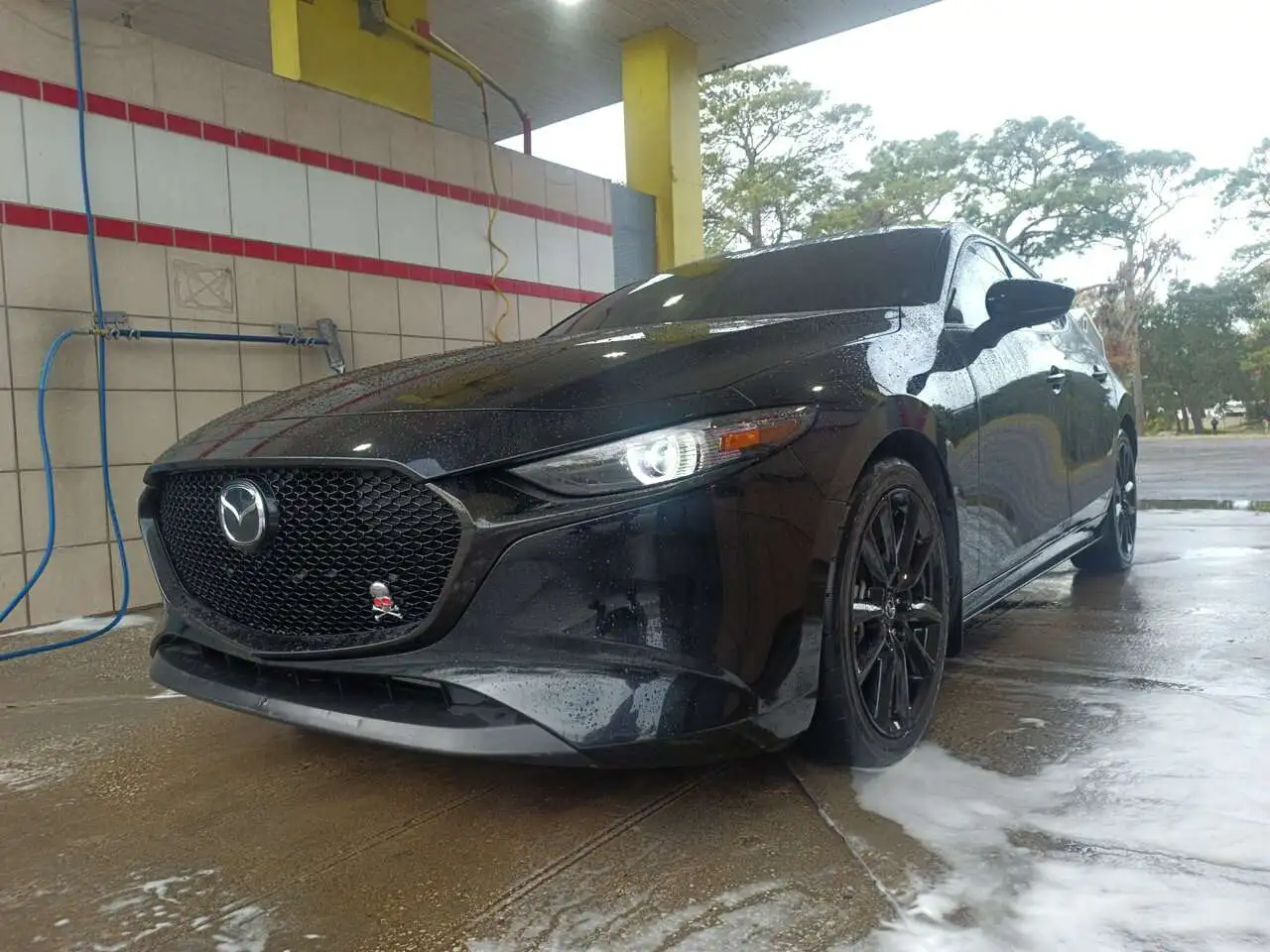

Just put new rotors and pads and did an oil change. Trust he is treated like a little king.
However sadly it is lovebug season here in florida and I have to almost wash him every day but his once a week is enough.

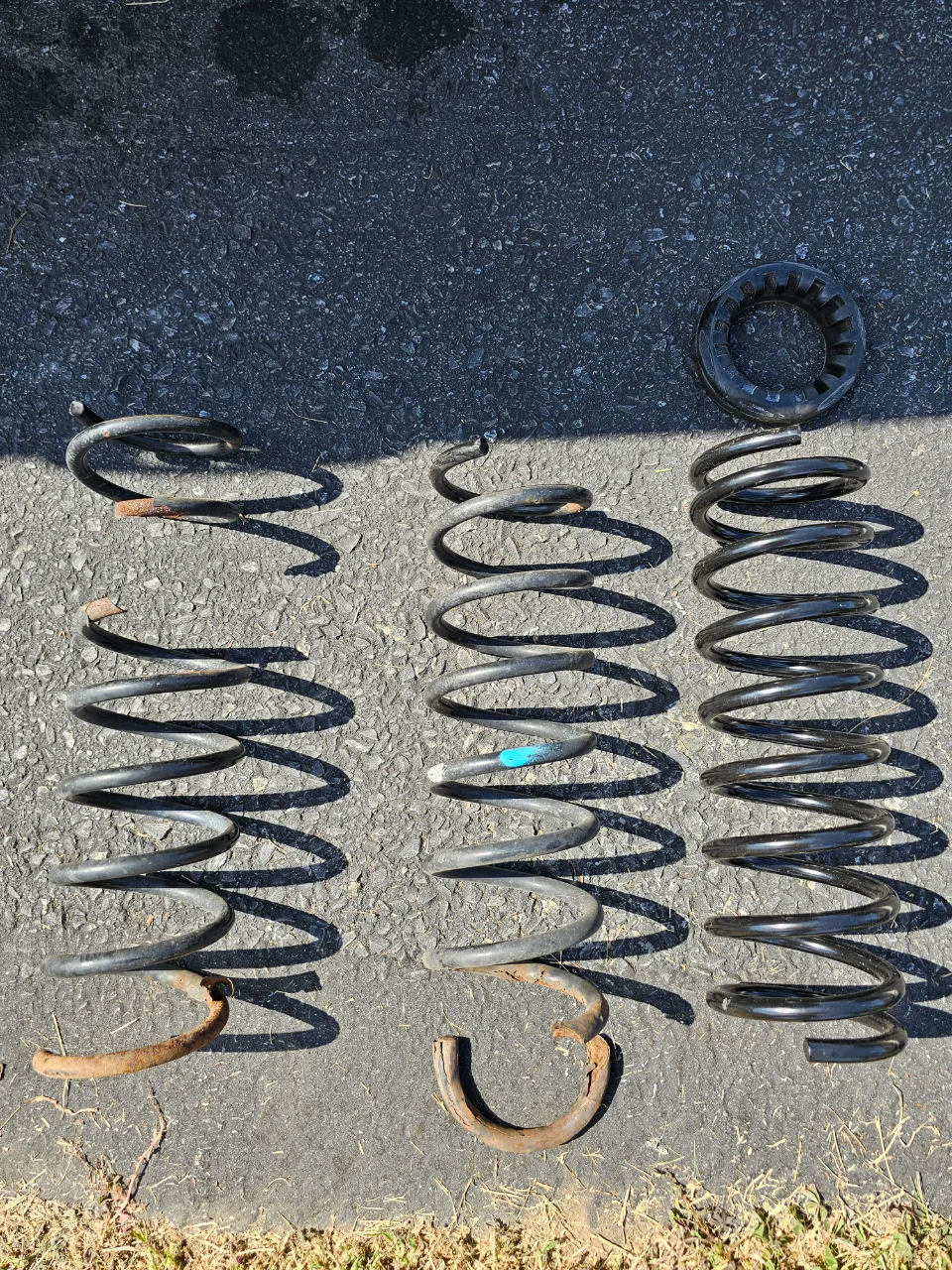

Replaced the rear springs on our sons 2008 yesterday afternoon. It failed inspection as the DS spring rusted in two. I asked him if he felt any difference in the ride or heard any noises and he said, no. 🤦🏼‍♂️ I ordered a pair of Moog springs, part# 81003, from Rock Auto for $65.49 and planned on replacing them on my next Friday off.
Given the car has 188K miles and 16 NE PA winter's, I spayed the LCA bolts and rear endlinks with some penetrating oil every night for a week. Lol
It paid off as the bolts broke free with hand tools and a little elbow grease. I thought for sure that I was going to be cutting those endlinks off.
When I popped the PS rear spring out, I found it too had broke. The bottom coil was still sitting in the perch!
Went for a drive around the neighborhood, looking for bumps and everything felt good and there were no clunking noises.
He later drove to Target and when he got home, he commented how much better the ride felt.🤪
DS on the left, PS in the middle and the new Moog on the right.

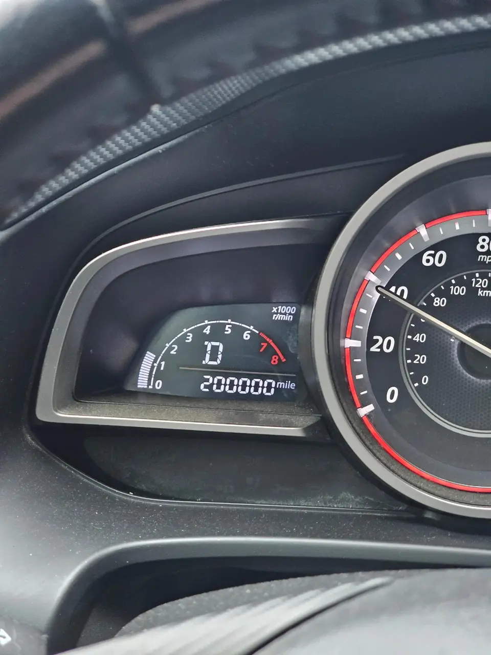

Not "mine" anymore but still in the family... My nephew turned 200k miles on my old 2015 Mazda 3 touring hatch today. Still running strong and looking good 👍
