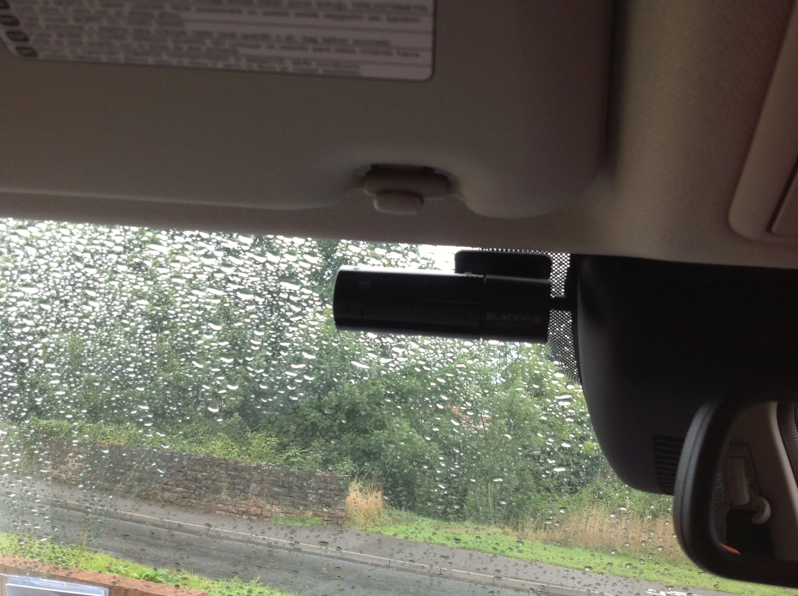

Decided to install the blackvue dash cam with the smart power adapter.Quite an easy install have it set for 24hr park record with battery voltage set for 12.3v

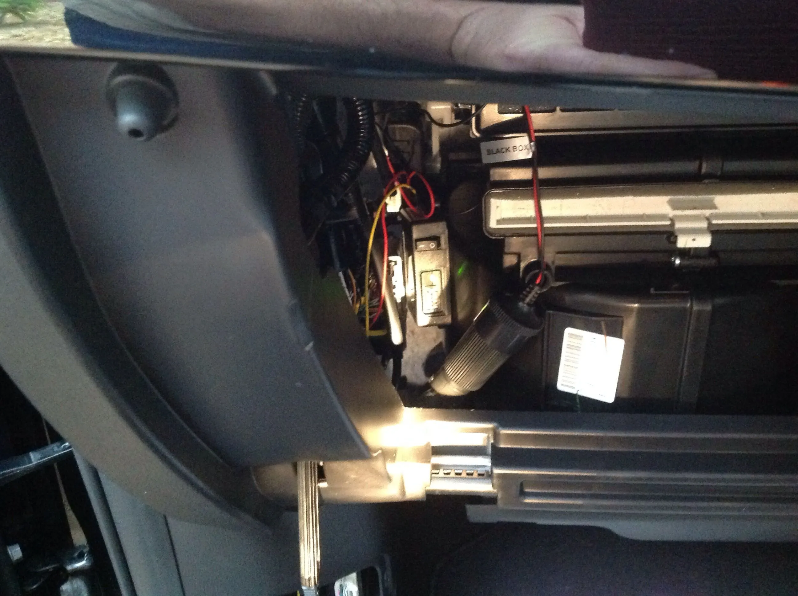

Hi Gareth45,
Can you tell us how you did the install? I am interested in setting one up on my '13 cx5.
Thanks!
Hi Raden
Fitting blackvue dash cam with smart power adapter sold separatly.
Items to remove passenger drop down glove box once opened squeeze sides and open to 180 degrees plastic counter lever to unclip on base and remove unit.

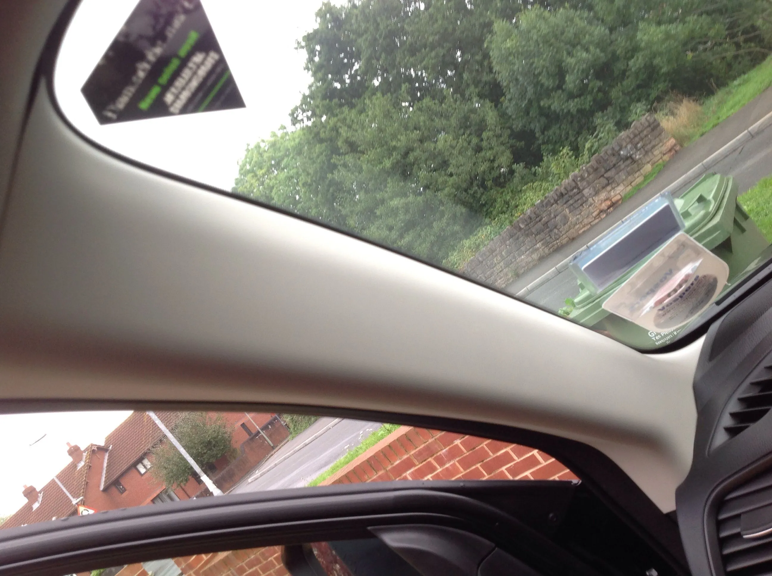

2 Remove passenger side rubber seal from around Internal door opening adjacement to A pillar also A pillar internal trim down side of front window screen this just pulls off.
3 Remove passenger side fuse cover in foot well
tools needed to assist in install
1 x side cutters
1 x multi metre / or test light for voltage test
Consumables
5 x Cable ties

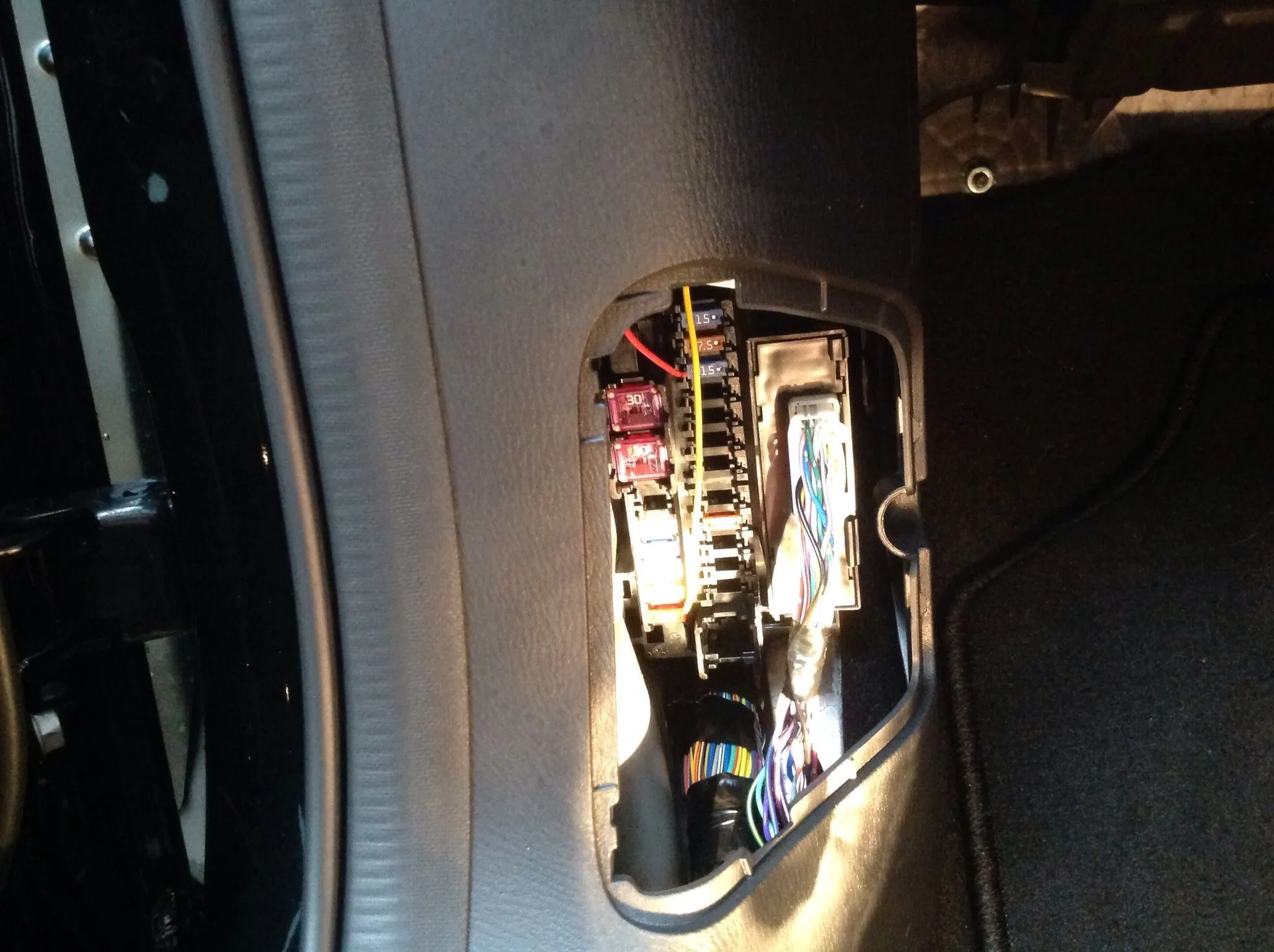

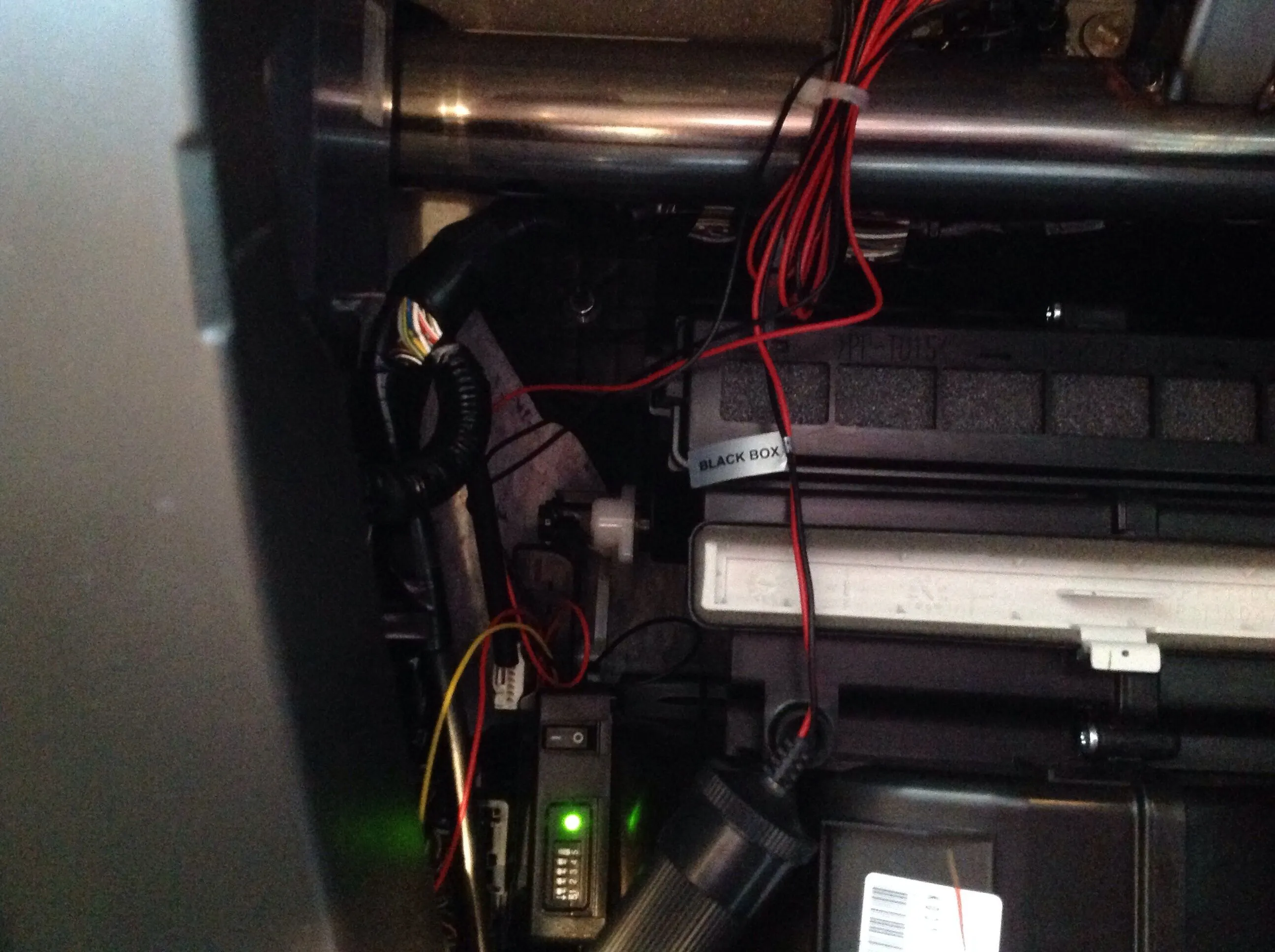

On install I did not solder or cut/ splice any wires for warranty reasons firstly you will need to find on passengers side fuse box one 12v permenant feed which is the yellow wire and one 12v ignition feed which is the red wire also earth wire is black.
I found that when removing the maxi fuse see which side is live you need to attach the wire to the opposite side of fuse simply by jamming in behind fuse when re installing fuse into fuse box so your device is now protected and vehicle wiring is original. I placed the smart power adapter that comes with sticky pad to side of heater fan housing out of way of closing glove box the smart power adapter comes with a cigar adapter this is where your camera plugs into.
I run the camera wire up the side of passenger side A pillar and under front roof liner this is flimsy so just tucks under then cable tied all wiring to dash support beam to make tidy re install trim pictures for refrence.

Hi Raden
1 x side cutters
Consumables
5 x Cable ties
Thank you for the write up and the pics. I'll give it a shot once I get the camera.

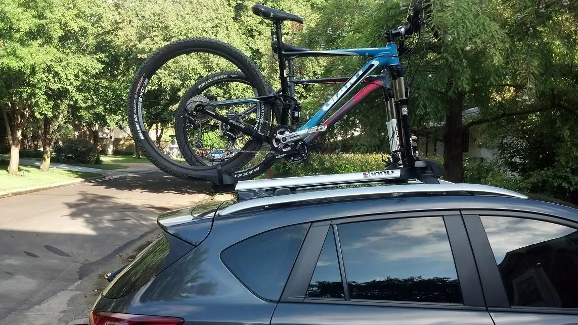

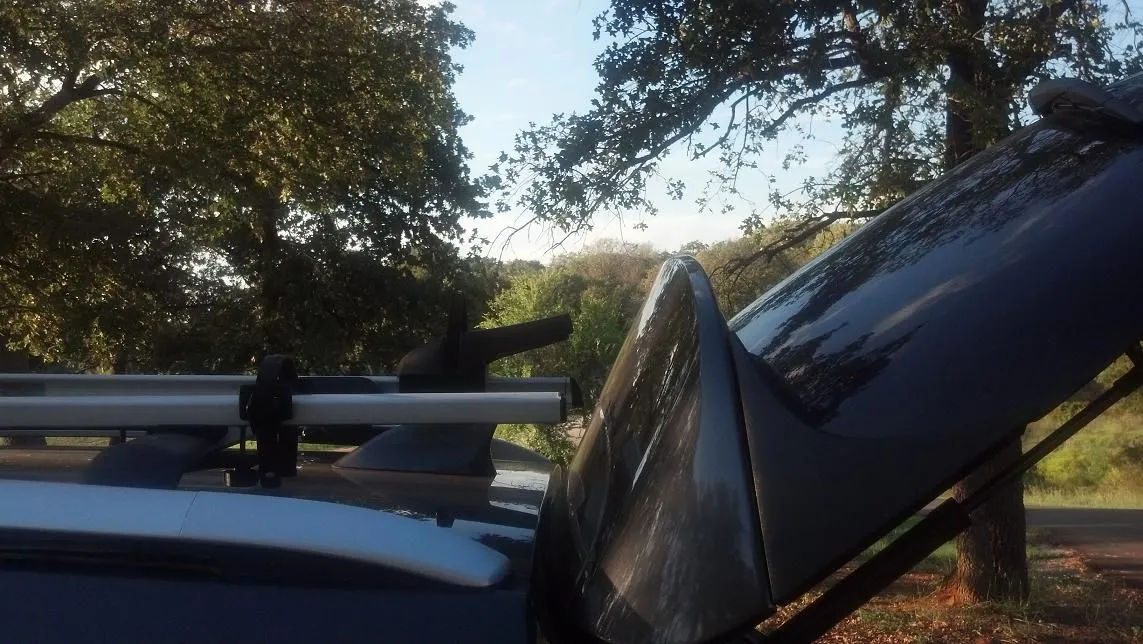

rack2.webprack1.webpCut my Inno bike racks so I could open the hatch without it hitting. I measured 43 1/2 and hacksawed away!!!!
