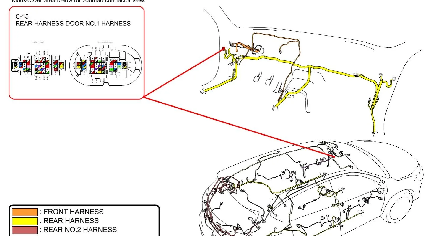

My car, about 3-4 years ago had the corroded C15 connector that the dealer fixed with replacement parts from MAZDA. Im wondering if they buggered up the wiring in the door somehow. Also my drivers window frequently forgets the auto function and I have to lower and raise it a couple of times before it remembers.

The C15 looks to be like a pretty busy harness so it's very possible something is going on there.

I suspect that when they put it all back together, they installed the power feed for the passenger windows to an always live circuit, I believe as part of the repair they had to strip and re solder some wires...it would be an easy mistake to make if you weren't being careful. I'll update next week after they've looked at it.
UPDATE: I haven't picked up the car yet, but the dealer has replicated and fixed this issue. Apparently there was short in the main wiring harness and they've repaired it ($200 later....) I wish this had happened closer to the big repair, I can't say almost 4 years later that the two are related (even though I know that they are) no way to prove it though...still at least its fixed, I was worried about battery draining or even possible fire if the electrical decided to short and melt something (I've seen it happen!) Just glad its fixed!
