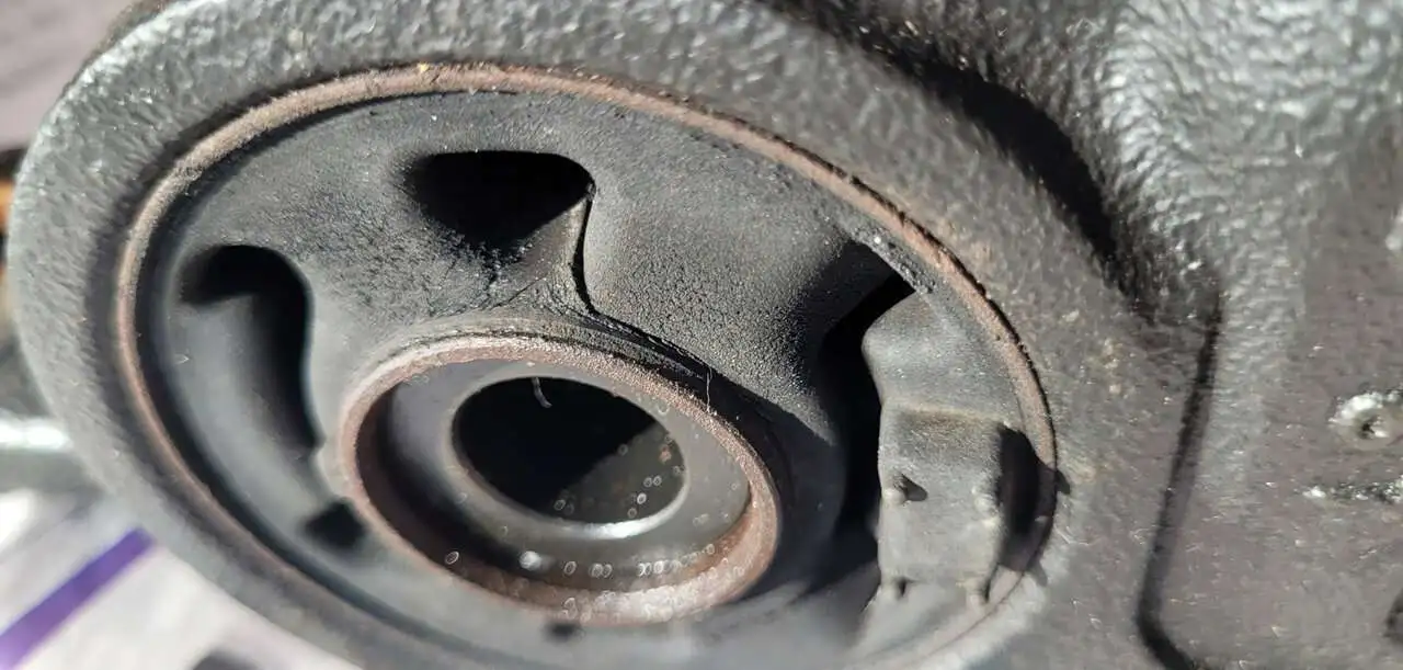

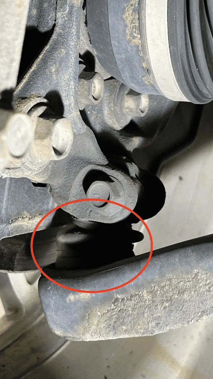

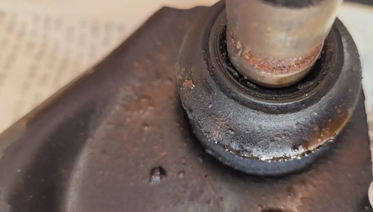

While doing my brake bleed this weekend I investigated a clunking sound coming from the front end suspension. What I found was that the passenger side ball joint has some slight movement in it and I'm assuming this is the dreaded failure a lot of people are seeing on their CX5s on the forum. The car is a 2015 GT with 97k miles.
The symptoms are:
  • Tiny movement where the LCA ball joint connects to the knuckle. You can't see it but you can feel it with your hand while someone wiggles the rotor. I've attached a pic with the area in question circled in red.
  • Clunk sound as you hit a driveway approach
  • A subtle *bump you can feel in the steering wheel turning left...maybe felt two times in one full left turn of the steering wheel
  • Sometimes an audible clunk while turning.
  • A general looseness in the front end...could be my imagination but it doesn't feel tight.

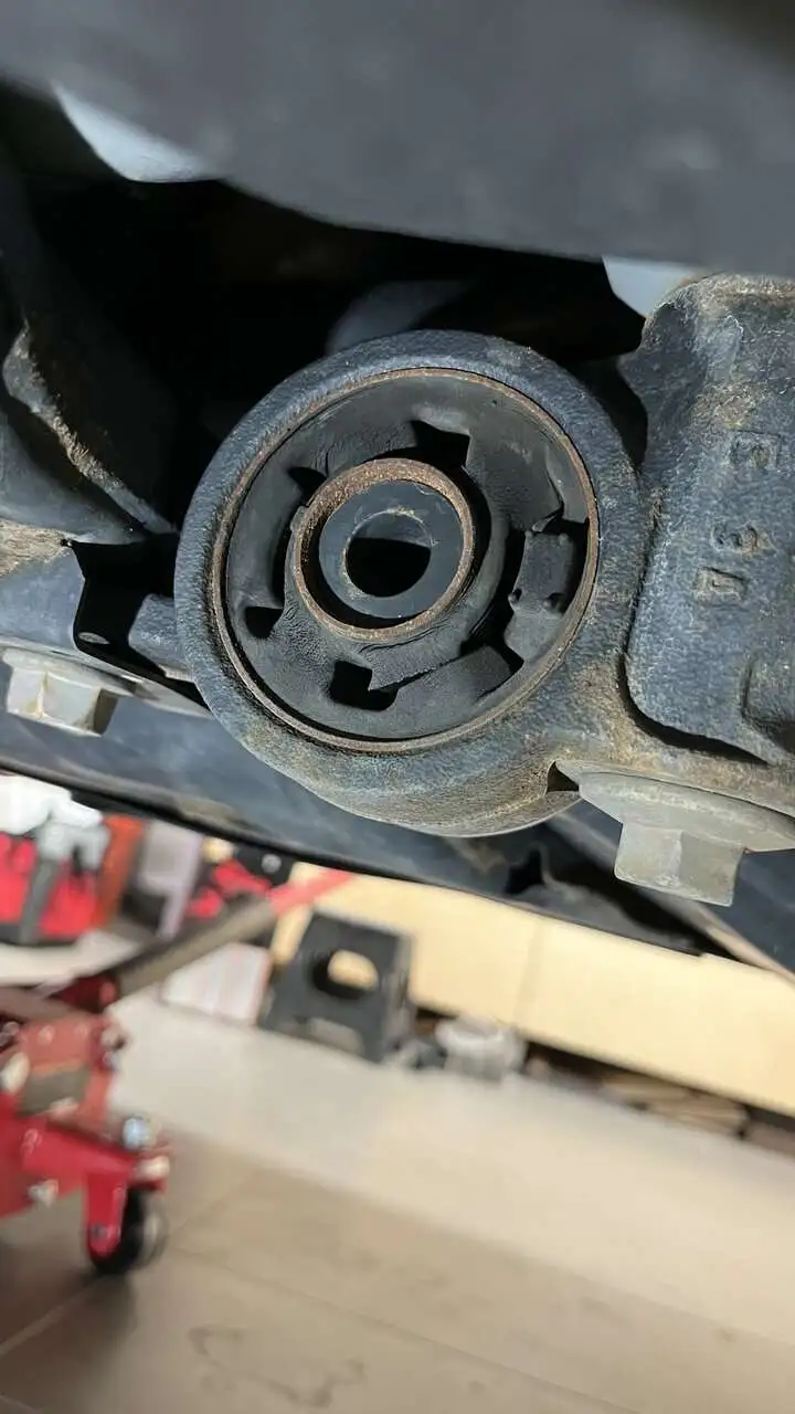

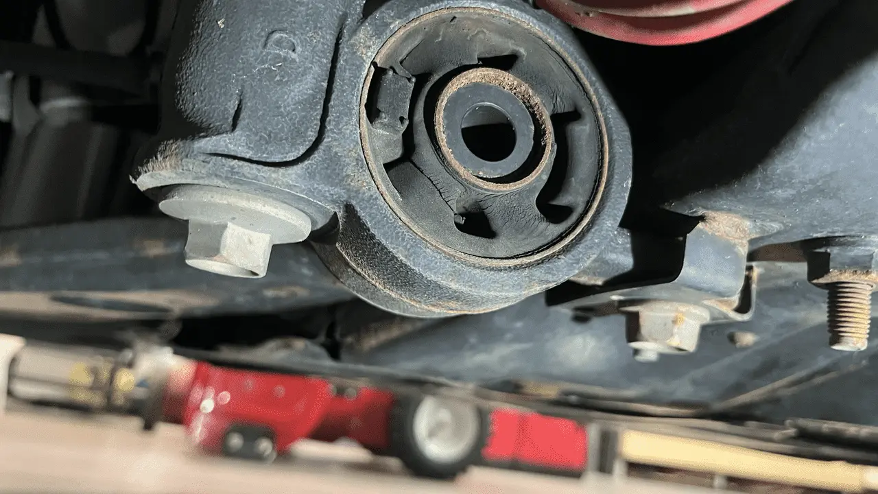

I've also noticed the bushings on the rear of both front LCAs are cracked in one spot (pic attached).

  • Are the symptoms I'm experiencing indicative of this failure?
  • Regardless of if the loose ball joint is the cause of the symptoms...I'm assuming I need to replace the passenger side LCA for safety reasons? It shouldn't have movement in it, right?
  • Since the ball joint is probably worn, is a complete LCA replacement required?
  • Based on the condition of the bushings in the pic, should I just go ahead and replace both front LCAs?

I wouldn’t worry too much on your rear control arm bushings at this time.

Checked the rear bushings on both LCAs while the car is jacked up and they're definitely split all the way through on that one "spoke" so I'm leaning towards just replacing both arms.
Also did another check of all connecting points and that clunk sound has to be coming from the passenger ball joint. If I just put a little upward pressure on the LCA right behind the ball joint with my hand and knock the 3 o'clock position of the tire (which usually triggers the clunk sound) the sound goes away. Remove my hand, it's back again. Just need to drive it around the neighborhood to verify. Found a reputable shop that quoted me $150-250 to replace...OEM parts are going to be around $400...alignment is $100.

Honestly it’s going to be costly to replace all LCAs, front and rear. With the short period of time you plan to keep this 2015 CX-5 GT, it may not worth the time and money to do them all. IMO I’d keep driving until the time you sell it or trade it in.
@yrwei52 My rear LCAs are fine. This is solely about the front LCAs. The bushings that are torn are the larger rearward positioned bushings on the FRONT. Sorry for the confusion.

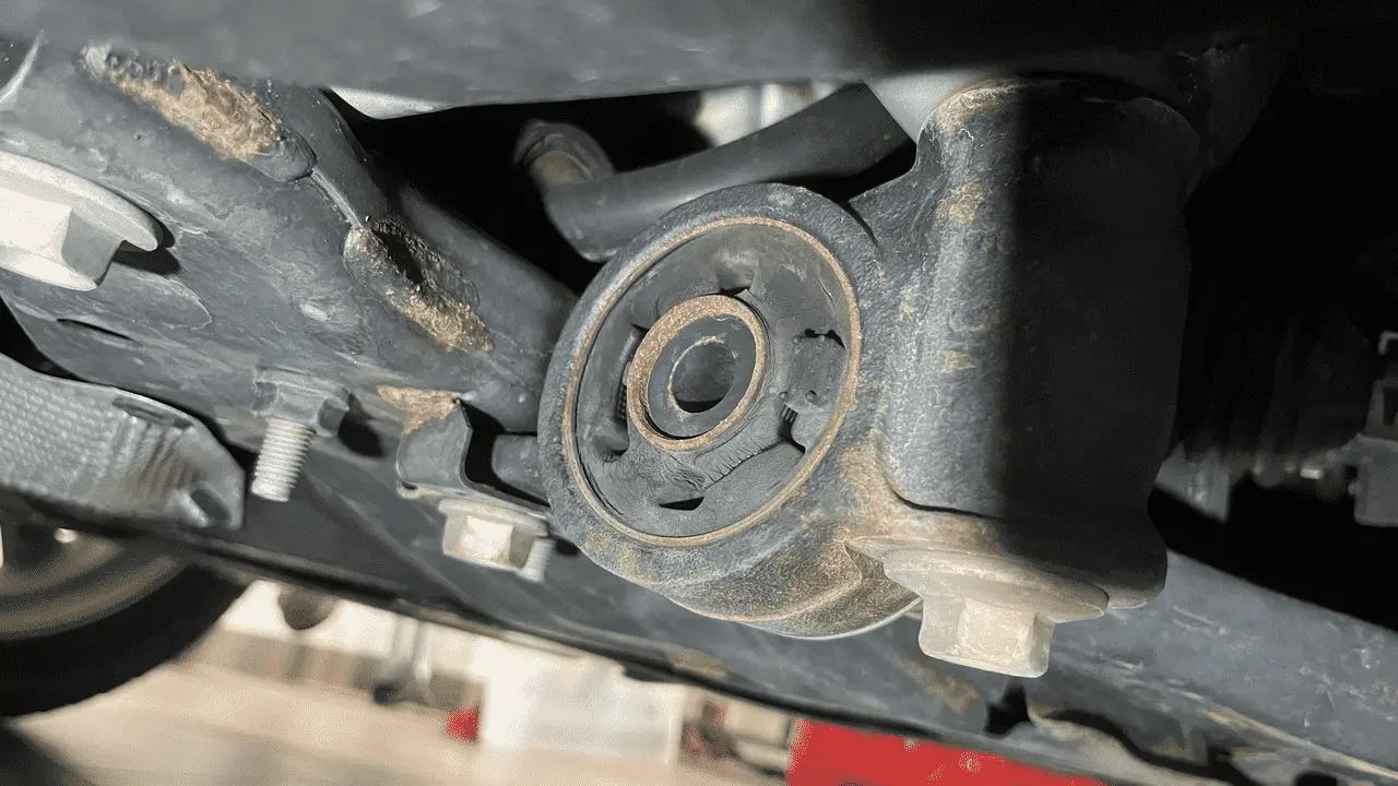

Last year my LCA bushings were torn as you describe (spoke torn completely through plus other deterioration) and I had my mechanic replace them. He's cool with customer supplied parts. There was no play in the ball joints but the boots were torn as well as the boots on the tie rod ends. Since an alignment was needed anyway, I had him replace the tie rod ends (which also had no play) also since they are cheap. This was at ~60K miles. I used OEM Mazda LCA's bought from online Mazda dealer "Mazdaswag" and quality Japanese aftermarket tie rod ends because OEM were on national back order at the time and not available.

Took it out tonight for an extensive test drive. Definitely clunking coming from the offending passenger side when I hit an approach turning right. Turning left into an approach is fine. No sound from the driver side. Has to be the ball joint.
Took a pic of my torn bushings (car was jacked up so you can see how it sheared and split

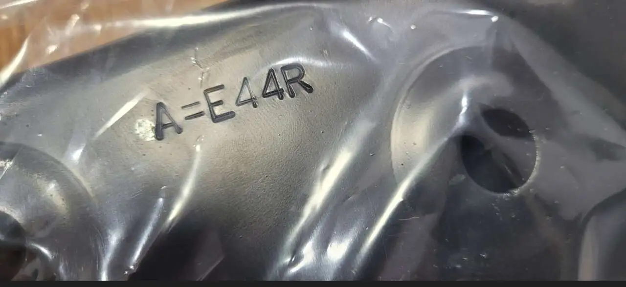

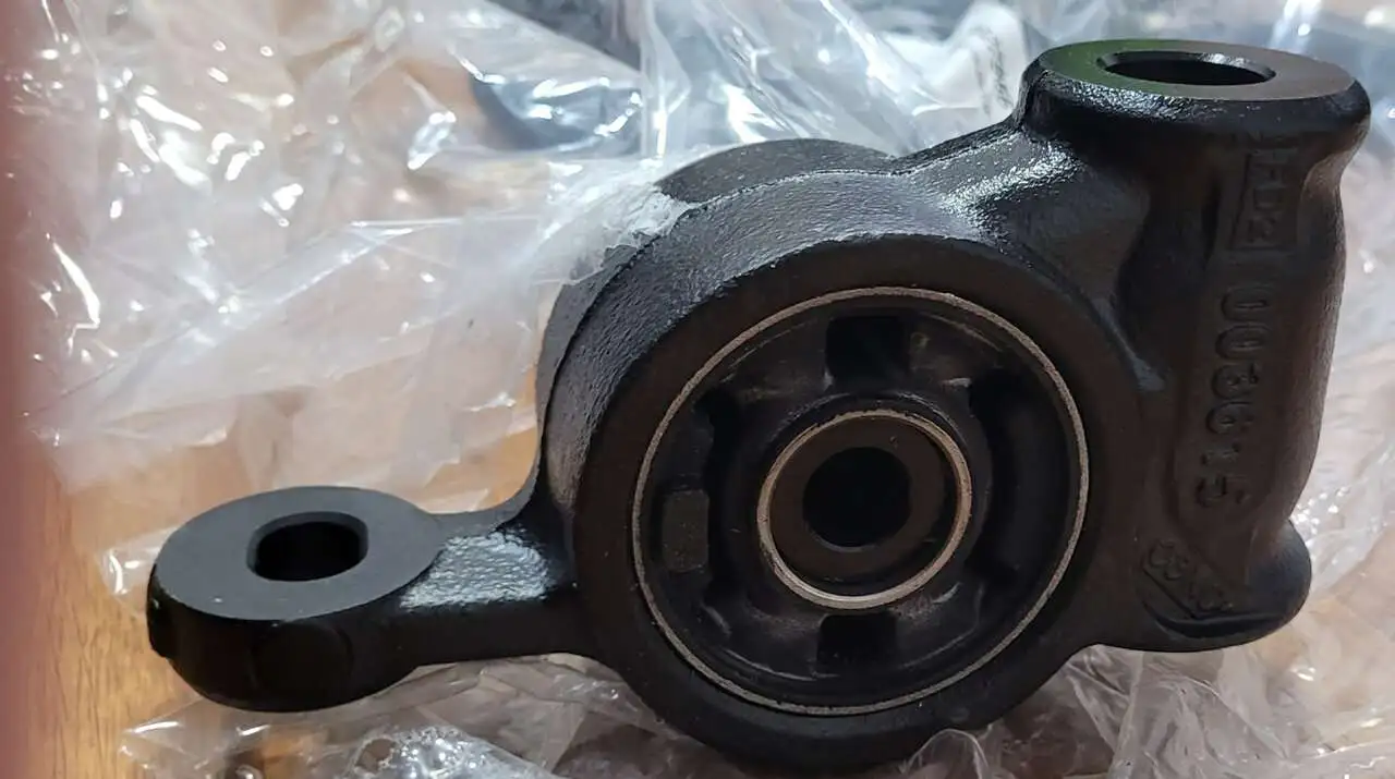

For my 2016 CX-5 with 163K miles, I got the replacement Beck Arnley LCA from Rock Auto for $110 each, I read from Amazon that the Dorman brand had fitment issues for some customers and that the Beck Arnley were a perfect fit ...strange thing is they have the Mazda p/n listed below the Beck Arnley part numbers on the boxes. I'm a newbie, so I don't know if that is industry standard to list OEM p/n on aftermarket parts. So, maybe I'm making a big deal out of nothing but just strange to see Mazda's p/n on the Beck Arnley boxes
Mazda p/n KD35-34-350S Left Lower Control Arm
Mazda p/n KD35-34-300S Right Lower Control Arm
Upon closer inspection, the bushing looks exactly the same as OEM, there is a stamp "A=E44R"
so not sure if Beck Arnley is the OEM supplier but it looks very close to be OEM, I just can't confirm 100%. just sharing and trying to help fellow members save a couple of hundred buck, OEM are like $200 a piece or $400 total...

so yeah, my 2016 CX-5 is up to 163,000 miles. I had local shop replace both LCA and outer tie rods. both LCA rubber bushings were cracked and broken, the LCA ball joint was in bad shape. The outer tie rod rubber were both cracked. This was expected at 163K. I just got it done because I didn't want to deal with ball joint failures while driving.
BTW, no fitment issues using the Beck Arnley LCA from Rock Auto for $110 each (part numbers 102-7956 and 102-7955), they fit perfectly like OEM, so save a couple of hundred dollars if you buy from Rock Auto vs OEM.
