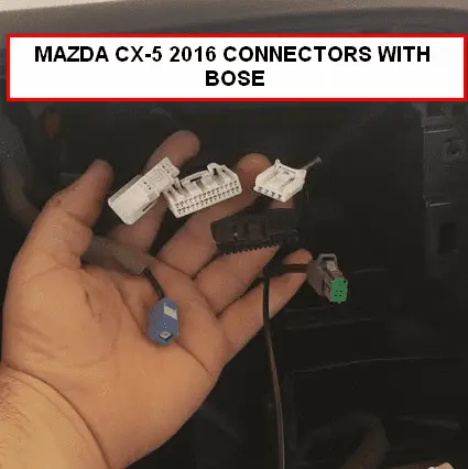

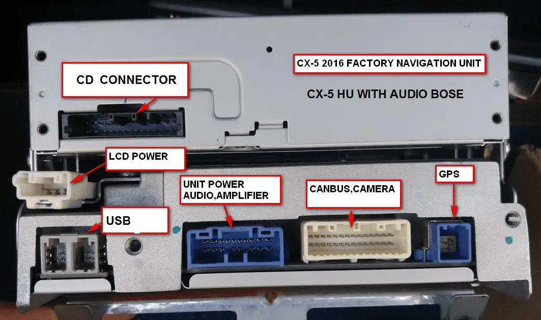

i have cx-5 2016 with infotainment system with bose audio i just want to install android navigation HEAD UNIT i recently bought one from china 10.2 inch android navigation unit
when i remove the factory HU from my CX-5 i was surprised that the connectors are different and wont fit i come to find out that these Chinese HU are made especially for previous models like 20150.2014 etc...
now i need your help very urgent to figure out how to fit this aftermarket android unit to cx-5 2016 with audio Bose
i will attach all pictures from my cx-5 2016 HU and connectors and aftermarket android unit and connectors
kindly help

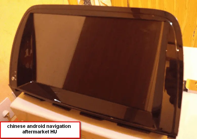

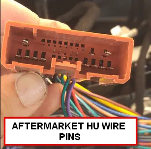

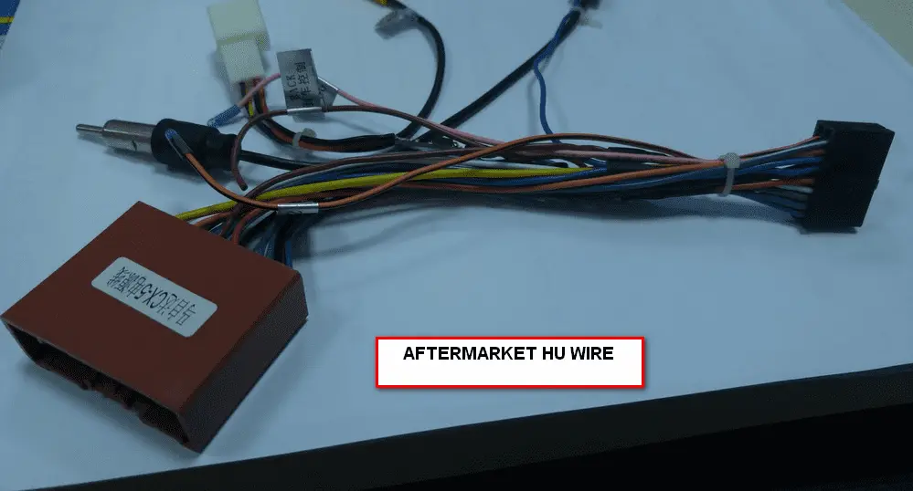

Moxified is correct. Adding an amp with subwoofer and replacing dash speakers are the popular mods for a fully integrated 2016 CX-5 Bose system, but we haven't seen anyone who had replaced Bose head unit with an aftermarket one! From the wire harness and connectors of your aftermarket head unit it seems to be designed for replacing CX-5 non-Bose system. If I were you, I'd try to sell this incompatible aftermarket head unit on eBay to recoup some cost back!
I would not install that android radio. I have used one before in a Kia forte. While they do have some nice features. They lack quality. Also they are often vehicle specific down to the trim level. For instance, the one I installed in my Forte was specifically for the ex trim level without navigation. Would not fit cars that have navigation. In this case, I'm guessing the harness provided doesn't match up because it's probably for a non bose cx5. Not to mention it says it's for a different year model. I would try to return it. And if you can't, sell it.
your are right its for none bose model but its nice and has a lot of features like wifi and more i am still looking for a solution and i hope i find it.

Well, it's easy to calculate how much the car consumes just by putting the fuel into it. I think the door chimes and others are bit futile anyway, here is the way of this connector, has anyone dig up the audio & more connector yet? I have one jumper cable for this and i can debug it. China radio came with canbus decoder, so i assume when i wire it up to the Canbus.. then the settings might work what are required to work.
I bought this radio for my Dad because MZD doesn't seem to be useful system at all. He has a 2016 mazda cx-5, item said this would fit to 2016. It fits very nice to it's place and seller plays he doesn't speak or understand english anymore.. So returning the item to the china ain't so easy. This radio came with a new joystick and it's connected to the unit via own connector.
