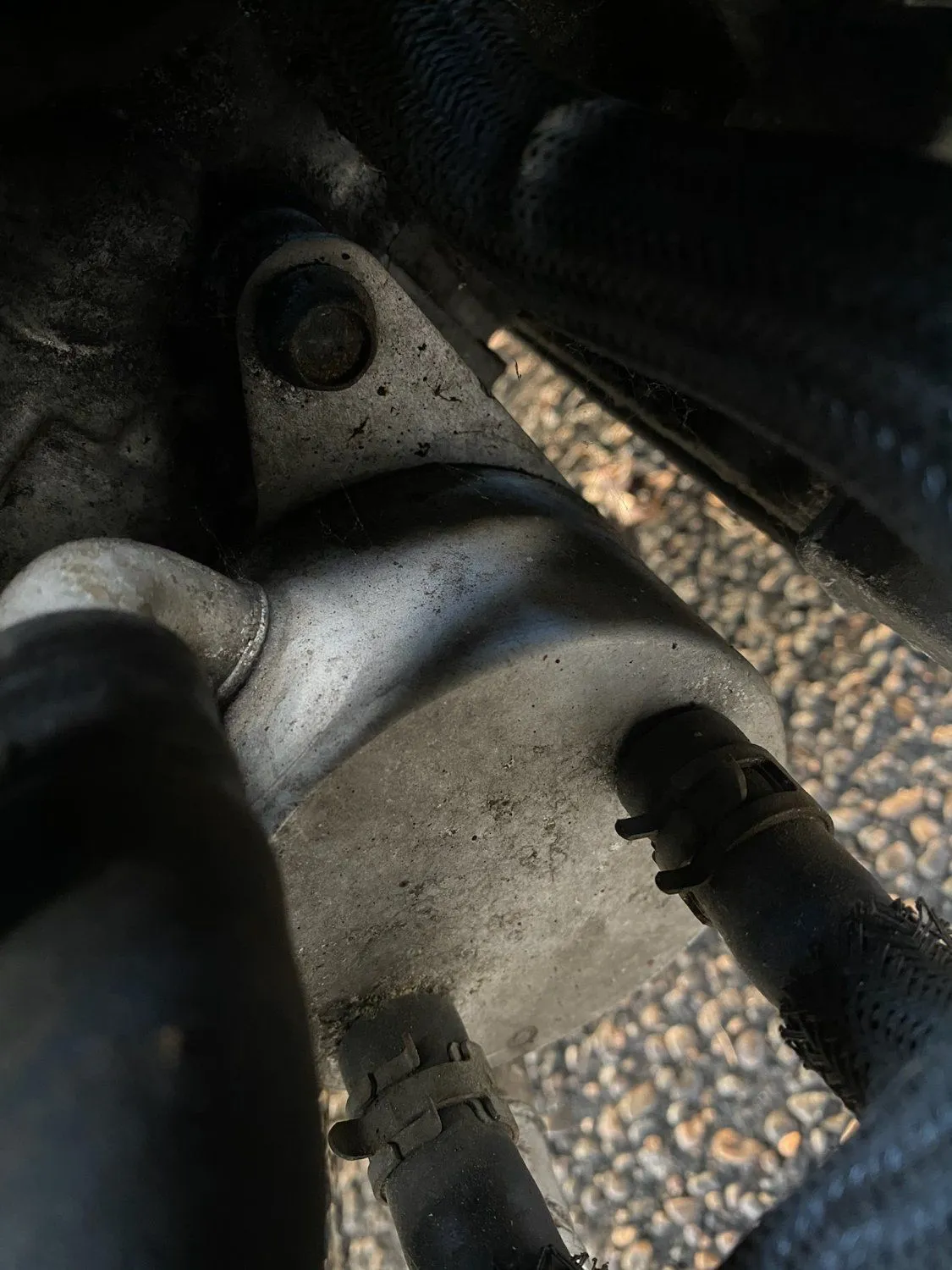

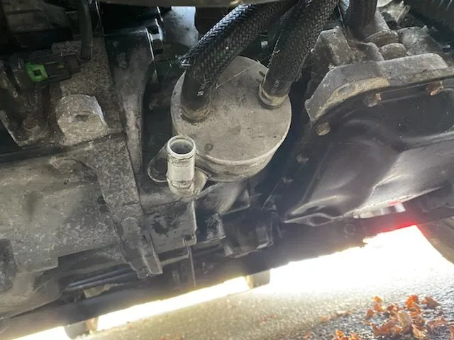

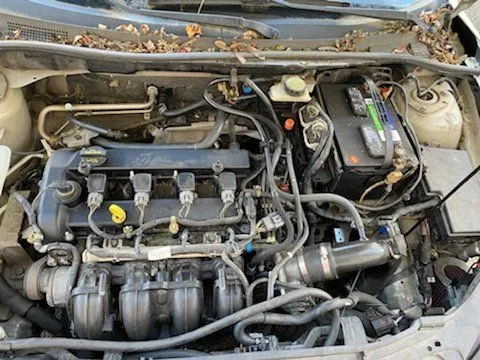

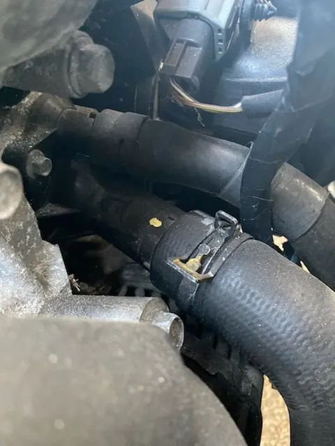

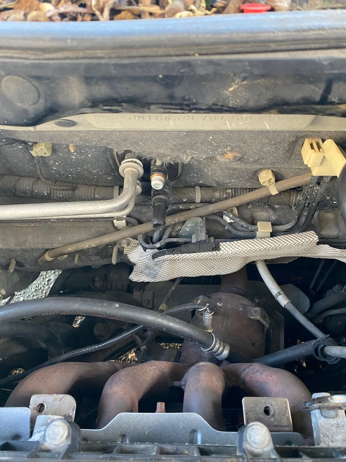

Sorry for the gap on posting this, here are the pics of my almost finished 56K 2.0L engine swap.
To finally the swap there only like 3-4 minor things left. I have checked my chiltons manual, mazda 3 service manul and several others and as far hose route diagrams other than basic upper and lower radiator hoses there arnt any. The hoses in question are:
1. I need to reconnect the heater core hoses, one goes somewhere into the back the block somewhere I think. The other I have no idea which brings me to number 2.
2. If you look at the transmission diagram-see pic. The lil silver round, 4 hose metal housing is included - see pics. That-6 diagram says the top hose goes to the heater, the bottom goes to thermostat. Problem is on mine is, the top hose it currently connected to the thermostat- see pics. While the bottom hose is missing completely.
-Did the mobile mechanic just connect it backwards and mabey I should unhook it and reconnect it to the bottom like the diagram? Does your bottom hose run right to thermostat or left to heater basically. That leaves the other "to heater" hose connection listed in diagram, where does it route to and connect? So prob 1-2 are somehow related, which brings me to the last and easy prob.

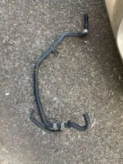

3. The t-shaped hose pictured on ground I have no idea where it goes -see pics- is listed on the internet as a mazda 3 heater hose. Also the lil hose in the middle has a plastic black nipple broken off in it. First where does the hose connect to everything and are prob 1-3 all connected in someway?
Please help cuz finding info on routing diagram stuff related to this is almost non existant, only vaccume hoses and upper and lower radiator hoses are covered. Thanks community
