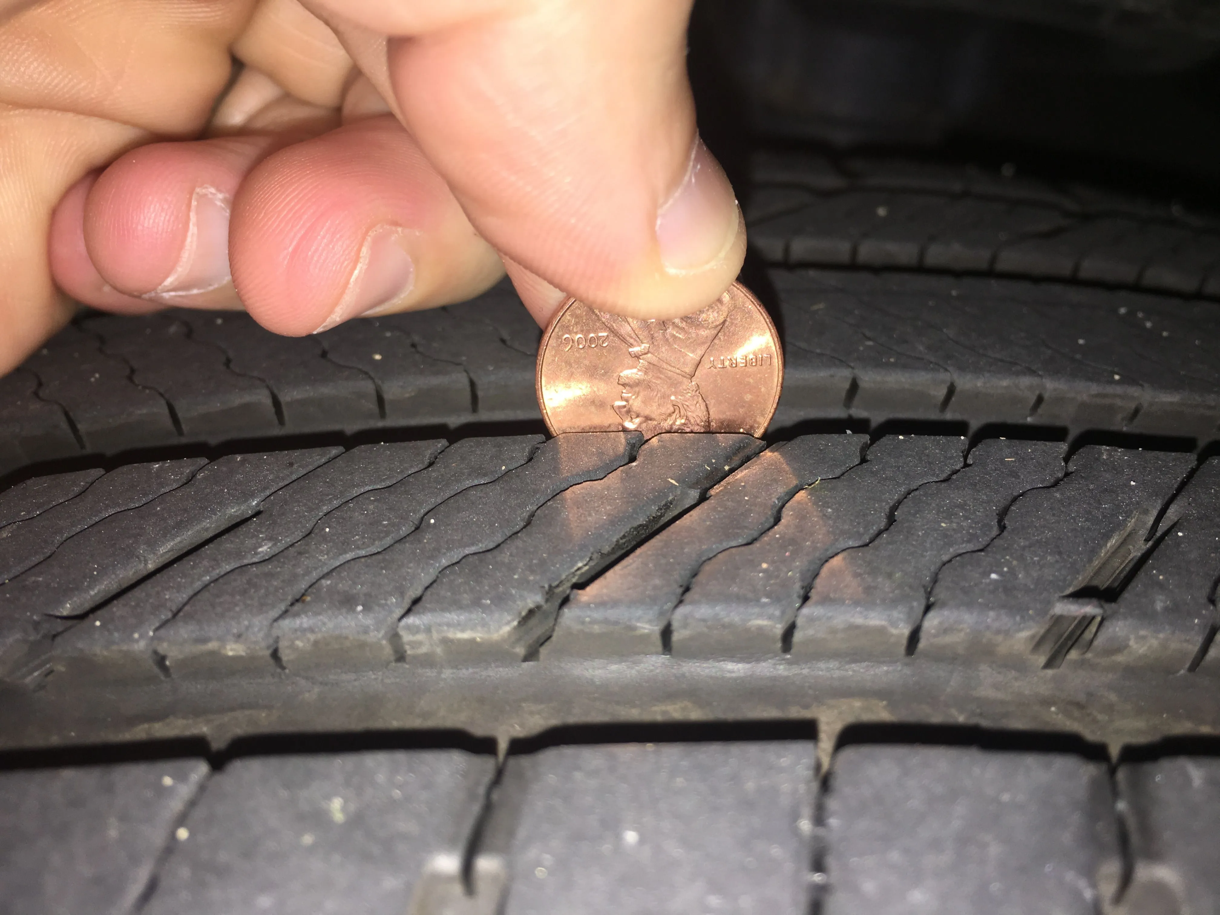

So far, so good - I have around 20k miles on them now and they still have a decent amount of tread left - way more then the Toyo's at 20k. Performance wise they seem fine - it's my wife's primary car but the few times I've used them in the snow they seemed to do well - no noise issues either.
i just ordered a set from Costco at 34k miles....how do you like the Michelins? any difference than when your Toyo OEMs were new?
