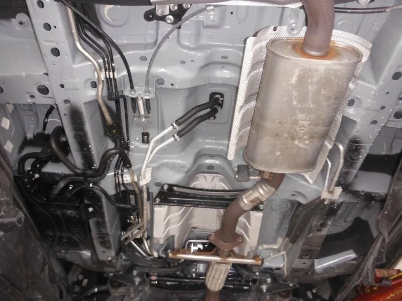

Does anyone know of any issues with rust around the muffler on '13-'15 models? Reason I ask is the attached picture on a car I'm considering purchasing.

Unfortunately my phone will not allow me to view the image. The exhaust in these are made out of stainless steel, so while there may be some surface rust, there should be any rust through for many years,if ever. If you feel it is questionable have a mechanic look at it and get their opinion.

Thanks for the response. That makes sense about the actual muffler being stainless steel, so I guess my concern would be the actual pipe going into and out of the muffler. It looks like the couplings there have the most significant amount of rust.
Definitely will have any car pre-purchase inspected before buying, just curious if this was a known issue that others had encountered.

I have a 2010 and the exhaust piping looks similar to that. No exhaust leaks yet.
