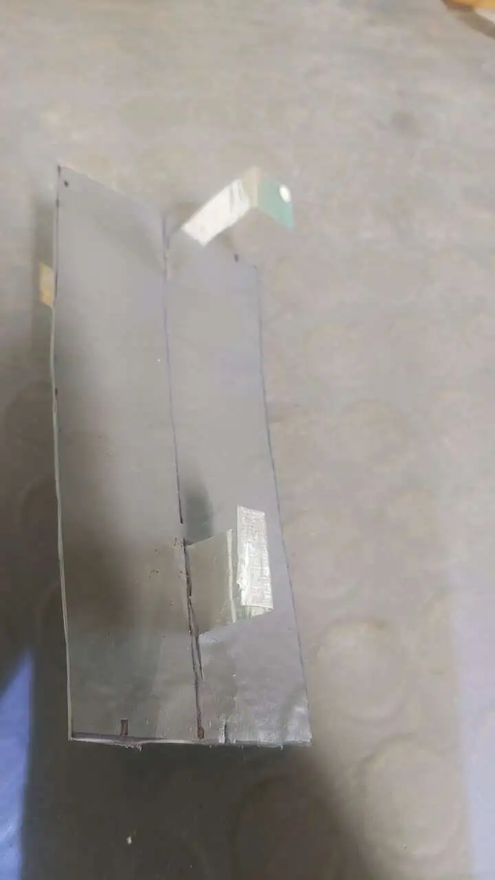

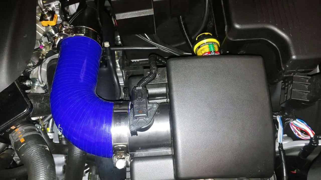

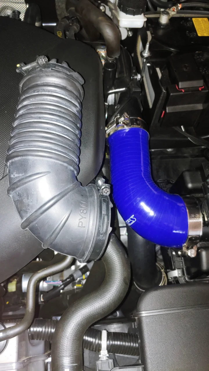

I made a turning vane in the tight radius elbow coming out of the air filter box on my 2024 CX5 Turbo. This elbow is smooth bore and discharges to a ribbed straight section. The next section is plastic pipe that transitions on the outboard side to a oval tube.

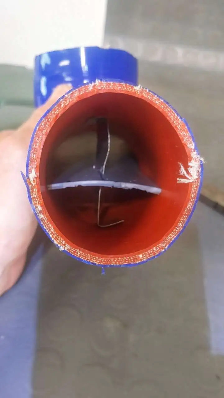

I had some scrap flooring and flashing material and made a rough turning vane. I went for a drive. My butt dyno said yes this works. I didn't say anything to my wife about this mod. She went about her daily driving around town. That night at dinner she casually mentioned the car had a lot more pick up. That confirmed my butt dyno "data".

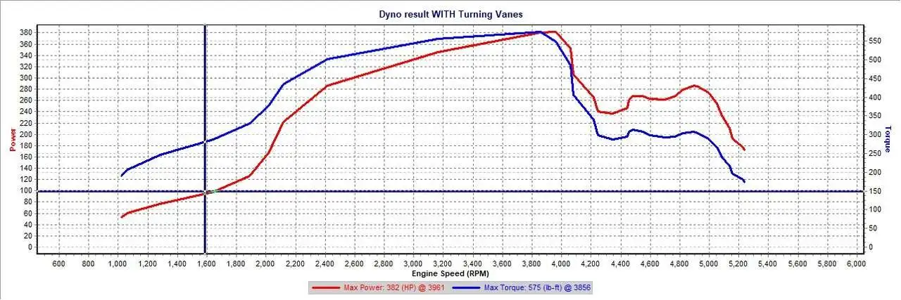

I made a somewhat more refined TV and logged per my tuners instructions 2 WOT pulls using MazdaEdit. Using the Dyno function I compared this to a previous log. I go to the same spot to log WOT every time on a low traffic highway.

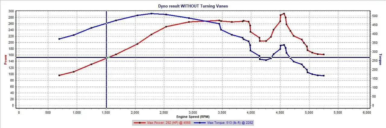

Here are the dyno logs. The HP and Torque numbers seem to be optimistic. This is like other Hp and Torque calculators I've used. It was interesting that peak torque was higher at a higher RPM with the TV and HP was higher at lower RPM without the TV.
I need to go back and log from a stop through 3rd gear with and without a TV to get a fair and accurate calculated dyno.
I like how much smoother the curves are WITH the TV. It appears our FE has improved as well.

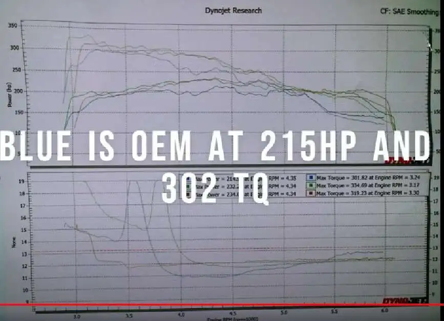

Here is what Mazda published. Without TVs log dyno mirrors this more closely than with the TV. This confirms the TV impacted the performance.

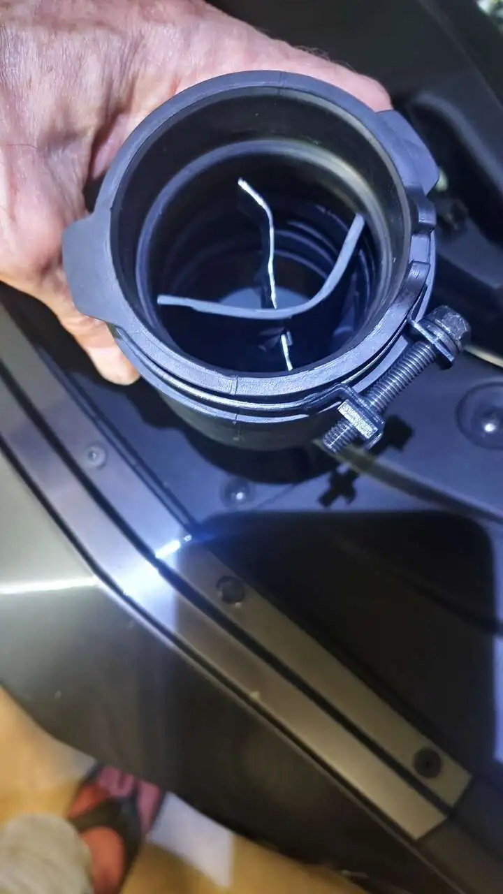

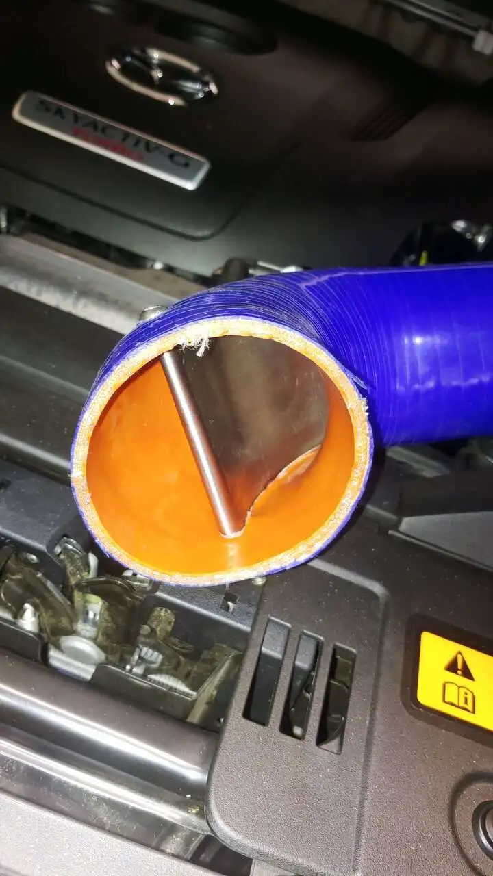

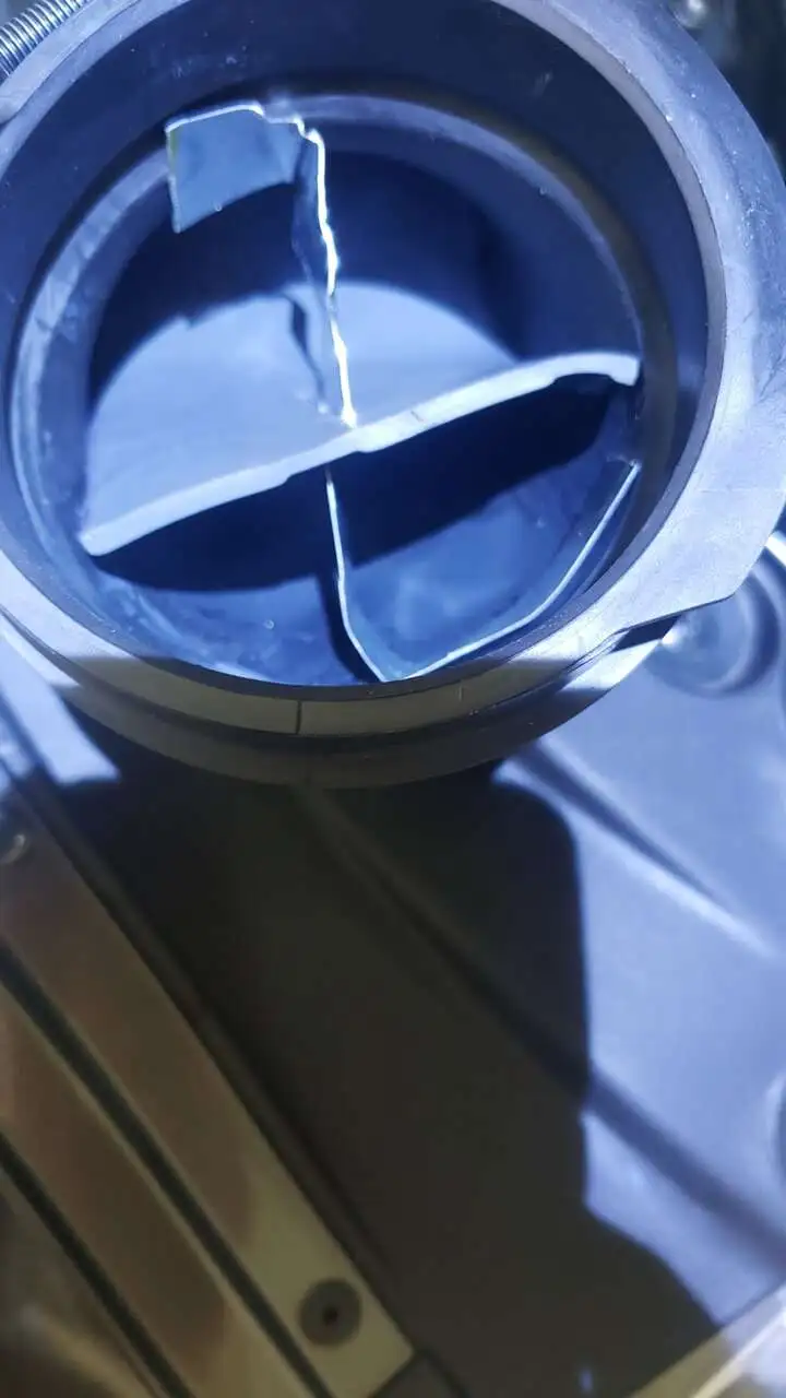

Here is what my first shot at a turning vane looks like in the elbow.
Using some scrap flooring and roof flashing.
It is staying in place, SO FAR. I carried around tools to remove it if it bloced the air flow.
I trust it to stay put to let my wife and grand kids go out at night. So far she has returned!
Here is the outlet. I need to trim the top piece a bit more.
Here is the inlet to the elbow.
Obviously there is a change but the numbers are wild. Which run came first? Same day?
There is apparently less power at "driving around town" RPMs.
There is something going on at 4,000 RPM on both runs. Power nosedives. I think the 4,500 RPM thing is an anomaly.

The logs are about a week apart BUT on the same stretch of road.
Other logs show the same anomaly. I have sent these logs to my tuner. If we discount the HP at 4500 RPM. TV is a clear winner. The tune closes the waste gate at 4k, thank you very much Mazda. MazdaEdit is missing some key tables for REAL tuning. Yet it has helped with power and FE...
Before I spend more time refining this I wanted to "see" some results vs. our butt dynos.
I'm encouraged the TV refined the curve and has more area under the curve. It runs much smoother as the curves suggest. The TV is putting more than half the air volume through the inside and avoiding two flow killers. The ribs in the straight section and the transition in the plastic TIP.
I'm sure you can agree, numbers don't lie. I hope this post will encourage another owner to build

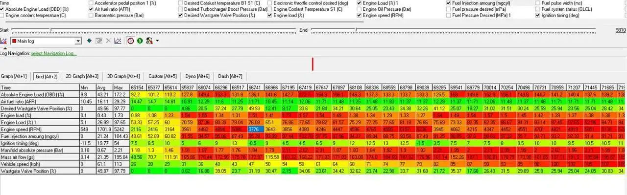

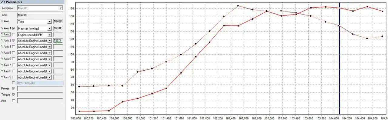

Here is a screen shot of one of the tables I use to get the comparison.

UPDATE: I found a 2.5 x 3.5 reducer 90 degree elbow and ordered this AM. Over on the other platform, we found that TVs help smooth bore fittings. I'll refine the TV in the smooth bore. I've not liked the ribbed straight section of this fitting from day one.

I got the HPS 2.5 to 3.25 reducing elbow today. Vivid Racing had a good price and quick ship. I got the clamps off of Amazon. I trimmed both ends to fit and I stalled. Without the TV it was better than the OEM without a TV.
I moved the TV to the smooth bore 90 elbow and went for a spin. Low end torque jumped! Traction control light came on in 1st gear wot and it took off.
It makes sense a smooth bore is better. I was pleased with how much better.

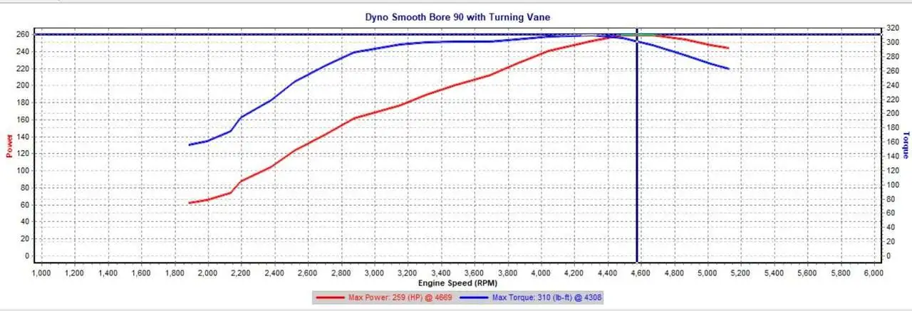

Here is the curve. HP and torque that is close to DRTuned dyno results. DRT got 215 WHEEL HP, using 0.82 to convert to Flywheel HP is 262 HP.

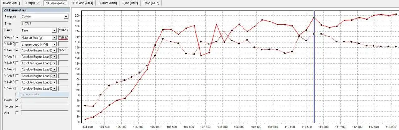

Comparing air volume from the MAF senser and calculated % engine load is another valuable tool to compare one elbow to the other.
Here is shot of MAF and % engine load at 4669 RPM. If we use MAF value X 1.25 it comes up to 201 HP. This is more inline HP of this engine on a 95F day. Using MAF and engine load is a better comparison between the OEM elbow and the smooth bore/TV elbow.
Looking at DRTuned published dyno of a 2.5 turbo, it made 215 WHEEL HP or about 260 HP. The max MAF was 195 g/s or 244 HP. So things are not lining up perfect. I'm mostly interested in measuring the difference between the OEM elbow and the smooth bore/TV.

Here is DRTuned dyno. Note this car has several bolt on mods to improve HP.

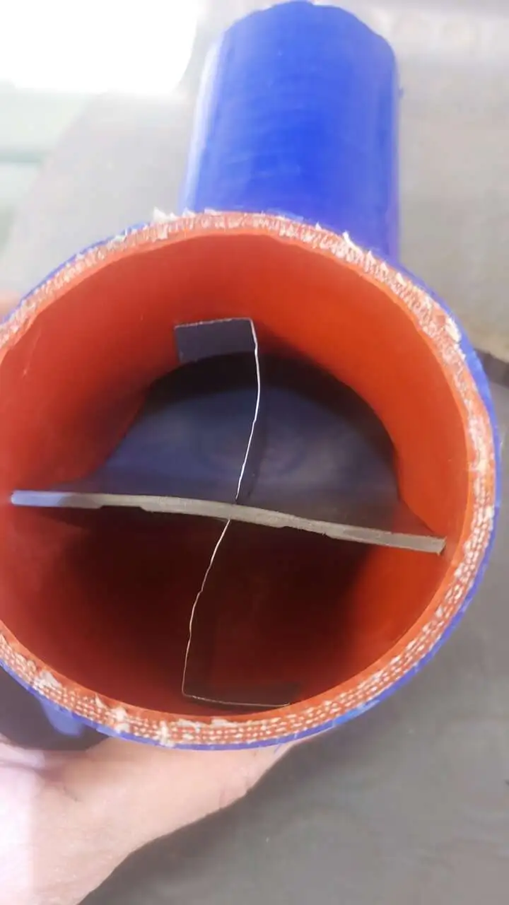

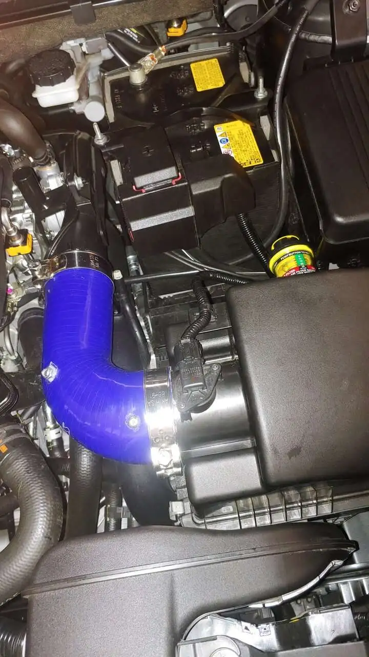

Here are some pics of the smooth bore with the turning vane installed.

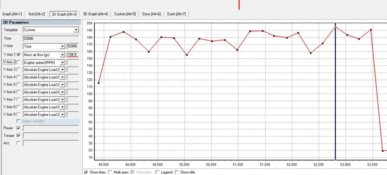

Here is todays best pull, MAF peaked at 195 g/s. Using EVO X HP to MAF ratio, the 2.5l T made 251 flywheel HP at 4367 RPM. That would line up with DRT's modified 2.5T, SAE dyno number, 215 Wheel HP, 262 Flywheel SAE HP.
AND we haven't brought up timing or KC! I'm going these variables out for now until I have a better understanding how Skyactive controls timing and KC....
Thanks for a comparison MAF and HP. That helps!
Today's test was sort of a bust. The TV twisted inside the elbow restricting flow. I removed it and made a WOT with the smooth bore elbow.

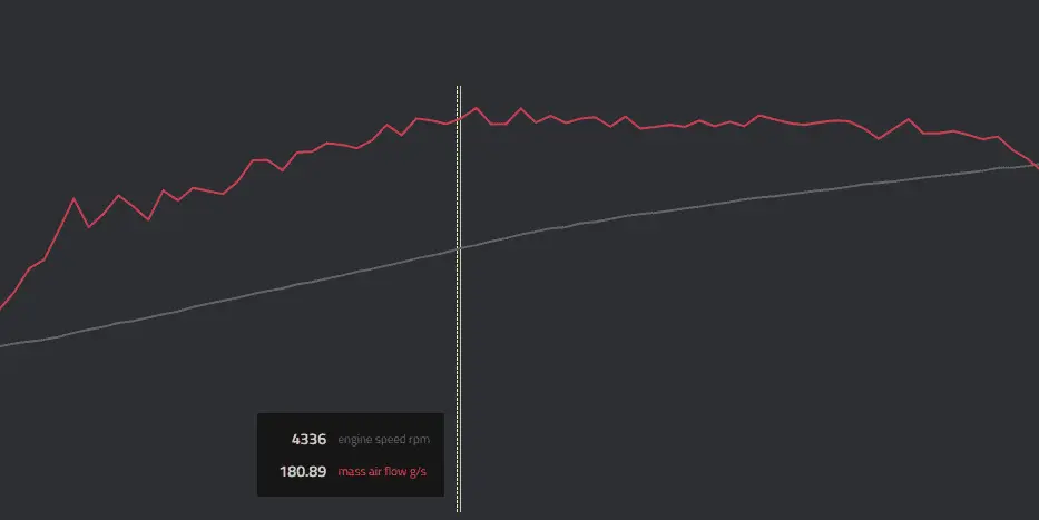

Smooth Bore Test:
At 4300 RPM in 3rd gear it made 196.82 g/s according to the MAF sensor. If we use the factor from the EVO, post 11, it made 253 HP or use 1.25 x MAF = 246 HP. The solid red line is MAF and dotted red % engine load. Above 4500 RPM engine load falls off. This is where the ECU opens the waste gate and reduces boost pressure.

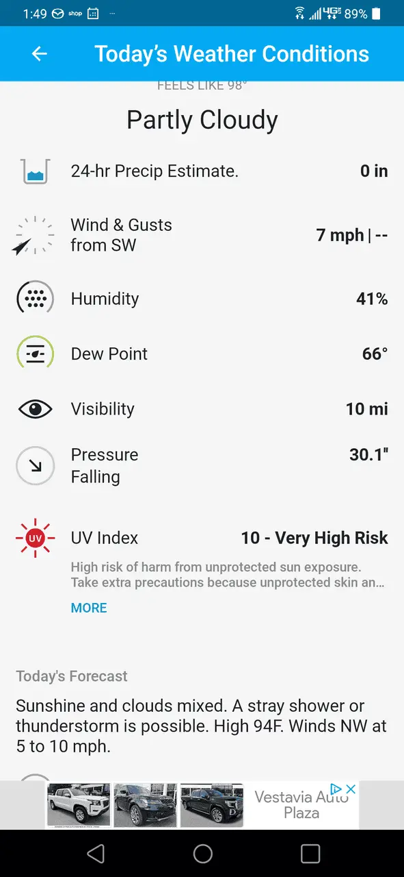

It was a hot, 94F, 40% , 30. Hg pressure after noon. I'm about 550' above sea level for those who want to convert to SAE HP.
I might fashion a turning vane from sheet metal this week and try it again. I have enough data to compare.

That long run of material will induce a lot of drag...
Good point. I need to learn how to suport the TV in the 90 in 2 places.
I'm looking at making a metal TV and supporting it with bolts cut to length. These will be nylon locking nuts on each side of the TV. I will likely double nut each side and use locktite. I don't want the turbo/engine to digest a nut or bolt....
