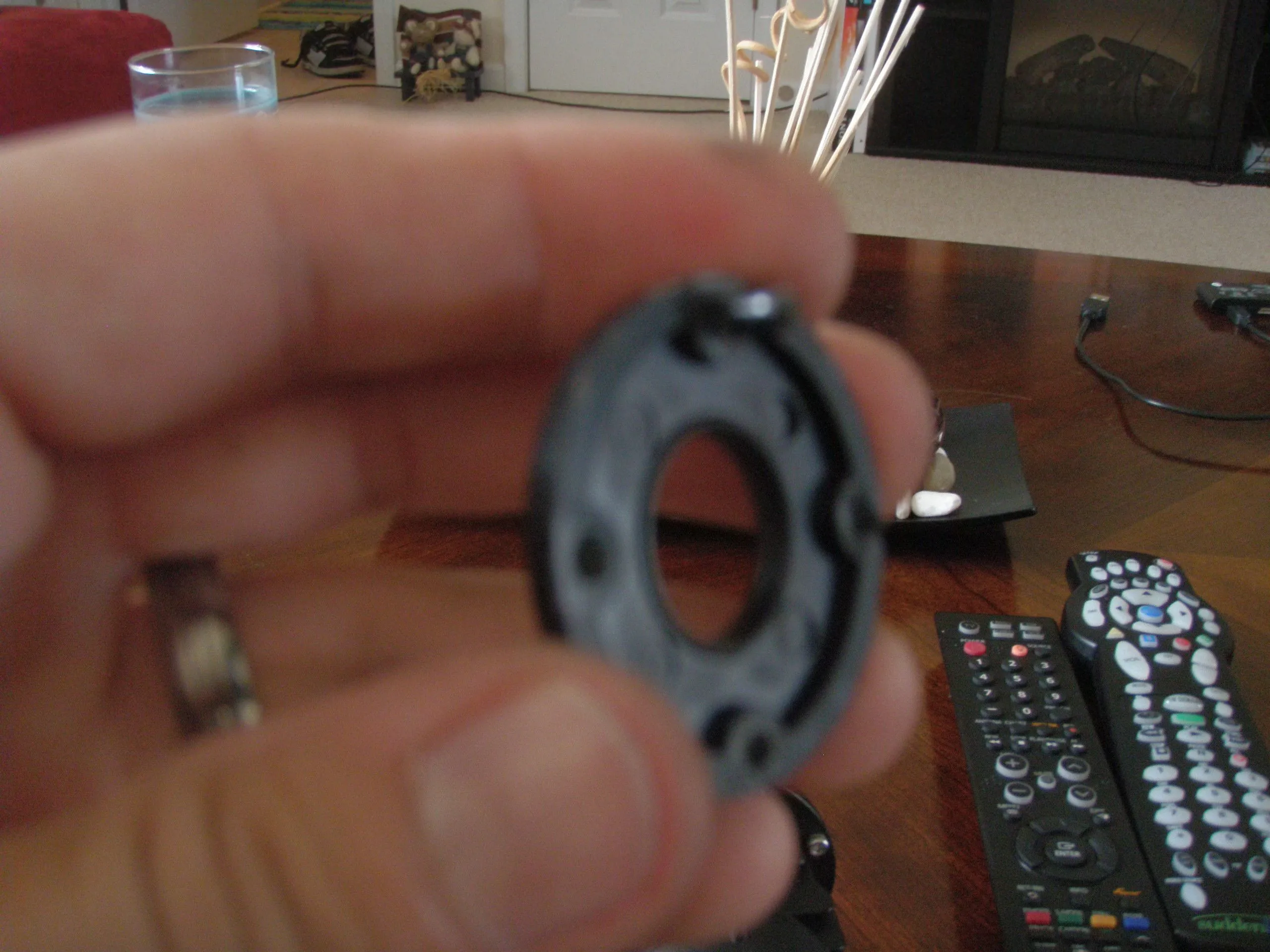

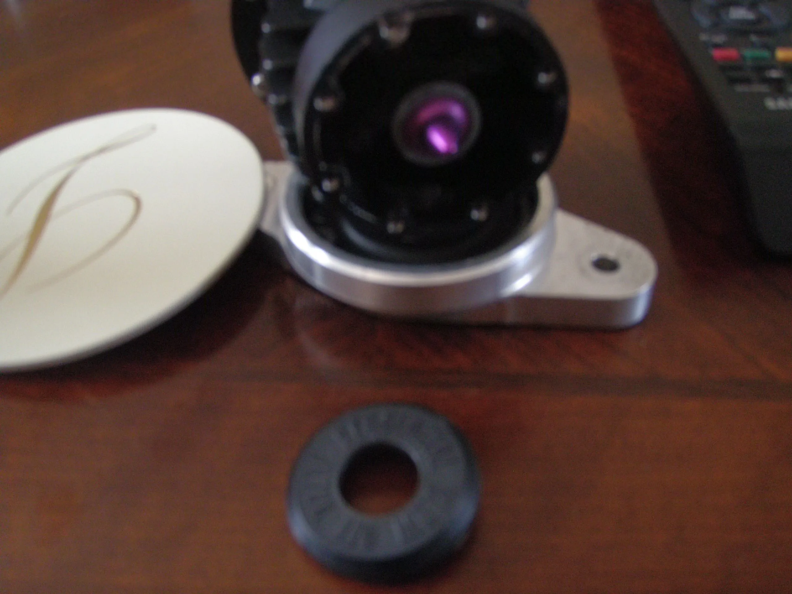

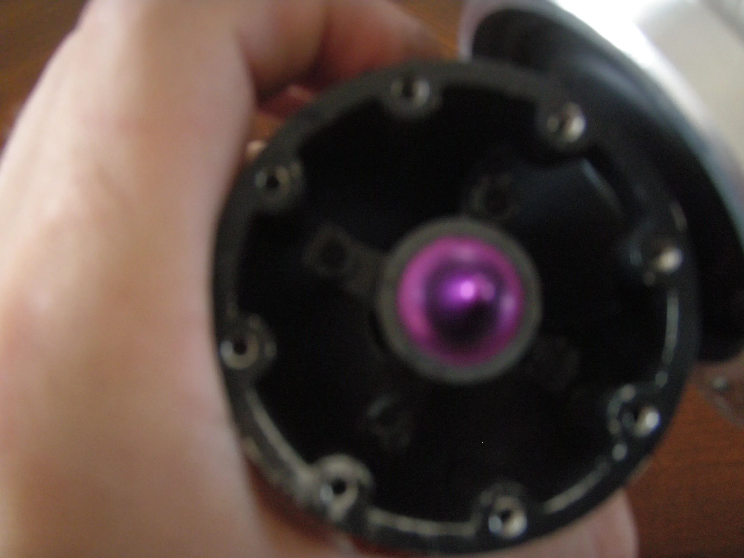

here's the pic. There's a metal/rubber piece that sits inbetween the valve body and the vent hole right where you can change the the body for high pitch low pitch or recirc. There's four prongs that are glued into a metal piece on the valve body shaft. that piece kind of looks like a plus sign or cross you can see it in the first pic. Three of the four prongs broke some how. I've re built and taken apart HKS SSQ's for a long time now. I've used them on all my turbo cars i've ever owned since back when the SSQ first came out. I've never had a problem with them so I'm suprised that this happen guess it was just a faulty part.

there's four prong that hold on the piece in the last pic to the piece in the first pic that sits inside the BOV thats shaped like a plus sign. The prongs are usually just held in place by pressure and heavy duty glue. Some how the prongs broke when the BOV opened or was shutting and caused the valve to jam and sit at a angle causing my boost leak BOV to sound wierd and the turbo to sound wierd cause the air was just rushing out but the valve was still able to slightly work just not right. Well I put my old turbo X's recirc valve on the the car drives fine now the turbo sounds fine and everything is back to normal except for my precious limited black HKS Valve. The valve was only used for about two months then i deployed to afghanistan and the car sat for the seven months i was over seas except to be moved a couple times. Like I said i think this was just a freak thing. I've always been a fan of hks and never ever in the god knows how many years i've used their valves ever had a problem.
