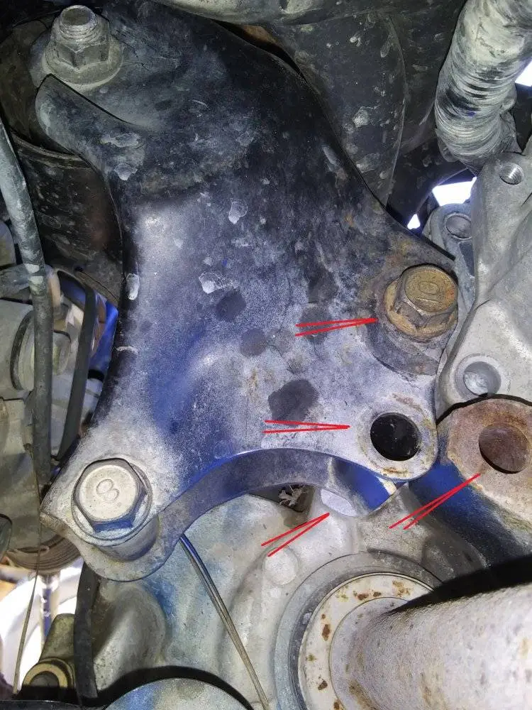

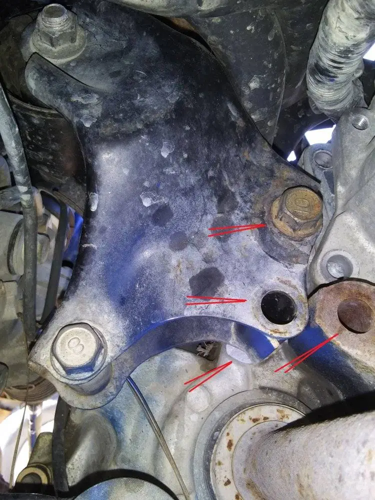

When I went underneath to start the transmission removal (to replace the clutch), I found the person who did the motor mounts left one transmission mount bolt out, a motor mount bracket bolt out and its transmission casing entry hole chipped off and the other motor mount bracket bolt loose (felt like it was stripped) - (see attached photo).
Not a happy moment for me as I've already bought a ton of parts to replace. 🤬
Luckily, I swapped out a couple bolts and dug one out of my bolt bucket that even though it was a bit too long, I washer-ed it up and the threads finally bit and held.🥳
On the chipped-out one I used some extra loctite on the bolt threads and the mount bracket has some surface area to spread the bolt/bracket load so now I feel more ok with that one.
