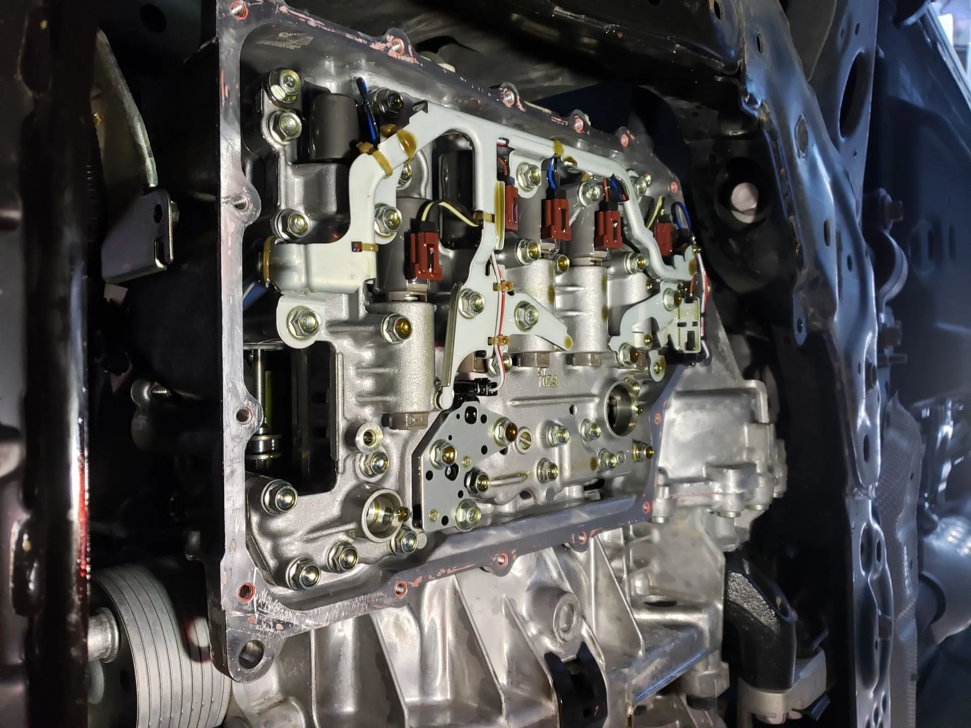

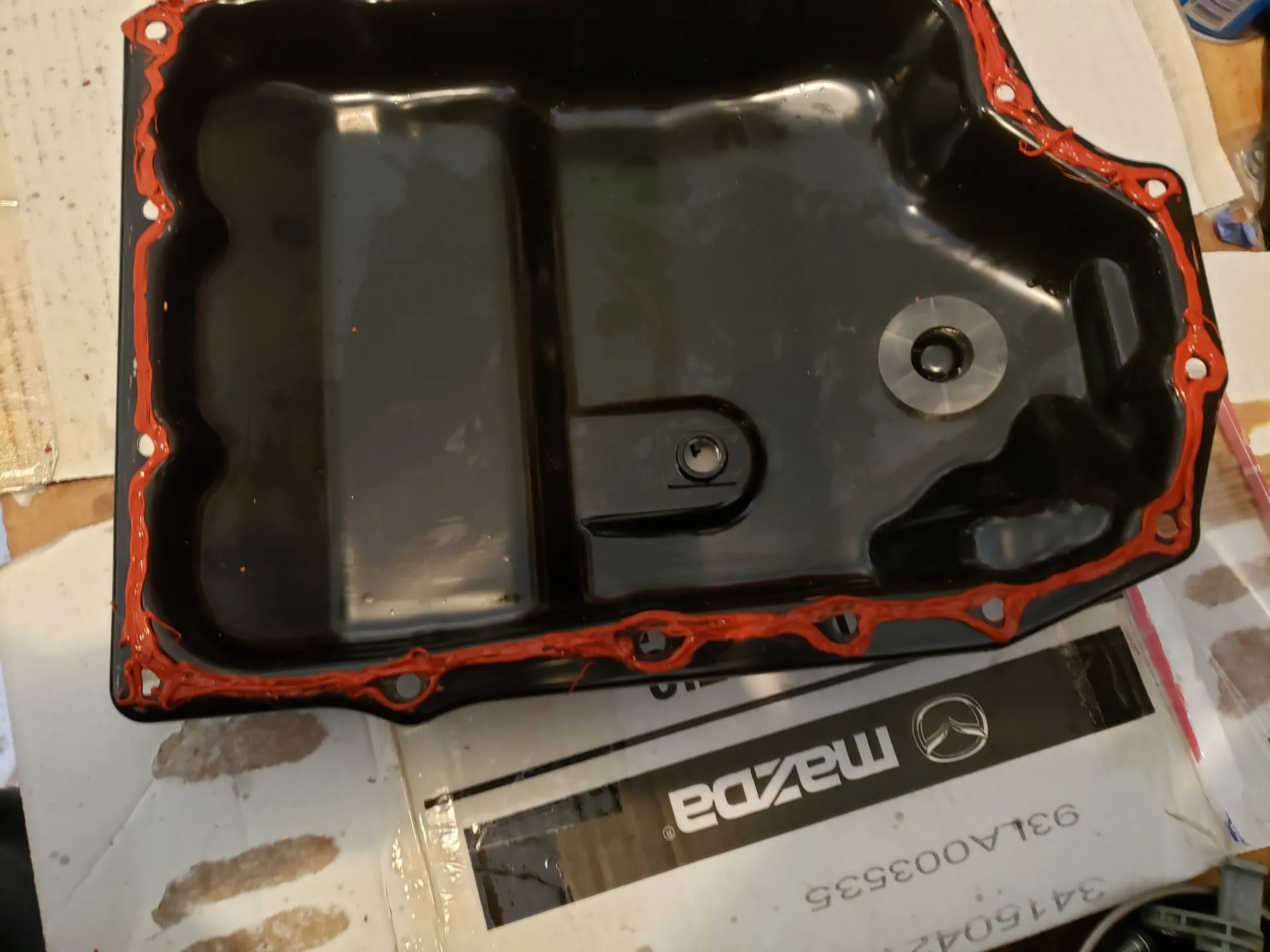

I would like to share my observations and experience while performing the transmission fluid change along my 40,000 mile service. I know that the service manual does not specify intervals for this job, but I have done it anyway since there is a fill and drain plug, and Mazda sells filter and appropriate gear oil.
1. The old transmission filter looked really clean.
2. The transmission pan magnet had ZERO, I repeat ZERO metal shavings. The bottom pan was really clean.
3. I have installed a new filter, put the new RTV gasket, bolted the pan (6 ft lb), and let the pan sit 24 hours to cure before adding the oil.
4. I have drained about 4.5 quarts of the Mazda OE oil, so I have refilled the transmission with the same amount. The old oil looked OK.
IMO, this is not a difficult job at all. Breaking the old seal took some time (putty knife works really well), and the Goo Remover was really helpful in removing some old gasket on the pan. While you are there you can change the engine oil and do the transfer case fluid change as well.
Now the question is, whether this is worth doing of not? I am glad I did it, and it only cost me about $120 for the fluid, filter, and RTV gasket maker. For the next service, I will wait until 90 or 100K miles. Based on condition of my old transmission filter, and lack of metal shaving, maybe drain and fill is a way to go, who knows.

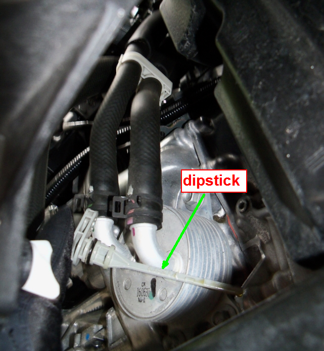

Can anyone confirm, or deny, that there is NOT a small fiber cartridge filter behind the trans cooling lines return cover (part hoses are attached to) in this photo?
If there is a cartridge filter on the lines that would be news to me. Had one on my Odyssey but not aware of one with Mazda Skyactiv. There is a filter inside of the transmission (more of a screen really). Drain pan needs to be removed to access it though and theres no gasket. Youd have to use silicone to reseal it to the transmission.
No. That is an ATF cooler or heat exchanger with engine coolant and ATF circulating inside.
here is the cooler, water-oil
bottom right
Yeah I know your modified ATF heat exchanger would have no coolant flowing as you're going to leave the original cooler hanging with the coolant hoses.
Actually it'd be the best to find some enhanced aftermarket Mazda SkyActiv-Drive ATF/coolant heat exchanger such as this modified 4-port cooler for Nissan's CVT from China. This enhanced heat exchanger has 2 additional CVT fluid ports for an external fluid cooler. For our SkyActiv-Drive a transmission flush is now possible with these 2 additional ATF ports! :)
