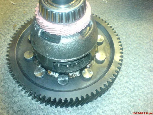

Here's a pic of my LSD w/ the pink speedo gear on it. I didn't need it because I have ABS, but it didn't hurt to just leave it on since it was already machined to fit.
the speedo gear fit right onto your MSP LSD? I thought I remember reading that machining needed to be done.
mmm nice welds on the LSD
