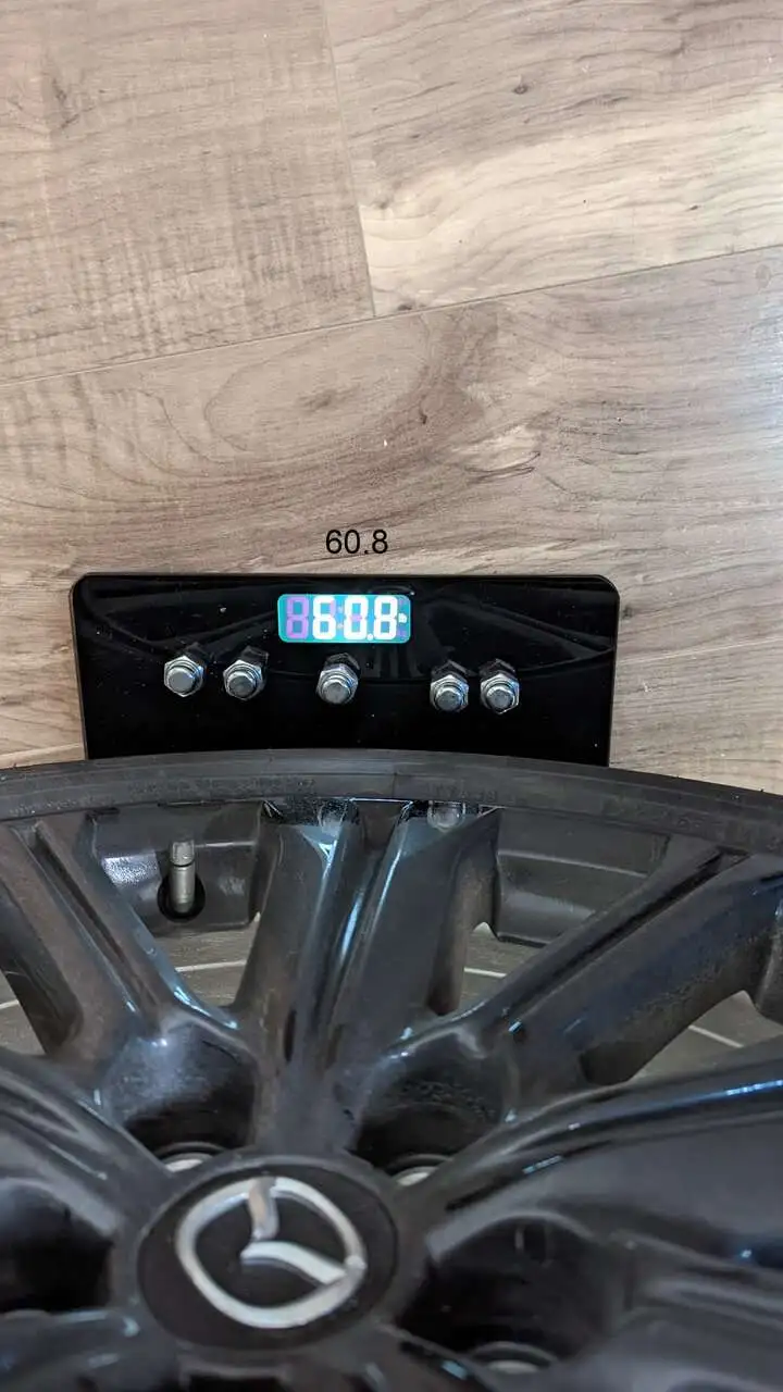

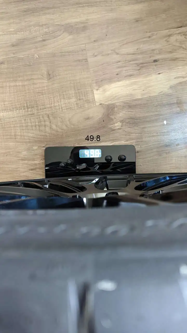

For the record, I just went from our stock 225/55R19 to a 245/45ZR20 and lost 11lbs per corner.
Here is the proof of it.
Old at 60.8lbs
New at 49.8lbs
So, going bigger doesn't, always, mean going heavier and in fact, can save quite a bit in weight.
Definitely. On my CX-9, I went up two inches in diameter and two inches in width, and I still saved 4lbs per corner compared to the OEM 20x8.5 wheels, lol.
Old at 60.8lbs
New at 49.8lbs
When upgrading wheels the first thought in my mind is "weight savings". 11lbs per corner is a major upgrade. I lost about 16lbs per corner on my Mazda6 resulting in better braking performance, less stress on braking system, less stress on engine when I accelerate. Also went 1 inch wider for better cornering grip.
