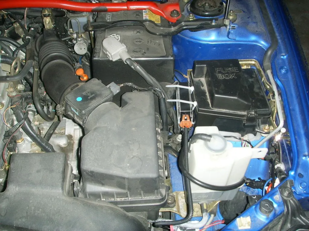

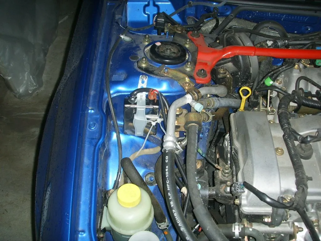

here r the locations for my ballasts...not the best place on the p5 but they work.....i was planning to put them at the hiding under the bumper (saw this in other threads) since i had the bumper off...but those security wires used that spot(dark) (chair)

Definitely DO NOT keep your lights on if they are flickering. Bascially what's happening is that your relay is flickering or sticking. This could cause your ballasts to fail prematurely.
For your DRLs I would use your fog lights. I am pretty sure the switch is mandatory. I got mine for 9$ from a junkyard.
I'm rolling around without DRLs right now. I have my corner lights on but that's it. I disabled mine by grounding the parking break wire. I just sold a bunch of HID kits in a GB and I picked up a DRL disabling relay. It works really well and avoids having to ground the handbrake.
it's waaay up under there if I recall correctly.. and yeah, depending on where your security system is installed it may be blocking your view. If it's the factory security system just unplug all the connectors on it, it's a pretty simple unit so it's not hard to hook back up.
