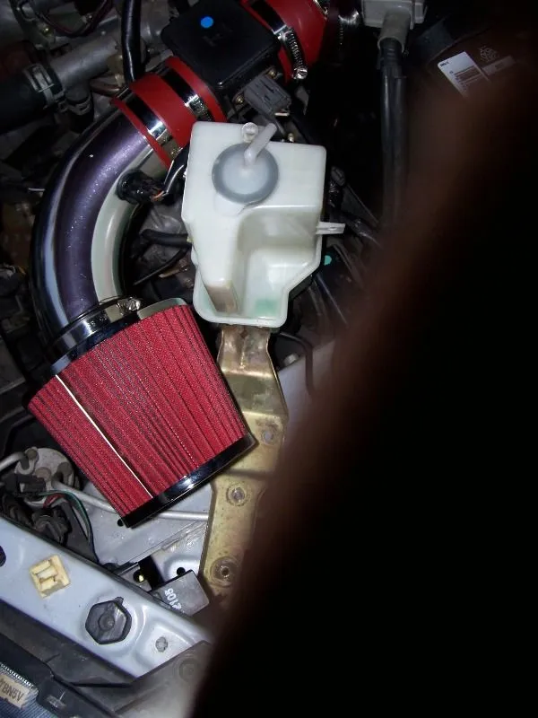

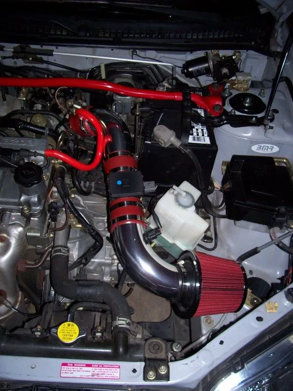

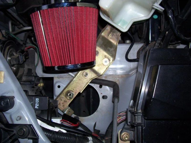

I installed it today. It just barely clears the master cylinder and I put the MAF between the two tubes. The only thing is the filter wants to occupy the same space as the coolant reservoir. I took the bracket off and found a screw hole that allowed me to move it catty-cornered next to the battery. I just need to get some tube for the overflow or it's going to spew on the MAF wiring and plug. That would suck.
The only thing I have left is to secure it. I rigged it temporarily with some wire for tonight. I'll figure that out tomorrow. The kit came with 2 brackets, one flat and about 7" with 3 holes drilled in it. The other is a short L with one hole. I can't see where they'll help, and there was no mention in the instructions. They were a joke, but I don't mind figuring things like that out. I'll search pictures and see what others do about it. I'll take suggestions if any of you have tips for securing it, or re-locating the coolant reservoir.
Here are some pictures:
