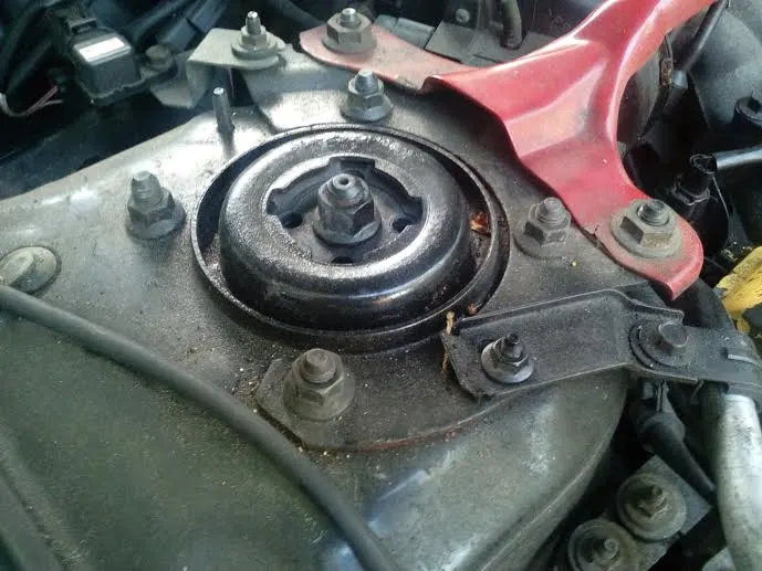

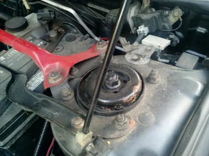

My question is, do you think I need to get endlinks as well all around as well as mounts? The mounts are attached below, let me know if you think I should get new ones or if those ones look decent enough to hold me over for a few months.
Also, is there anything else that you think I'll really need? Any opinions would be greatly appreciated, again, I'm a car newbie but I am learning a lot on this forum in just a few days so bare with me. I'm just trying to make sure that I do this the right way and not order parts just to realize I need more parts afterwards, so any help is appreciated and again, I know the struts aren't ideal.

I've heard mostly good things about the staggs. I would give them a shot. And if money's tight, you can try to avoid replacing the endlinks, however they do tend to seize and need to be cut. Your bumpstops are most likely fine. Strut tops are probably fine too.
Ight, sweet man thanks for the response, really appreciate it. At least I will save the money from buying the mounts and bumpstops. I'll probably just go ahead and buy the endlinks so I don't have to do the change again in the future.

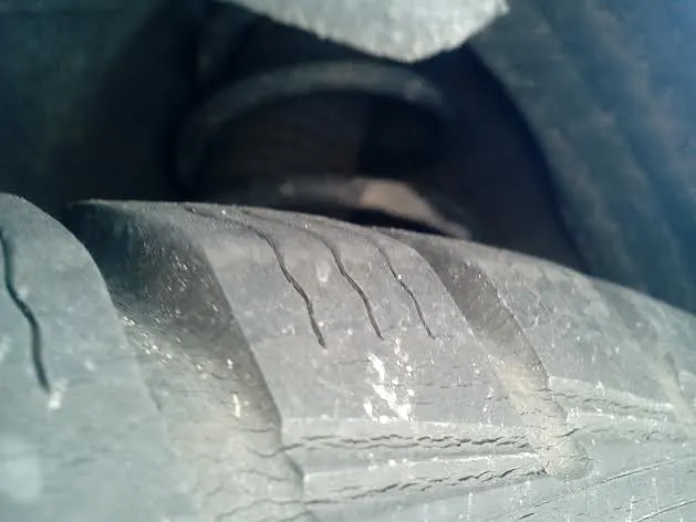

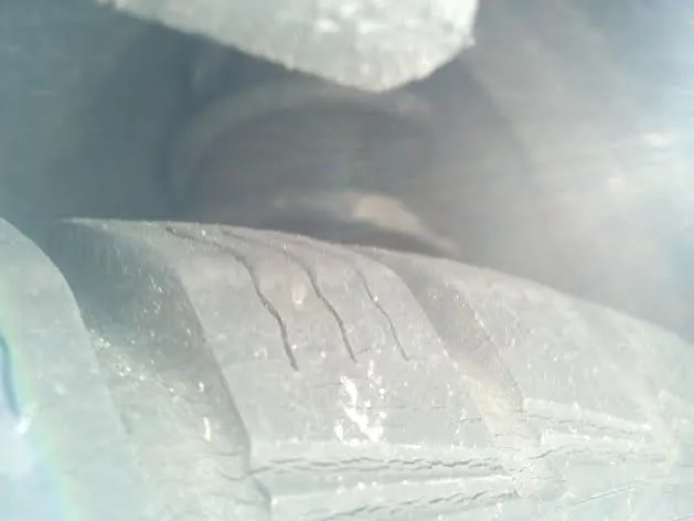

I'm curious as to what springs you have. If you can see up in there at all just to see what color they are, we can let you know.
If you are taking the front struts apart, I would get new strut bearings and end links (as mentioned) for peace of mind. Everything else looks like they should be fine.
If the condition of the rest of the car is any indication of those strut mounts, I'd say you got a hell of a deal for a car located in the north east. Does the body have any indications of rusty spots?
Alright thanks a lot @njaremka will do man! And @Jackie Chan the pic above is one I just took, its hot as a slave ship outside (dont worry im black) so the sun may be a bit reflecting of the bad photo, but here it is. I've painted the wheels black, and need to refinish them next week but I like them. They came originally lime green lol which looked horrendous. As for the springs, I tried my best to get a photo of them but its tough, they are black springs though, could be possibly eibach pros?
