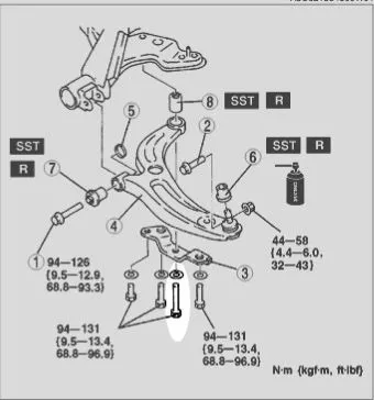

I have stripped a bolt on my car this weekend. The one that holds the wheel table (not sure if this is right!) to the frame. There is a rubber bushing around it... Now I don't really know what would be the best solution to fix this... would a helicoil be strong enough??

pic? have no idea what that is. (he thinks to himself "please don't let "wheel table" be an actual part! i will feel sooo dumb!")
helicoil should work, they are pretty srong, unless it is holding the body of the car to the frame. ;)
OK! Sorry for my bad technical english!! ;-) How does lower arm sounds!!
Anyway, here is a pic and I have grayed out the stripped bolt... What would be the best way to repare this? I want it to be strong!
Buy a new bolt!
marcksavoie said:
I'm afraid it's not that simple since the bolt is stripped in the frame... the threads in the frame will be bad also...
So? Pul lthe bolt and re-tap the holes. You can buy a tap and die set for like $50 for like 12 sizes...

Thanks for the tip! Unfortunately (or hopefully...) the bolt will extract from where it is... BUT as it's stripped it wont screw firmly... so I hear a TOC sound when I turn wheels or pull from a red light...
Yes, but then the bolt would have to be bigger to fit in the new tapped hole... But there is a bushing that the bolts goes through... I wish this never happened to me... but the mazdaspeed engine pulls so hard!
(wow)
The hole is no bigger because it's stripped, that's how a tap works. Just use the same size tap as the factory hole and it will re-tap the threads for you, then jsut buy another factory bolt and you're laughing.
I'll try this! And if it's that simple, I'll definetely be laghing!
