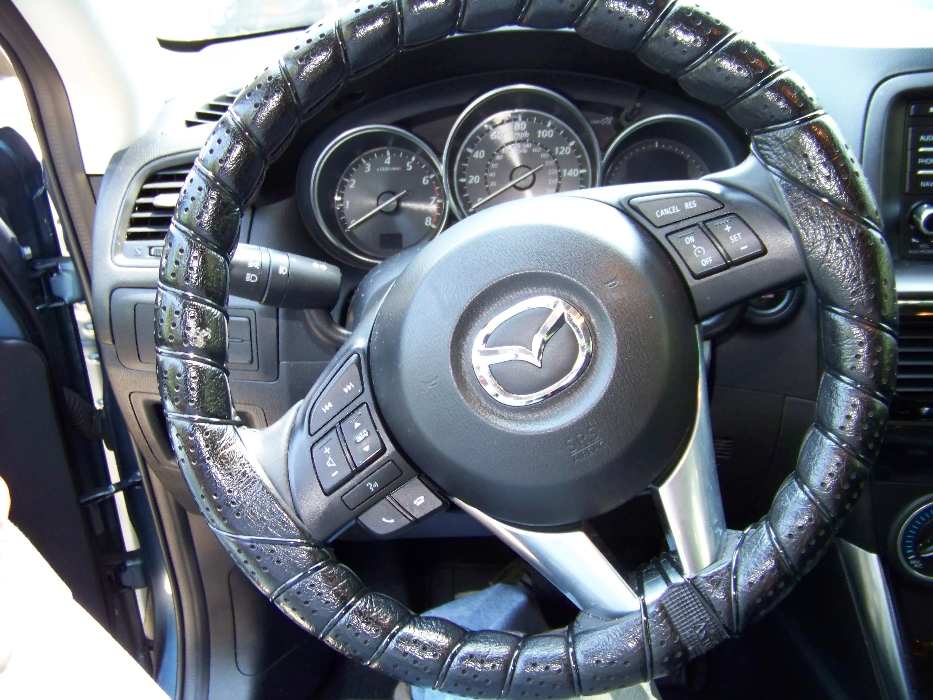

I tried a couple of the slip on types over the years, never could find any to fit tight enough so they all went right back.
My prefered cheap style can be tricky to install but once lacing is right they last for me.
Installed one on truck in 2000 and on CX-5 2years and counting.

Not on the type I like. If a proper fit it stretches a bit to fit the steering wheel which helps hold it in place while lacing.
Look at my pic closer and you can see small gap where edges meet on inside curve of wheel.
For best results warmer weather is good as lacing needs to be evenly tensioned so all stays tight over time.
I do finish it with one addional step, I run the lace end straight under the cover for 4-6" or so before trimming the excess.
To help lace ending work easier a leather lacing needle or smallish crochet hook or similar is a big help.
