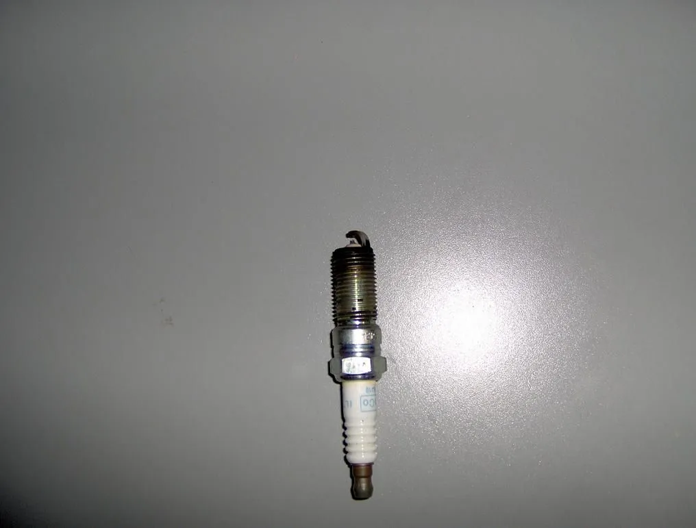

i got 15,000km on my car and i checked a spark plug and it doesnt look good, really black, anyway i had fomoco plugs, and i would like to upgrade, anyone

well im guess im going to wait intill my warrenty is up intill i put different plugs in and when there is a for sure anwser for aftermarket plugs, better safe than sorry, i had a look at 1 type of spark plug but wasent long enough, so im going to wait. what do you guys think about the plugs in my last post, 15,000kms.

you think that plug looks bad?, would the dealer try and void my warrenty if i took a plug out?
your plug looks fine to me man... its not going to be clean and those cars run rich so a bit of black doesn't seem abnormal.
ya i checkedon the internet for a spark plug chart and they look like there closer to the normal condition plugs, just a little black, mabye the plugs are too cold, running too rich, or weak ignition, it also says for carbon fouled plugs, check injectors and the cold start valve and circuit, and mabye the correct fuel pressure settings. probally just too rich as you said, but im having a cold start issue.
