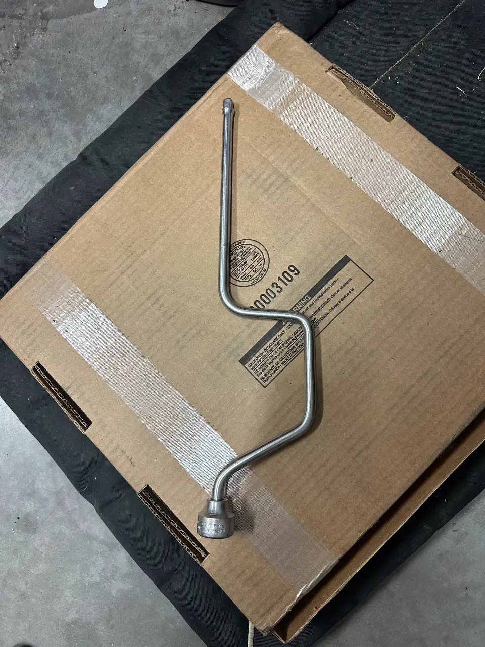

X2 on get at spark plug socket. I broke a plug swapping out plugs on the side of the road. I made a WOT pull and wanted to read a plug to confirm the tune. I bought a plug socket the next day.
Gut tight works for me too, just barely pull on the wrench. I use an old school Speed Wrench to run the plugs down. NO power tools on these soft aluminum threads. I pull on the Speed Wrench handle to snug the plugs.
We change 16 plugs often on our other platform racing engine, Hemi. Speed Wrench is fast and safe.

i do have a spark plug sockets I have changed upwards of 500 sets of plugs and never had one blow out or strip out or break....I generally go by feel as well especially on initial install when the washer is uncrushed. usually 2/3rds after the washer is seated gets it done, altho I have a pretty nice armstrong in/lb torq wrench that is of jewel quality :) that is incredibly accurate from 50 in/lbs to 240 in/bs

when you know you know lol...this is at least 50 years old...it is a Wardsman brand and I have had it for as long as I can remember. I have a 1/2" drive too.
