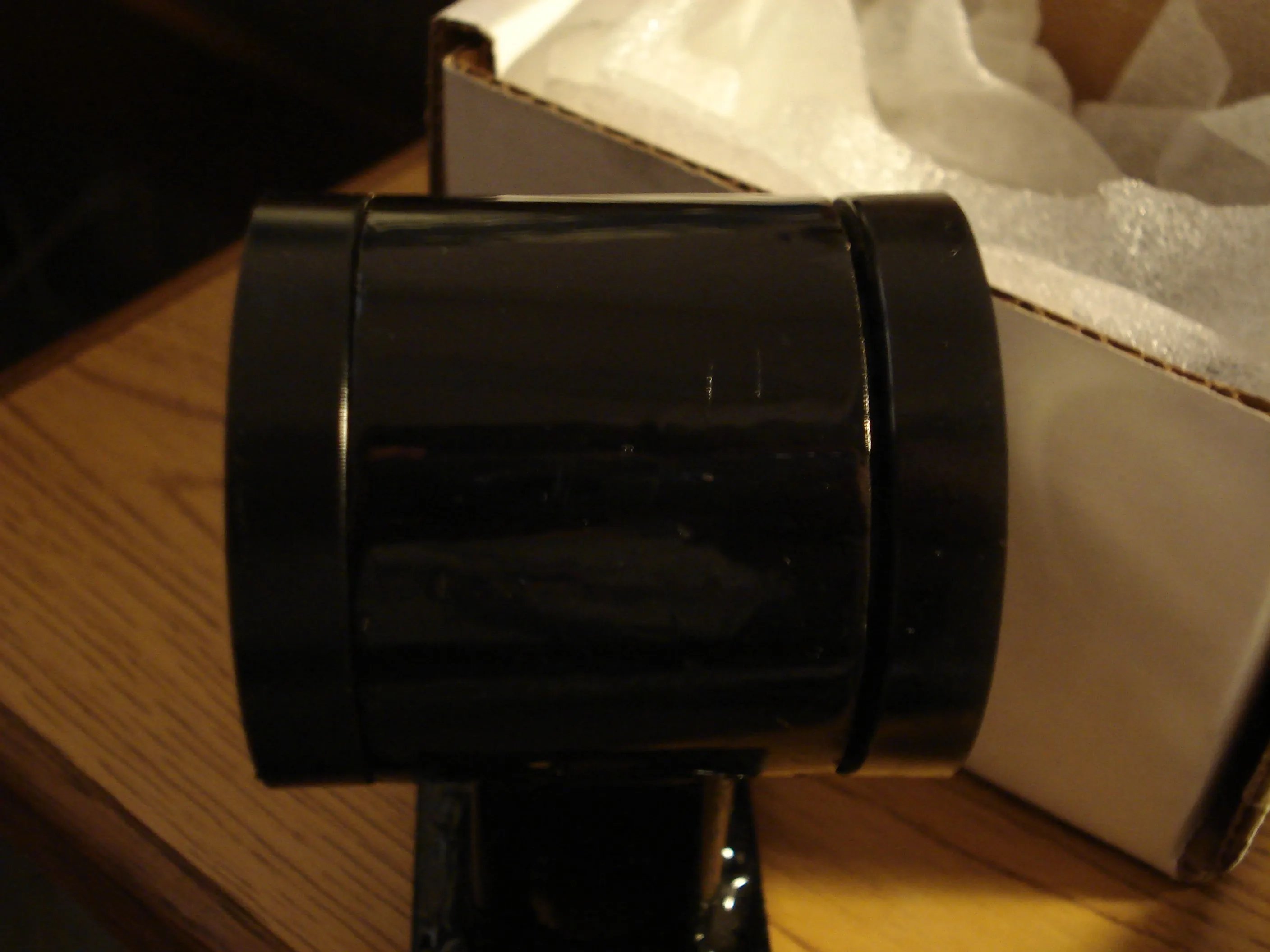

well i got my mount today and i must say i am quite disappointed...and i havent even installed it. there are scratches and dents all over the thing, it looks like it's been installed before or at least someone tried to install it. not to mention one of the inserts is too far away from the mount. so i emailed sls to see what they say. like kansei said, their new ones have the sls logo on them and this one doesnt.
Mine was kinda like that too. No sticker, pretty scratched up for something new. But meh, it worked just fine.

was one of the inserts farther away than the other? and how many nuts/bolts did yours come w/? is there a left and right side to this or is in universal?

is there a left or right to the mount and what about the gap from the one insert?
You can reuse the nuts from the stock mount, the only reason why you cant use the stock nuts is because there not really nuts, there just threads on the bottom of the mount. I used my stock nuts and they fit just fine, and no there isnt a front or a back to the mount. Not that I know of anyways. Can you push the other insert back in at all? I mean I really wouldnt be worried about it though.
they emailed me back and said to push it in, but i tried and it didnt go. so i'll try again
