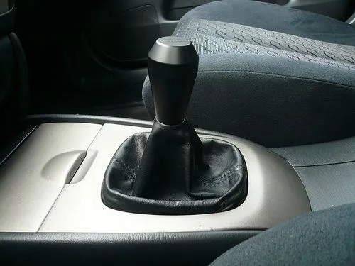

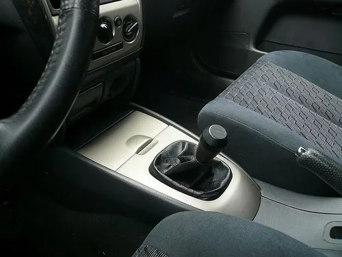

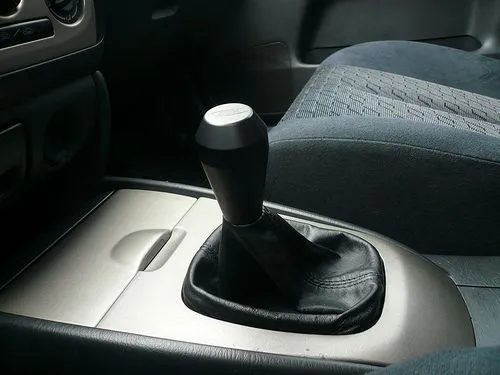

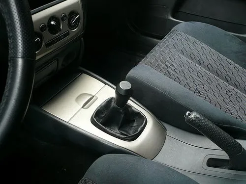

i installed my twm short shifter earlier this week, just wanted to share. i love it, it looks much better than the stock one. it seems a little stiff getting into the gears, but i'm guessing that'll wear off...or maybe i tightened a bolt a little too tight. it was much easier to install than i had expected, easier than even the headlight black out.

yea itll get lose after u break it in...lol. that and you'll get use to the feeling of it and won't even realize the notchy feeling.

it's really a lot easier than you'd expect. just take out the silver piece with the cupholders, then center console. remove the snap ring and the 2 other ring things under that. then get under the car and take out the bolt connected to the stock shifter, then the whole shifter, then put in the new ones, and put everything back together with your new shifter. putting the snap ring back is the hardest part, especially without snap ring pliers.

the chance of it losing up is unlikely, i'm coming up to 5 years and its the same for me. You will get use to it. Also changing tranny fluid to synthetic will help a lot.

Yeah, I love my TWM. At first, i really really disliked how hard it was to go into gear, but, as stated, it does wear it some, or I wore in some. I dont know. But, did you also install the shift bushing? Or, just the short shifter?

You can overtighten the bolt through the bottom of the shifter...If you put it too tight, it will feel very stiff and way too notchy...may want to play with it a bit and see if that helps....
