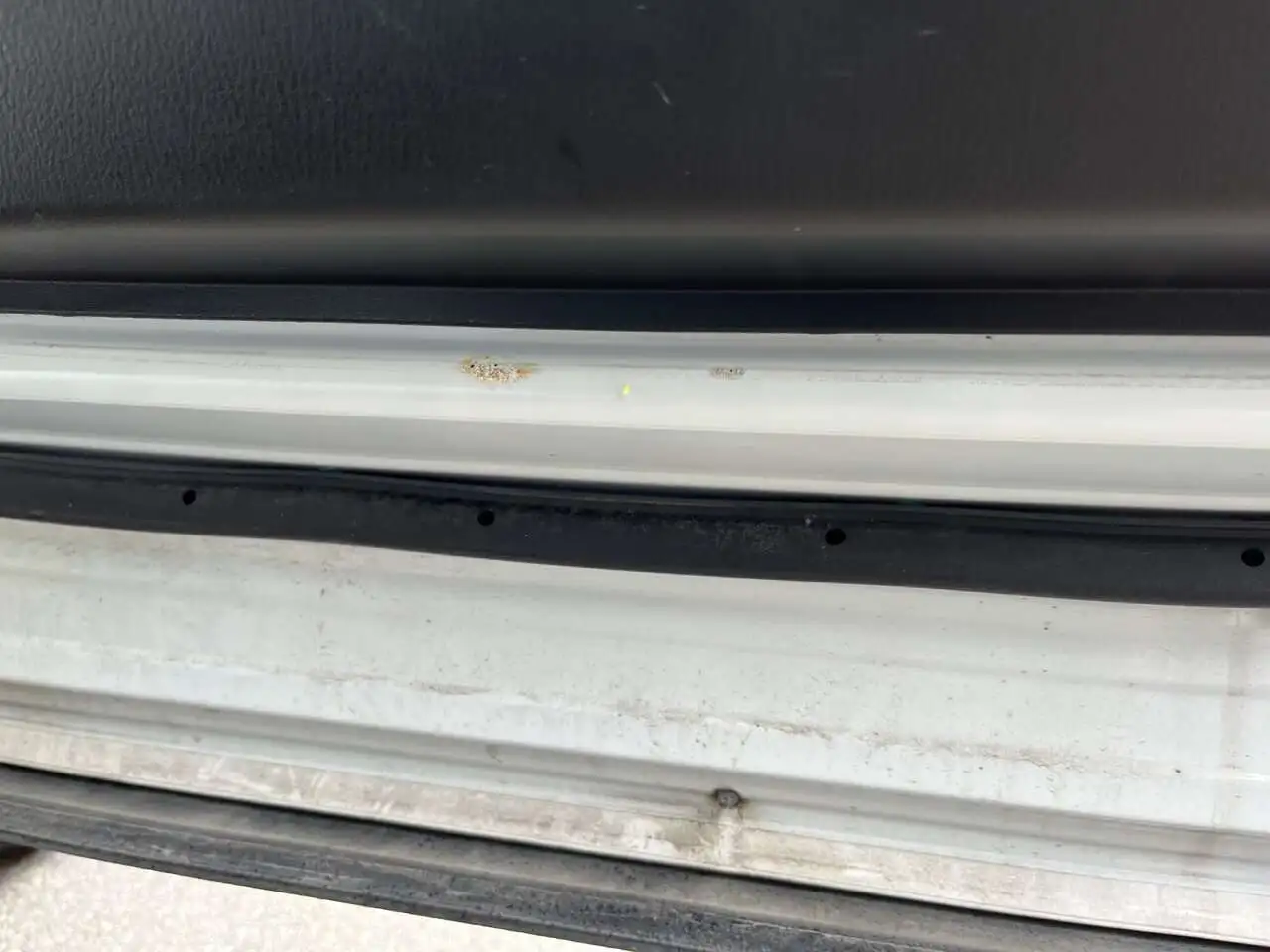

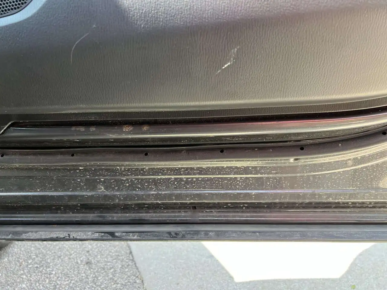

Hey folks.
Last winter the drivers side door of my CX5 became very heavy and hard to open, especially when the temperatures got well below freezing.
Initially I just figured that the hinge would need fresh lubricant, although I have never lubed the doors on any vehicle in 30 years and have never experienced this issue.
When discussing this with a friend he mentioned the chance that the door took in water and perhaps there was/is no drainage. I did recall that for a small period the inside of the window got very streaky and needed to be cleaned, I have never had to do that before so maybe he was on to something. I went to take a look at the inside of both front doors and I discovered rust there, much to my surprise. I always loved how the way the doors are designed limited the about of debris and moisture that builds up, especially when compared to other cars.
Does anyone have this issue on their cars? Any tips on how I can identify a drainage point?
Usually there’re a couple of drain holes at the bottom edge of the door. Check to see if they’re clogged and any water accumulation inside of the door panel.
Wow! That looks like hell!!!
Gotta be the drain holes. Is your CX kept in a garage? I'm betting not.
No mention of the MY of your CX, still under warranty?
That door panel needs to be removed for inspection.
It’s a 2019, yeah I plan on getting it looked at. 5 year warranty is up in mid February.
100% outdoor parked unfortunately.

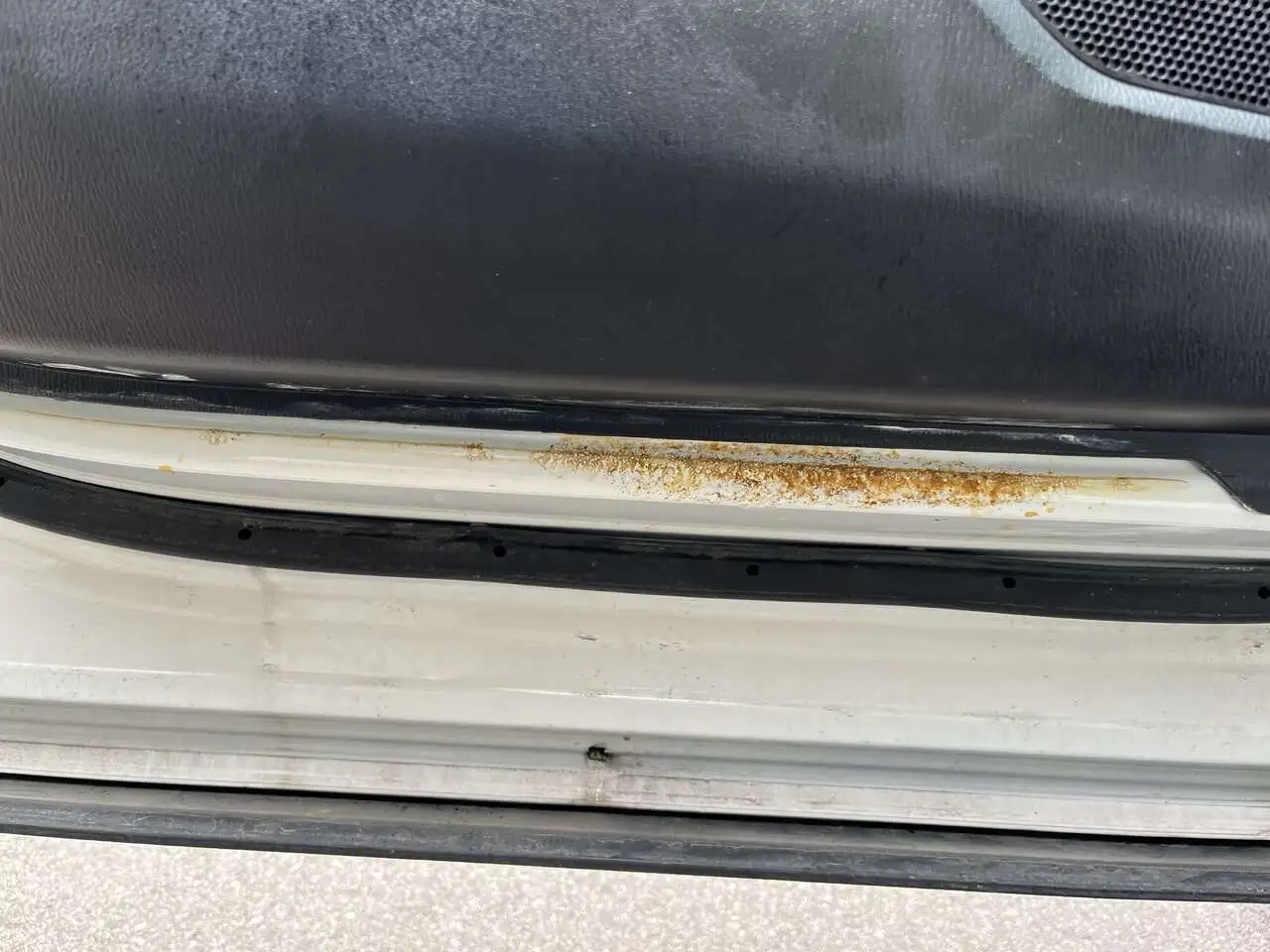

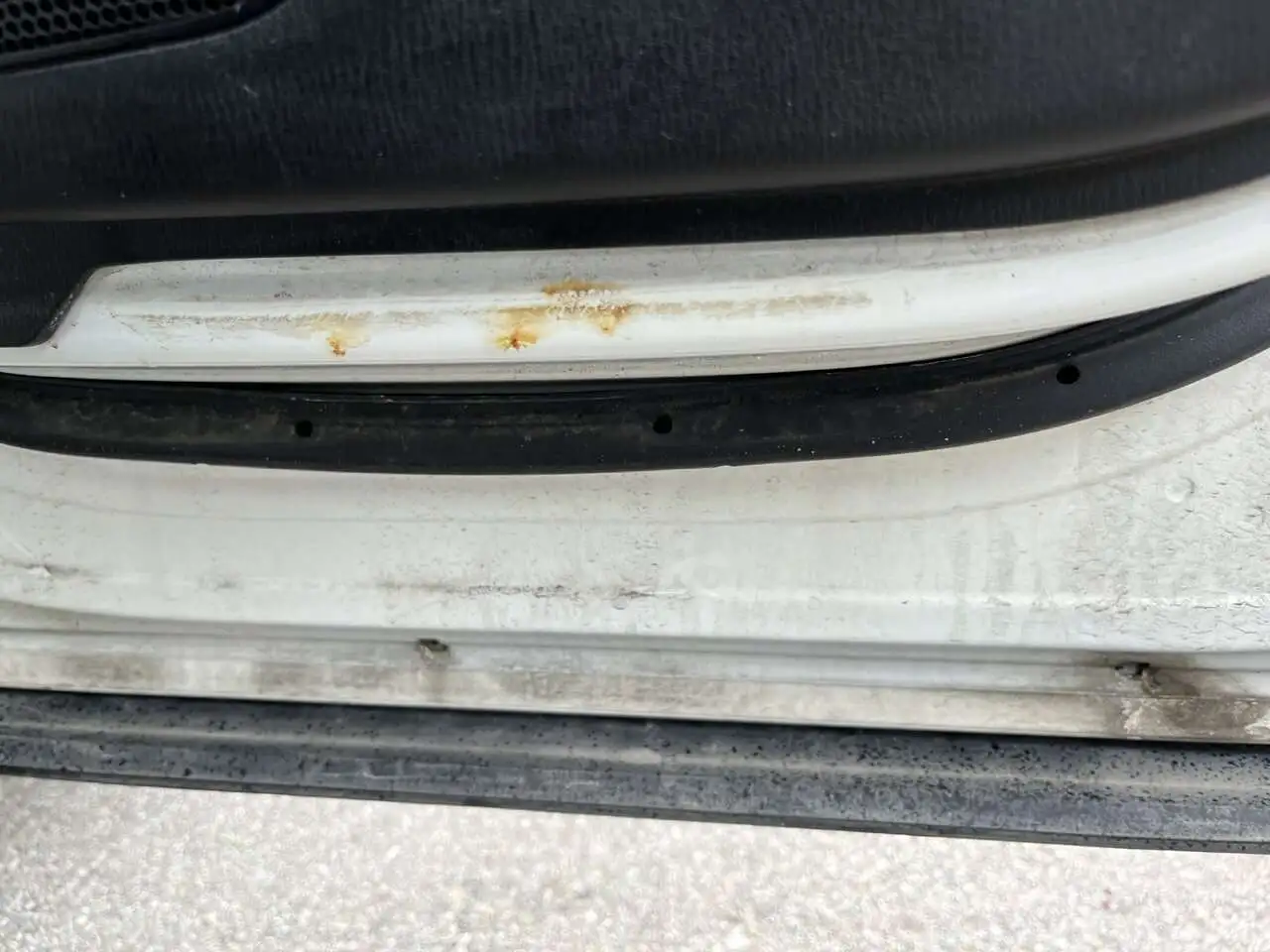

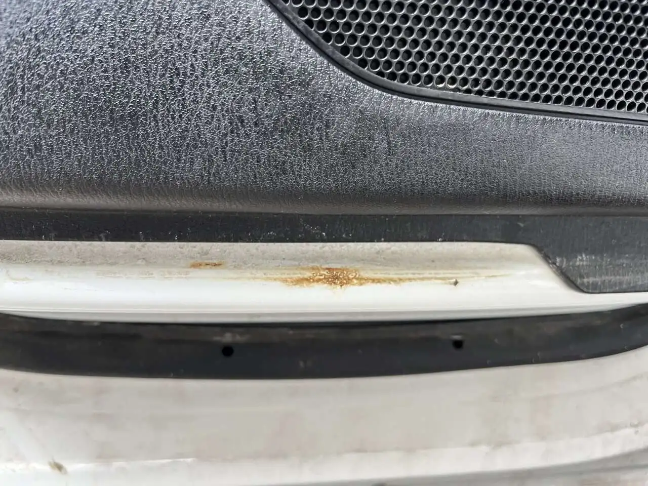

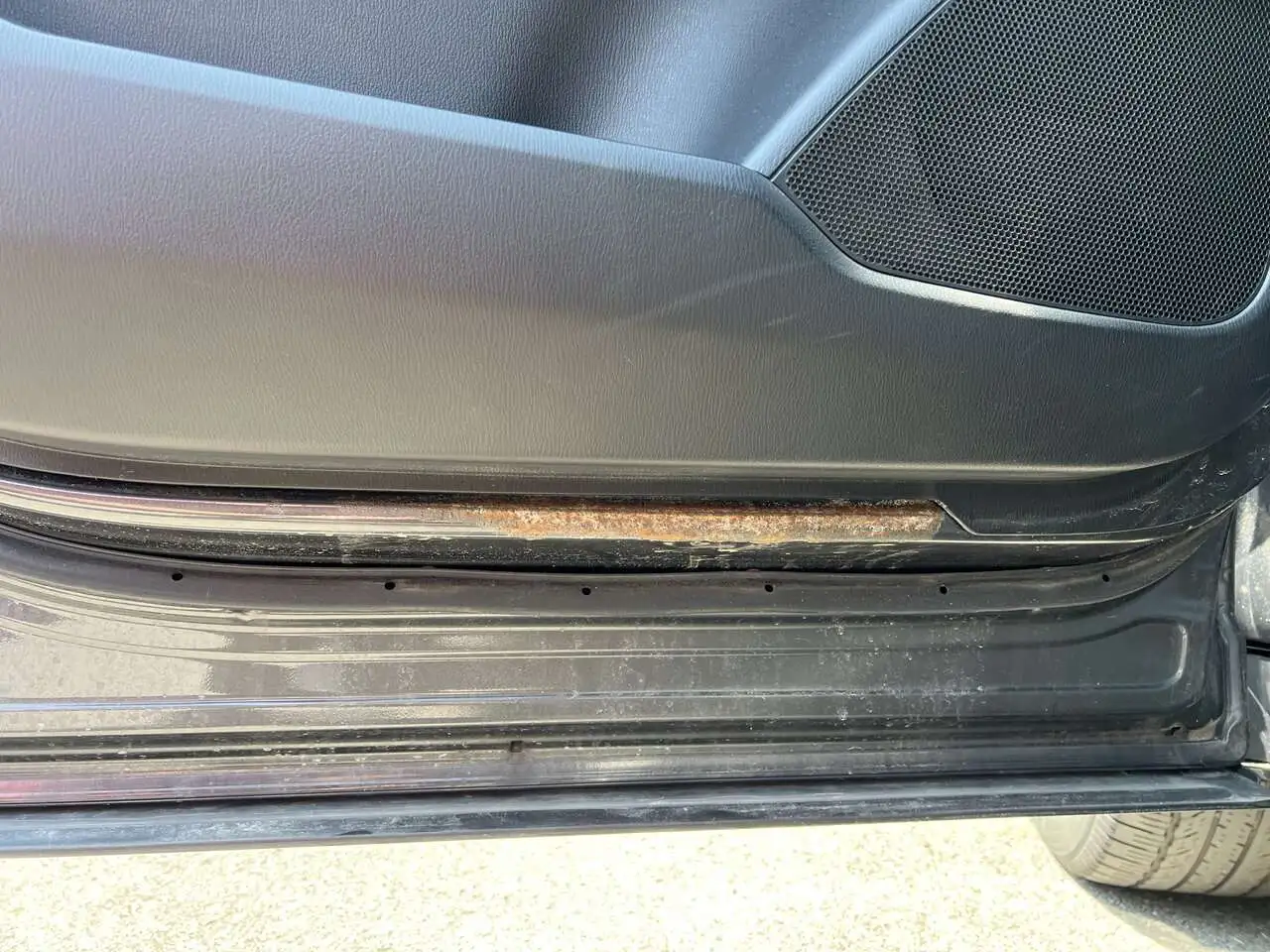

I have a 2017 Mazda CX-5 which I bought new and appear to have the same problem as you. I noticed that there is rust on all four inner door panels as shown in the picture.
I have brought this to two autobody shops, both who have indicated that this is a manufacturer defect and that the doors are not draining properly resulting in the rust. They also advised that even if rust if sanded and repainted, the problem is likely to occur again, unless the drainage issue is fixed.
Mazda has declined my claim since they said there is no perforation.
Have you or anyone else had this issue and found a solution for it or been able to get Mazda to cover it and take responsiblity for the poor manufacturing.
I plan on having it repaired but do not want it to occur again.
Thanks in advance.

There is a TSB for the rust on door panels, Mazda states different reason for it appearing though.
You can find the details here in this TSB:
TSB 09-009/21
Do you think the reason that they reported for the rust is accurate? They stated that it’s caused by sand and mud brought in by the people in the vehicle. In my opinion it seems like a fake excuse not actually addressing the real issue which is the poor door drainage. Just wondering if you think their proposed suggestion with adding the protective film will even fix the issue.
What makes you think its not addressed/fixed for newer CX5s?
For older ones the TSB is only option.
I would treat this with rust inhibitor and implement the TSB if I were you. Also make sure when you wash the car to always wipe that area. At least thats what I do regularly and no issues whatsoever on my 2018.

Is that surface rust, or is it rusting from the inside out?
Yes, this TSB:
TSB No.: 09-009/21 Rusty Panel at Bottom (Inner Side) of Doors
from Mazda is the most ridiculous one I’ve ever seen:
DESCRIPTION
Some customers may complain about rust at the bottom (inner side) of the doors where the seaming welt is located. It is caused by mud/sand adhering to the side sill, which scratches the paint surface when the door is opened/closed. The mud/sand is most likely brought in by the driver and/or passenger when stepping in and out of the vehicle.
If the rust really caused by mud / sand on the sill and scratches the paint on the door bottom, it should happens in every Mazda vehicles. How come it’s happens only on 2017-2021 CX-5 and 2016-2021 CX-9?
There is no perforation so not getting covered by Mazda. The autobody shops have advised that rust is likely starting from inside the door panel since the water is staying there.
You should check if 2 drain holes at the door bottom are clogged or not. Pour some water on window glass and trim and verify.
