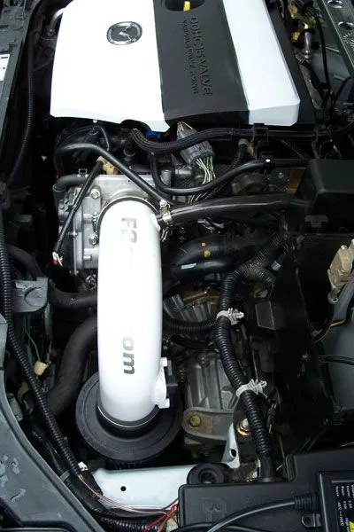

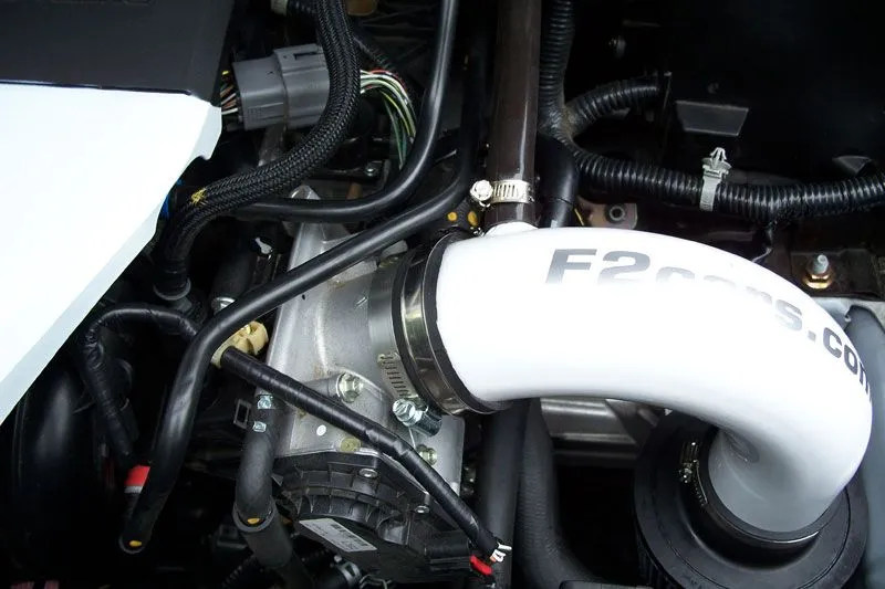

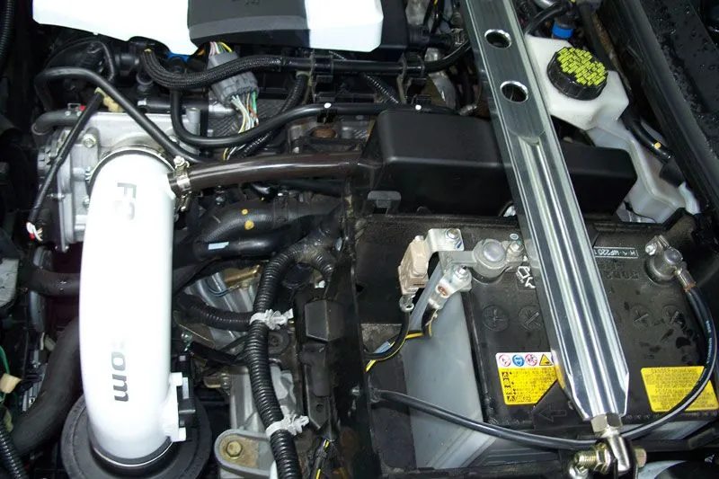

The last couple of days I have been battling with this Intake and this thing is really pissing me off. As of now I have F2 CAI which I converted to a SRI. I reconnect the negative battery plug, started the car up and let the car run. It goes through the rough idle which is expected cause the ECU is relearning. After that it goes smoothly. My issue....after I let the car sit for 8 or more hours, I start the car up again and I get the same rough idle I got when I first reconnected the battery. It feel like the car is about to cut off cause its struggling to breathe. It goes through this for 20 to 30 seconds then goes back to normal. I checked and rechecked the connections, reset the ECU again and still it happens. What causes the car to keep going through a rough Idle? I'm going on day 3 with this issue since the intake is on the car. Did I forget to connect something?
Any advice is greatly appreciated. Thanks

I would check the wires on the MAF sensor to make sure none are ripped and make sure all the couplings are tight. Also you can spray some carb cleaning to clean out the intake....just make sure you dry it all up. And you can use some MAF cleaner on the sensor, you may have gotten dirt on it during the install. just some suggestions.

I first got the problem once the intake was installed. IMO..whether its a SRI or CAI that doesn't matter. Just starting the car after several hours it idles rough like its about to shut off then it idles smoothly. It seem like its relearning the intake again.

After reading tons and tons of threads I think I notice what my issue was. I didn't install the reducer. (bang) But overall I'm not satisfied with this intake.
