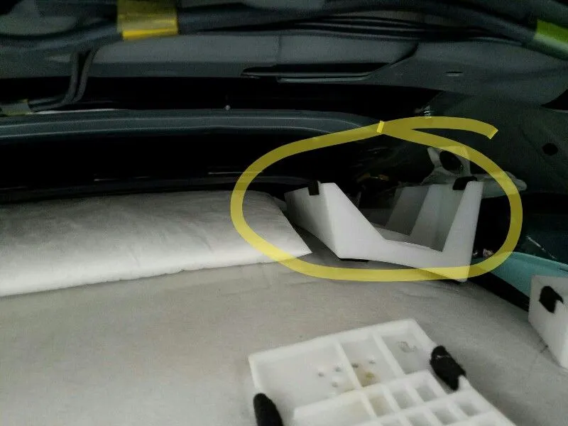

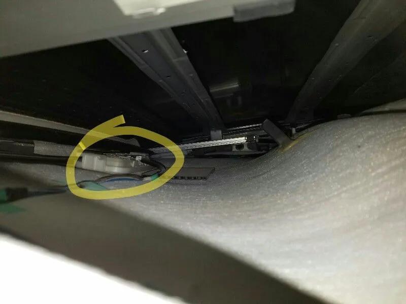

Subwoofers have caused so much vibration in this vehicle. So I've slowly been trying to deaden the crap out of everything where I think it would be most beneficial. Was trying to avoid the roof. But it needed to be done. I halfway brought the headliner down and it was clear why I get so much roof vibration. Plastic panels are right up against the roof. The light compartment in the back seat is also right up against the roof. As the roof vibrates, it will smack right against these plastic pieces. I used thin foam for the plastic as much as I could, and got about a sheet and a half of sound deadener on the roof. Keep in mind, dropping the headliner even this much involves removing several panels and you can easily dirty or even crease the head liner. However its totally worth the work. Its been the most beneficial out of all the areas I've applied deadener. And I hope to do the front part of the roof down the road. I got a few before pics that I included showing the light compartment and the plastic pieces I mentioned. By the time I was done, I was just ready to button it up and get cleaned up. So no after pics.
