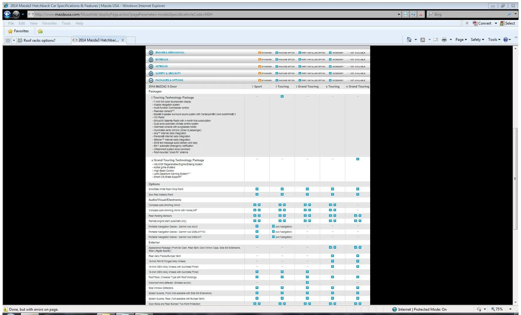

Well that would suck if your only option is the grip mounts. Just checked MazdaUSA's site and it does in fact list the roofrack as an accessory for the 5 door but not for the 4 door?
attachment.php
