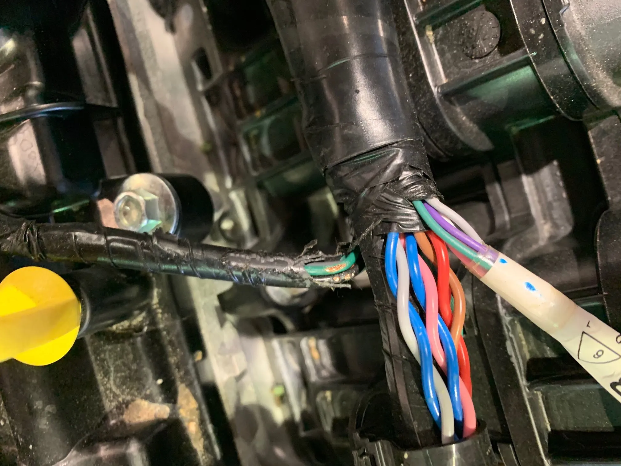

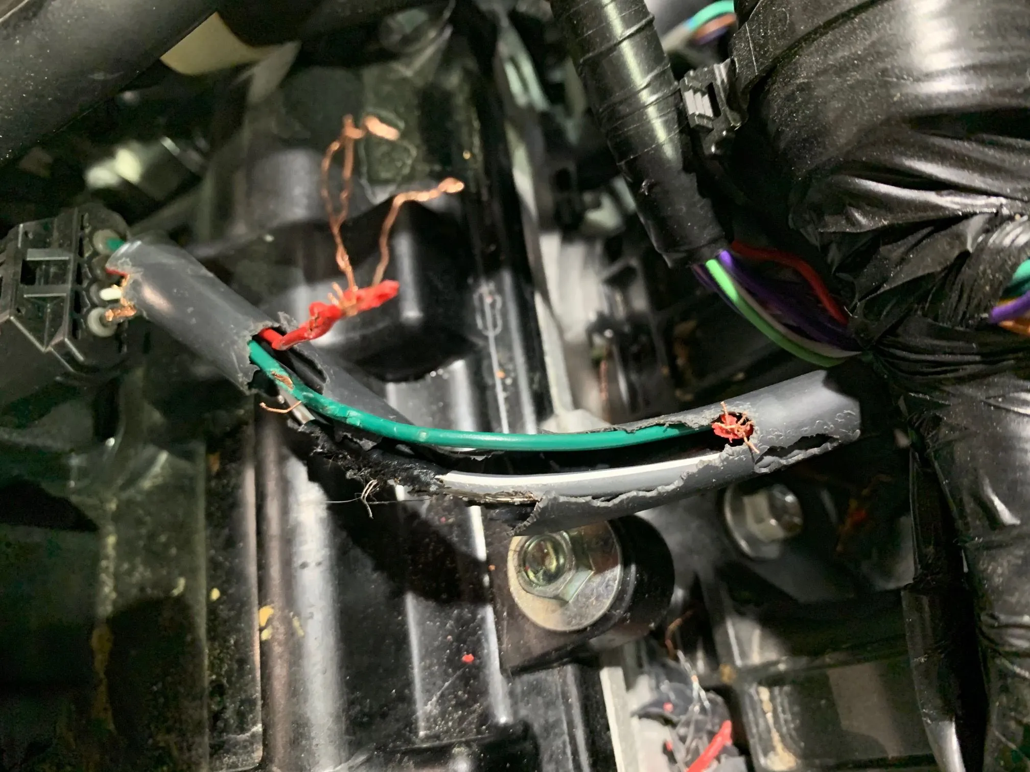

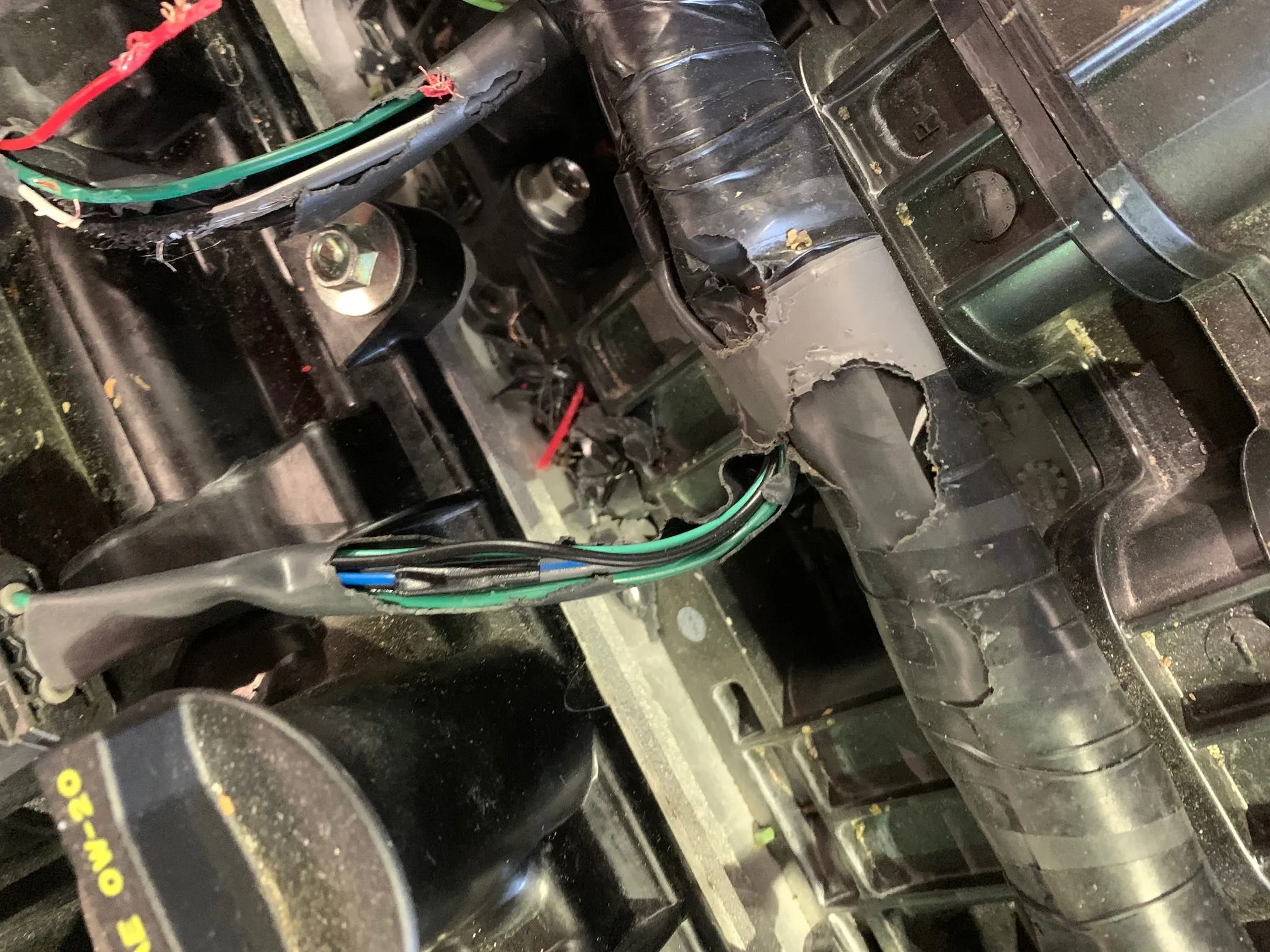

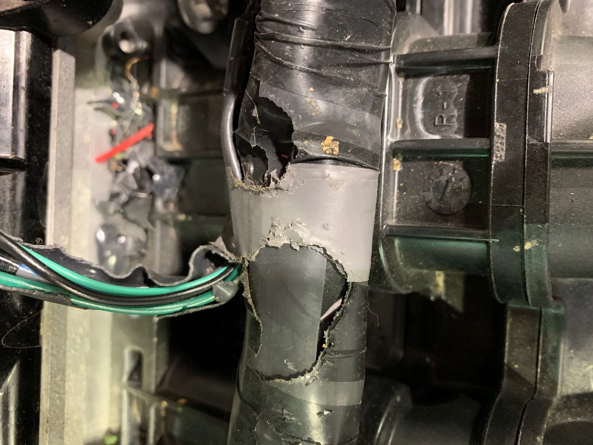

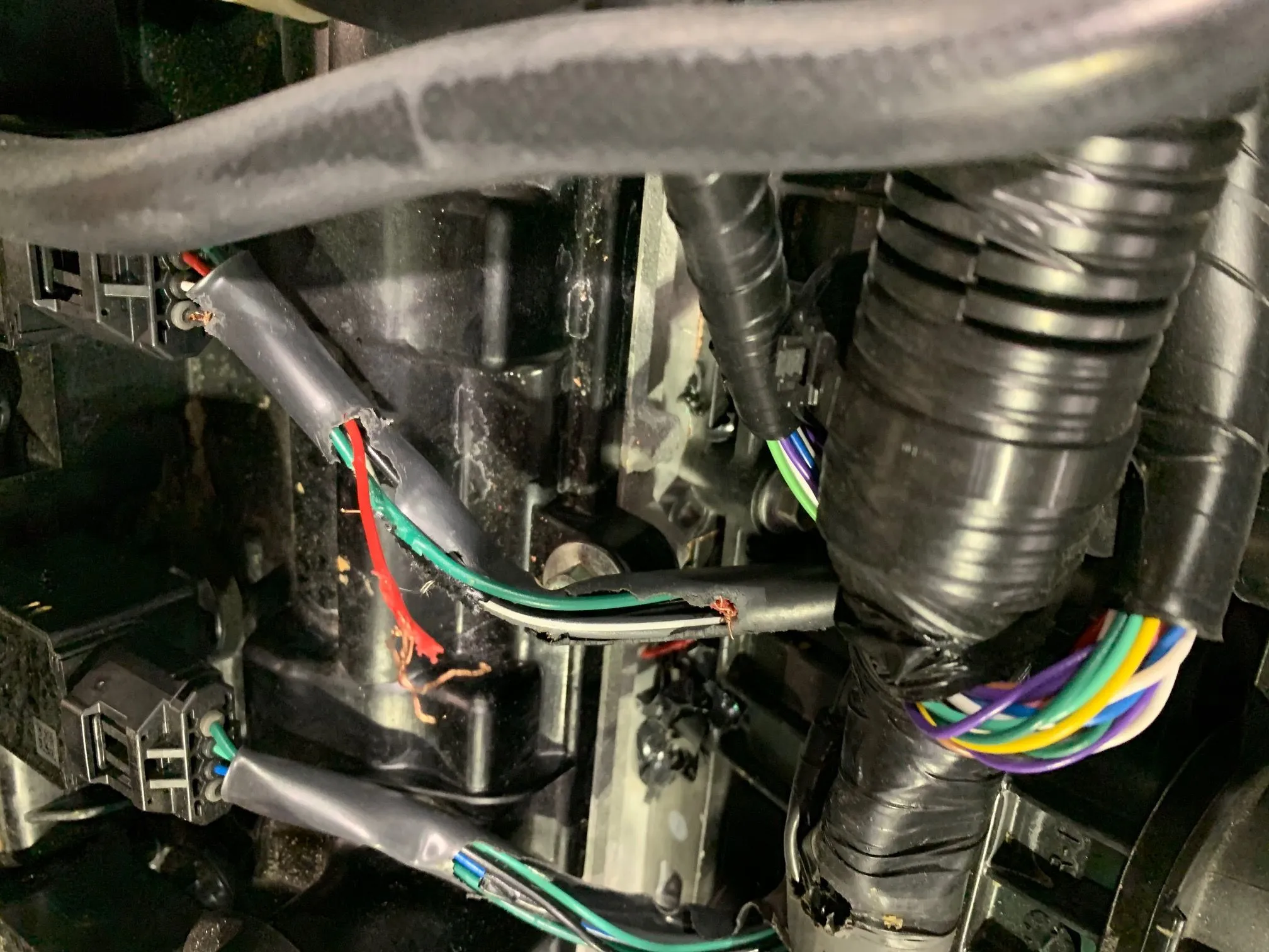

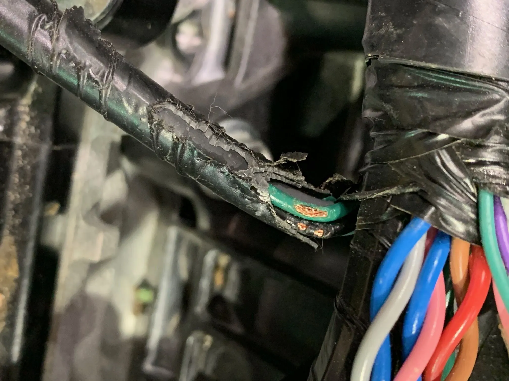

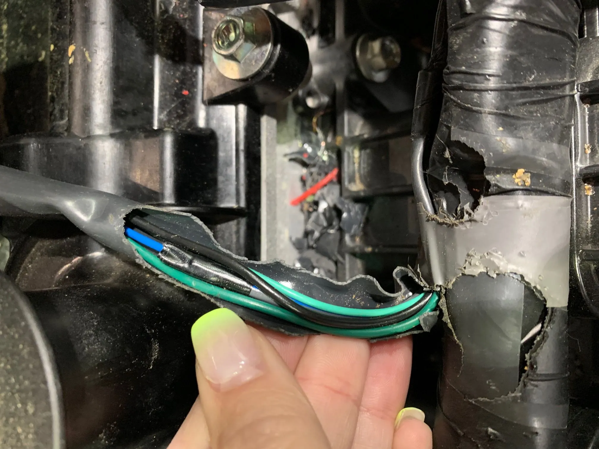

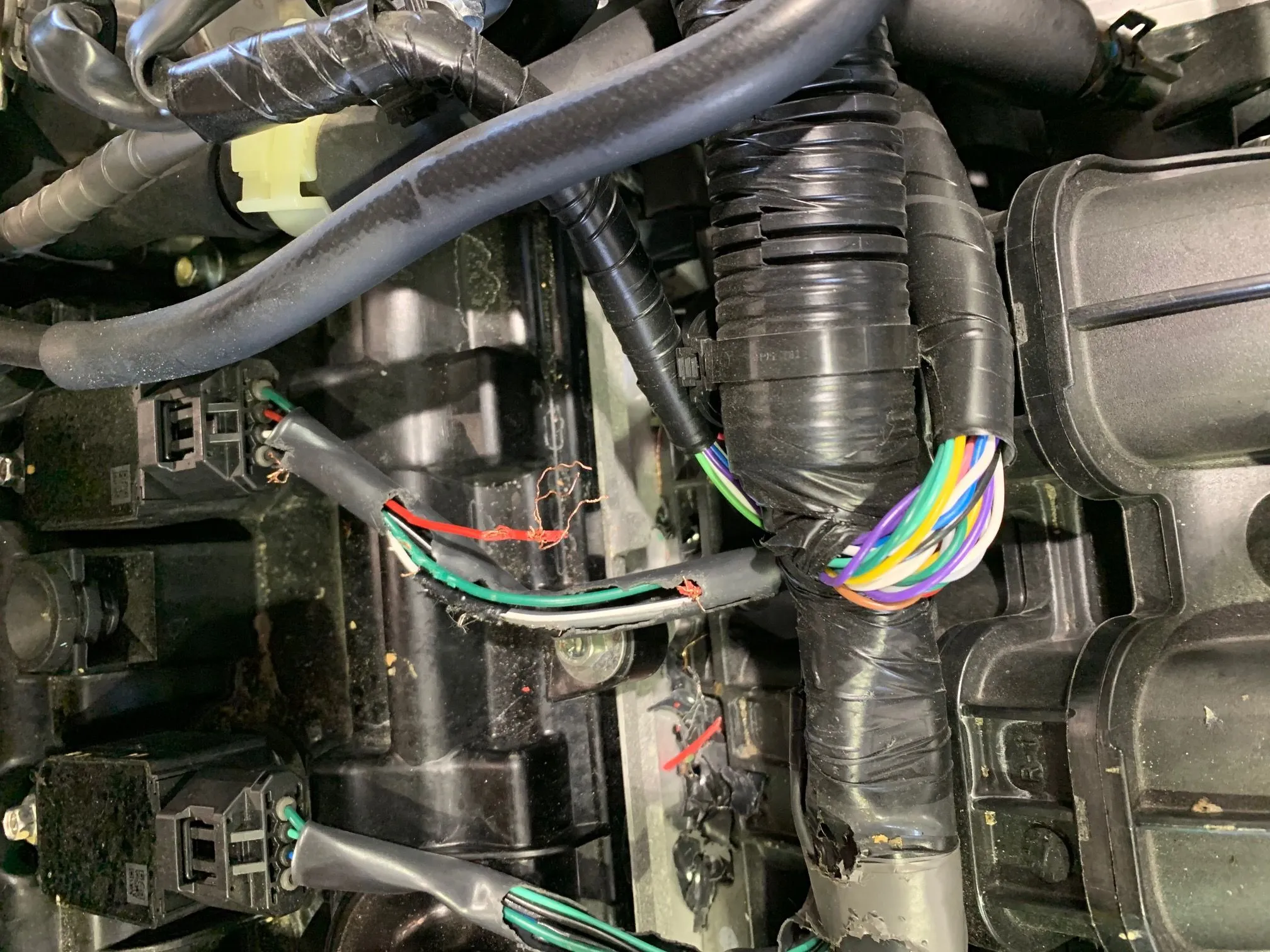

Confirmed! Holy Crap $1500 and Mazda saying its not their fault. Hell no. I'm going after them!
