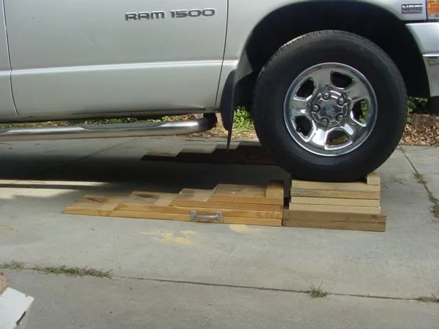

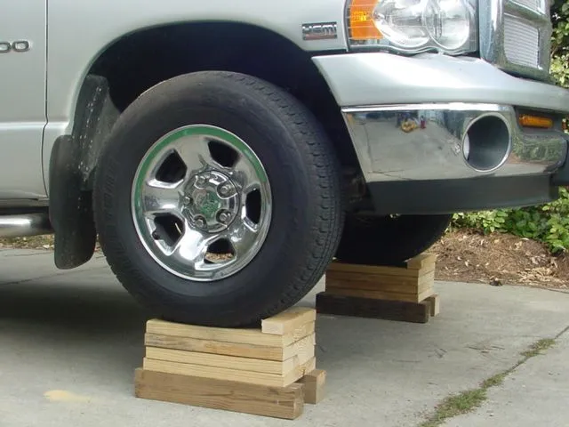

I built these out of 2x12s They work well for the Speed, the 300, and my Ram. I can remove the ramps and just leave the pedestal in case I need to get under the sides. Total lift is 9 1/2"
