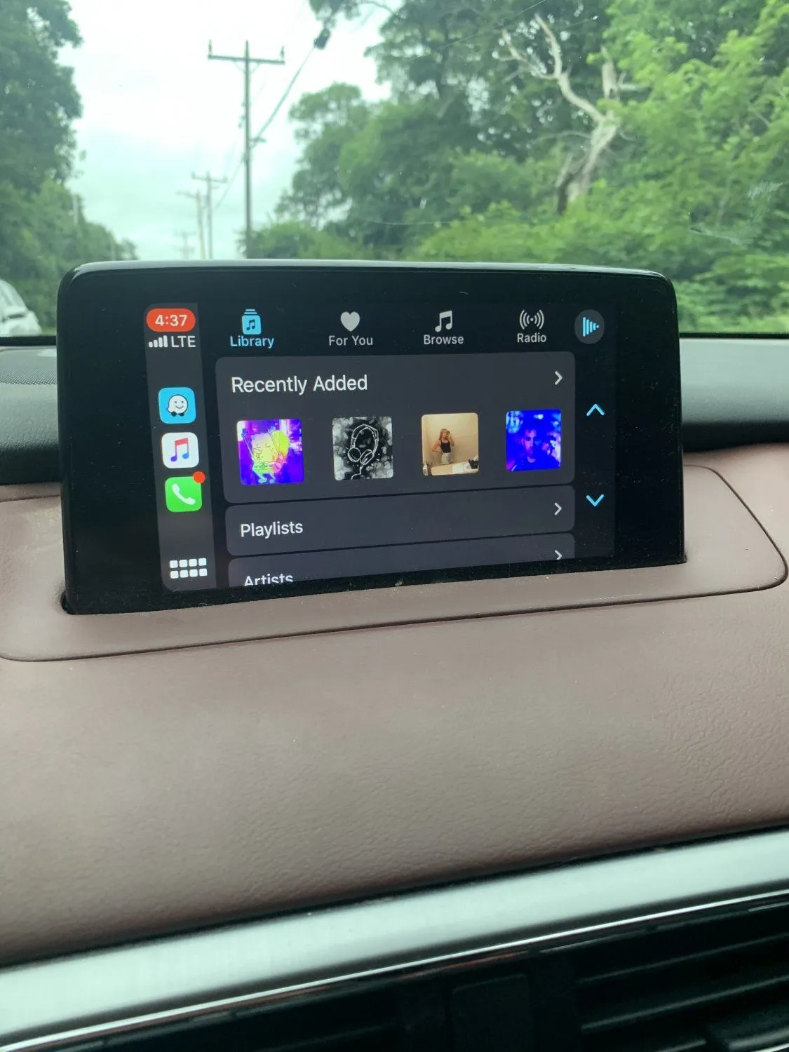

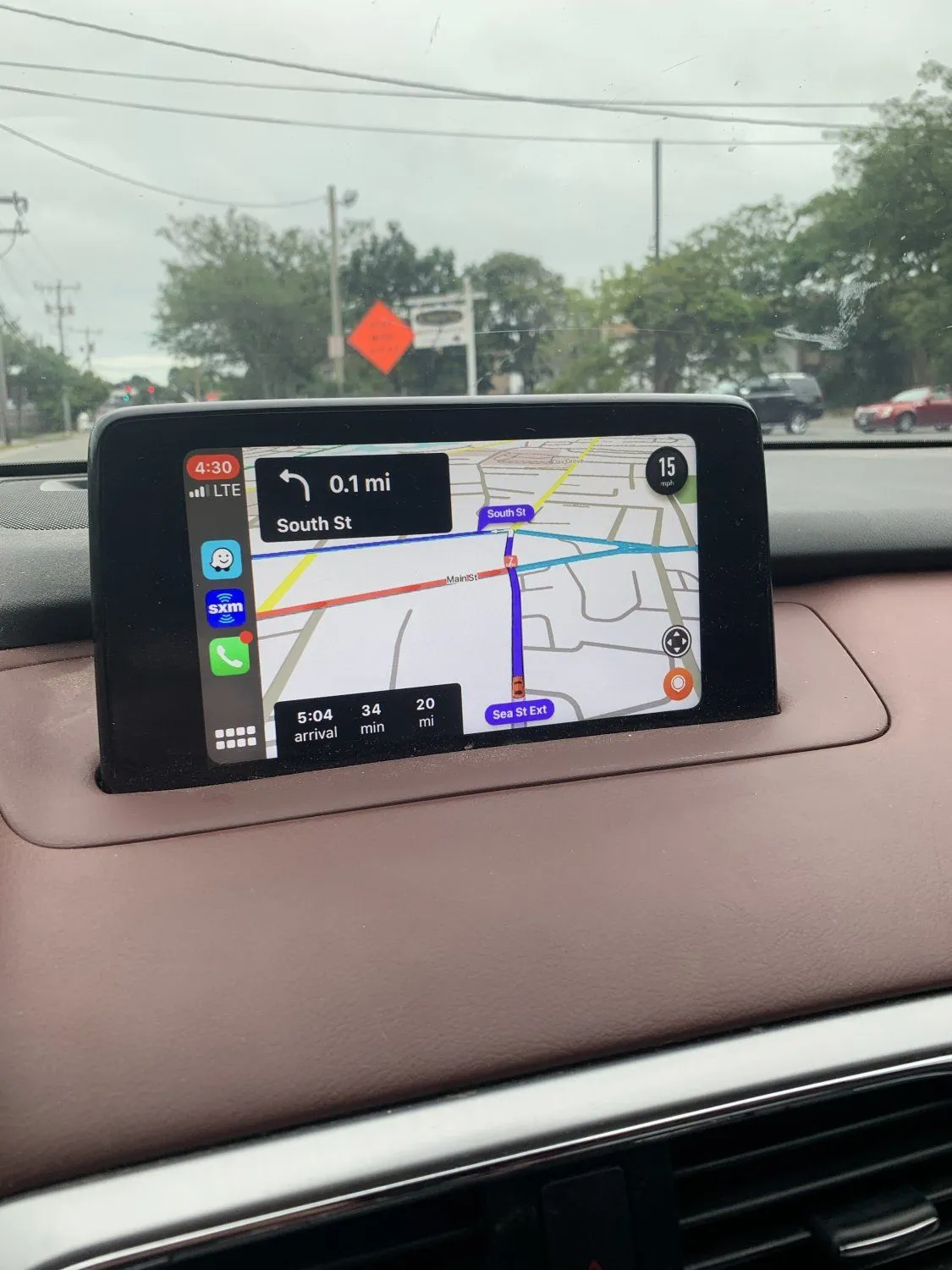

I just did it at the dealer - car was in there for a couple other things so I had them do it as well. It was 199 + 229 for the labor (cape cod). I probably could have done it myself I’m sure but splurged so it’s warrantied.
