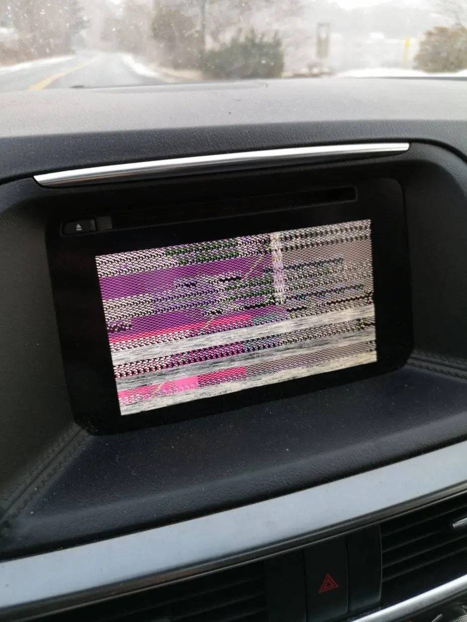

Hi all,
I am having quite an issue with my infotainment screen and it has been determined that it is a hardware issue, I am past the manufacturers warranty now so the dealer quoted me around $2000 to replace it ($1700 something for the part then $114 + tax for install). I even called Mazda Canada hoping that they would help some and was also told the same thing - I'm on my own because the warranty has expired.
So due to that price I am considering a aftermarket unit.
I am posting wondering if anyone has done this, and what was your experience with it? what ones do you recommend? what exactly do I look for in a aftermarket one?
I would like to retain current features like the car settings, phone, radio, maps etc
I found a site called crutchfield.ca but there are so many there I'm not really sure what to look for.
After the holiday weekend I also plan on calling local junk yards to see if there are any there, would one fit from any first gen CX-5, 2013-16?
I had posted about it once before here.. https://www.mazdaforum.com/forum/ma...tainment-screen-goes-black-reboots-too-46588/

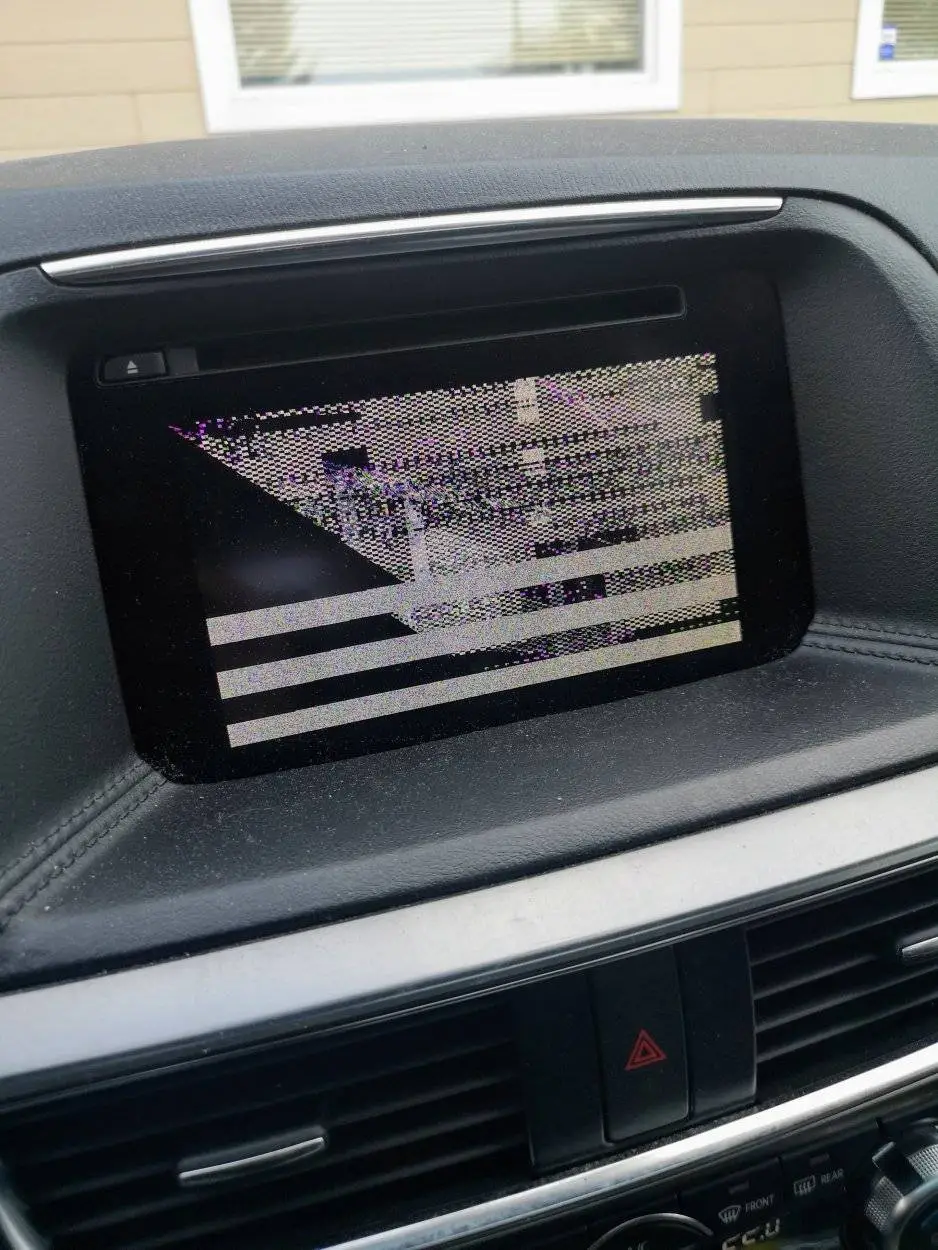

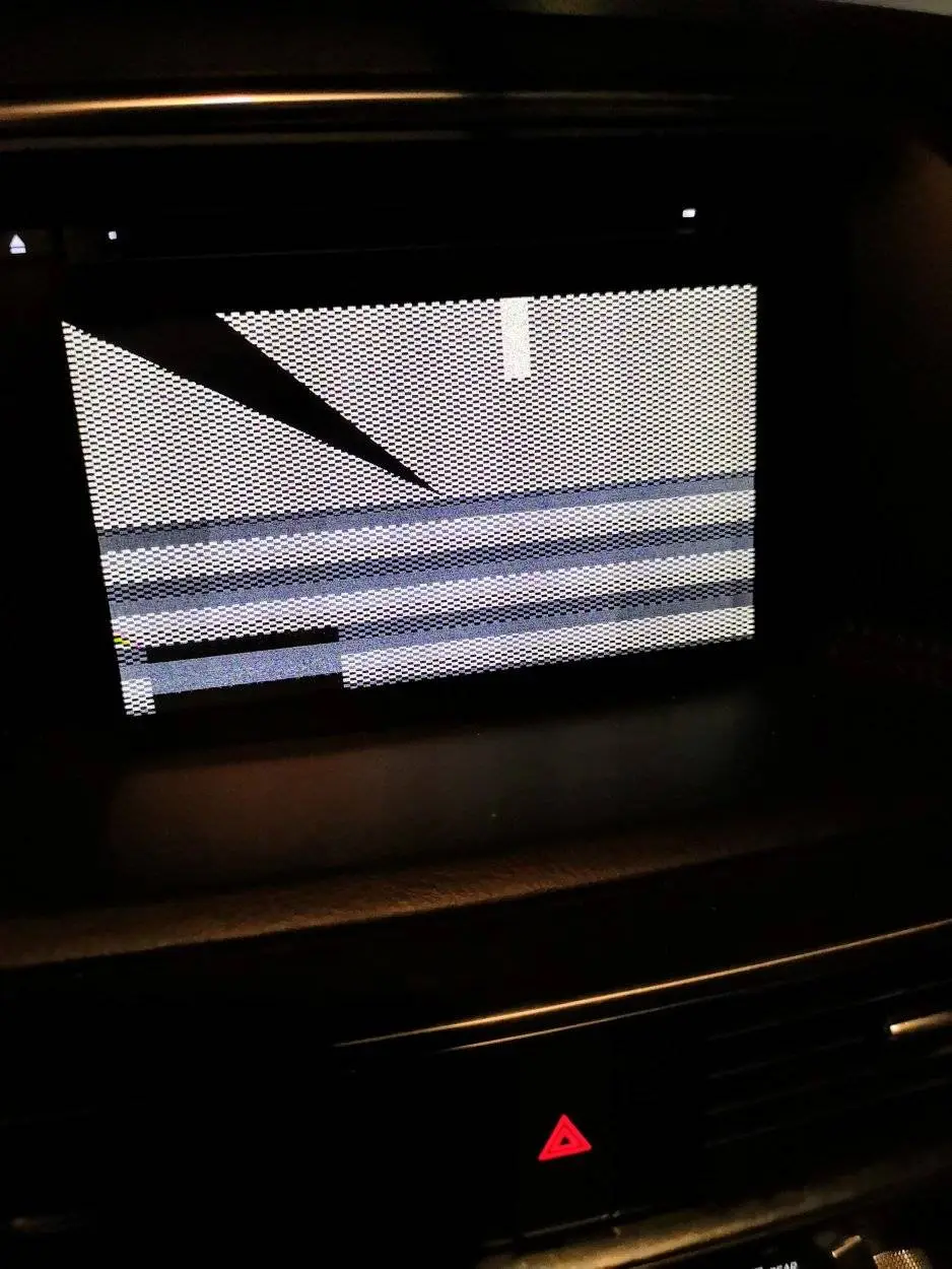

It's no longer just distorted, I currently have no use of my screen, except sometimes it will work clearly (back-up camera) when in reverse.
I have the maps SD card out and the issue is still present.
The software is on a almost constant reboot cycle, restarting every 45-60 seconds. The dealer said that the OS is up to date.
This makes me wonder if the problem could just be a bad cable connection between the display and the component that controls it. I don't know what's involved but it might be worth doing whatever disassembly is necessary to get to the connections and then disconnect them and clean with a good contact cleaner. I would attempt this before getting a used replacement for the screen.

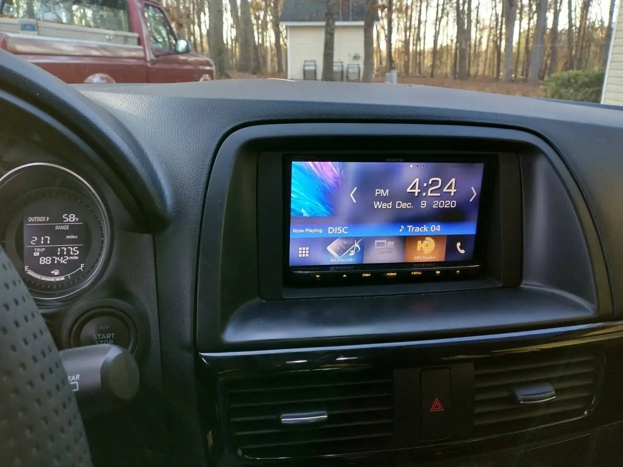

I have a Kenwood DDX8905S in mine. When used to the iDataLink Maestro RR, it retains all of the steering wheel controls, plus you can customize the buttons to have a second function that you choose when you press and hold. And the coolest thing, you can actually get real gauges like coolant temp instead of just an idiot light!
The deck has everything you could want: CarPlay, Android Auto, HD Radio, DVD, backup camera input, nearly unlimited songs via USB that reads FLAC and even DSD. It's a really terrific deck.

Mine is a first gen 2013. My original radio had marks on the screen from where the same buttons had been pushed over and over, and besides, it wasn't all that great to begin with. I knew I wanted to do a full sound quality install, and when I saw my deck on sale, along with all the extra features, I just pulled the trigger. Couldn't be happier!

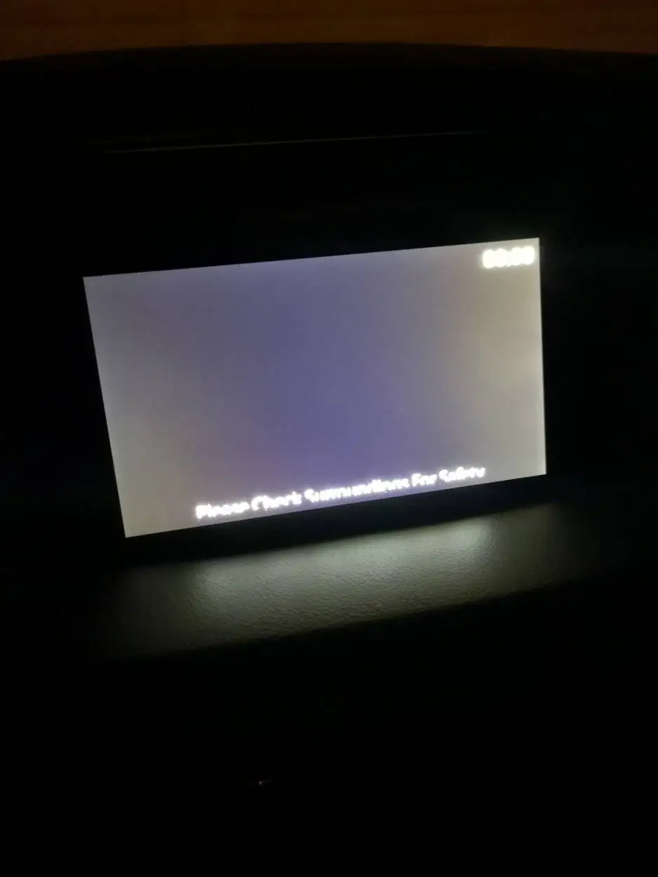

Two days ago my screen started to work again, and it stayed working every time I turned my vehicle on again, then yesterday afternoon I decided to put my new maps SD card in (I had previously bought a new one off Amazon, heard of them going corrupt etc), and then turned it on and right away my screen was back to being distorted and mostly black again, ugh.
Could it be a faulty or dirty card reader causing my infotainment screen / software to mess up?

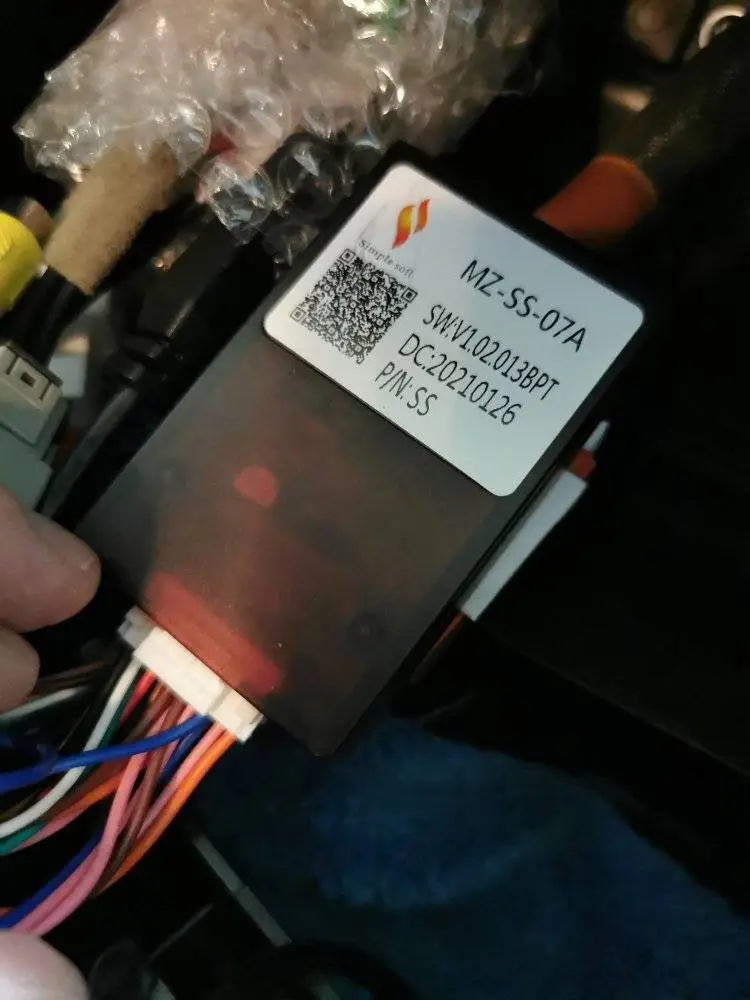

Hi all.
The issue got worst and I only had a black screen, having the radio only (but couldn't change stations or anything, only volume), but I recently had to change the battery and that reset it to God only knows what station because I only had static after that

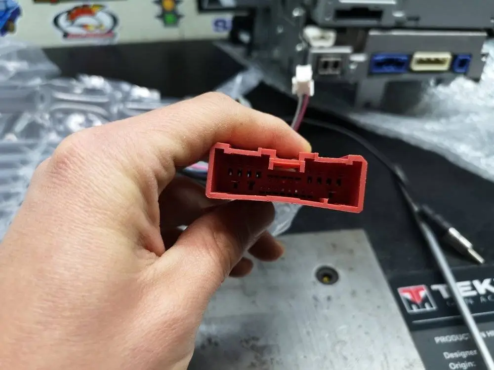

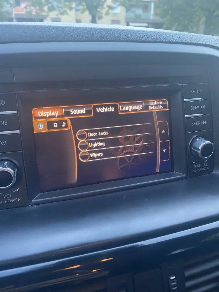

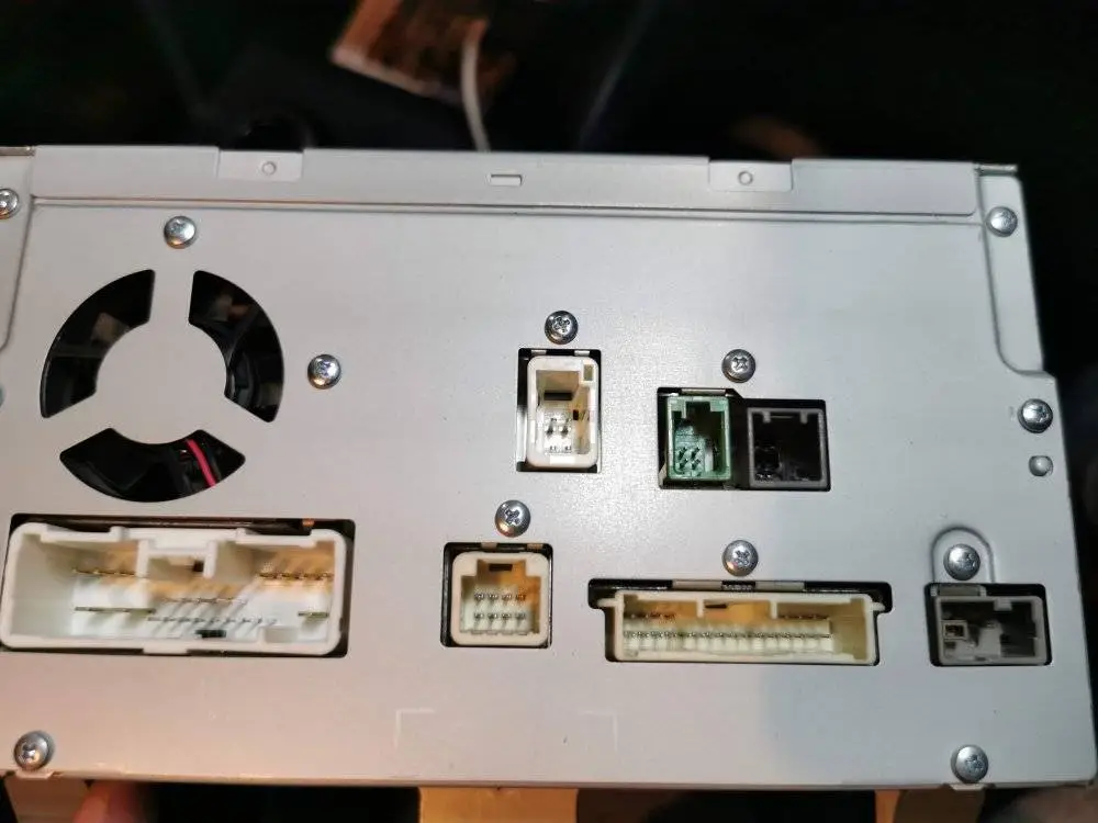

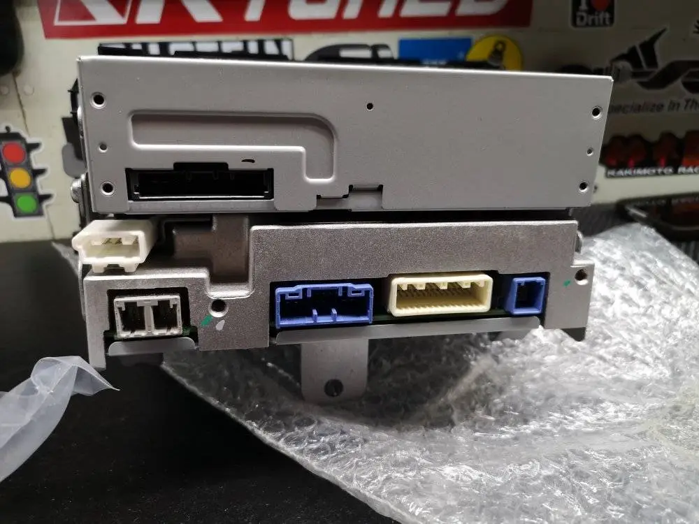

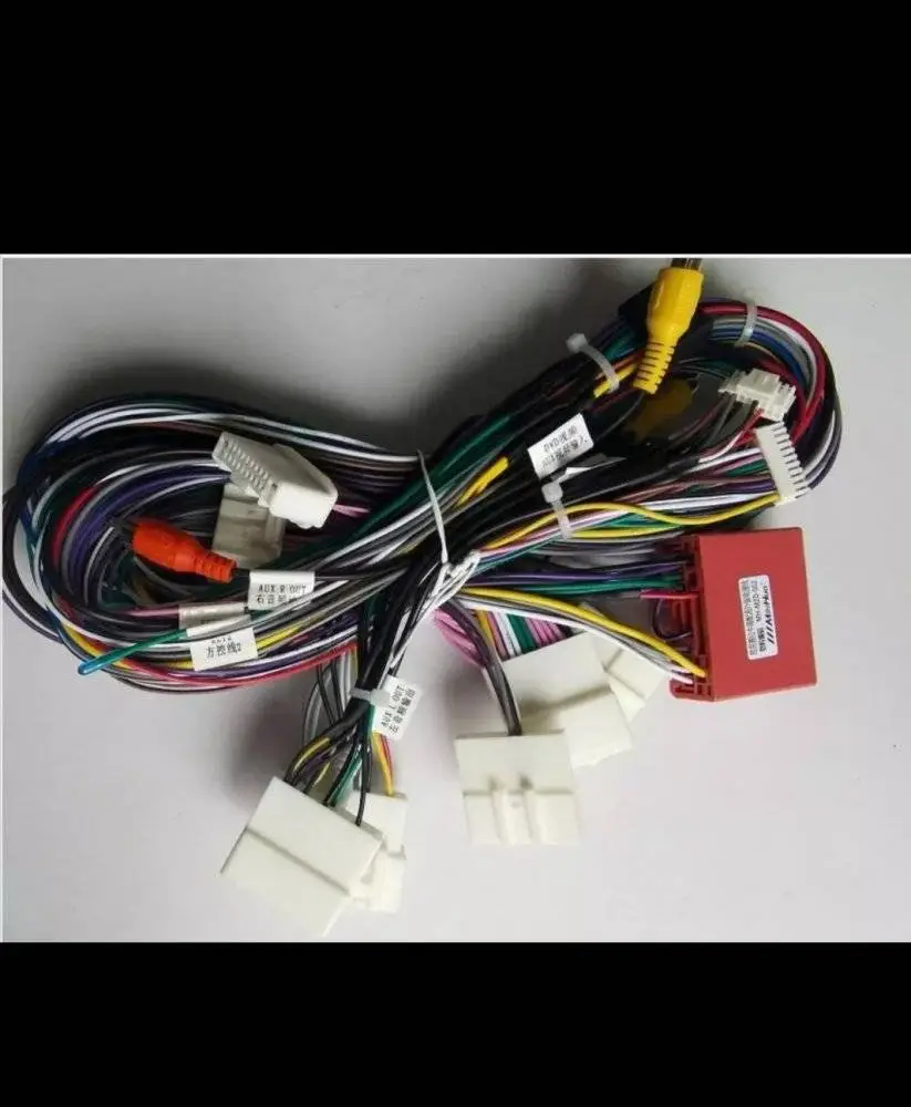

So I finally purchased a aftermarket one, an Android one from AliExpress (129.37C$ 32% OFF|IPS 1280*720 4G LTE Android 10 6+128G for Mazda CX5 2012 2017 Multimedia Stereo Car DVD Player Navigation GPS Radio Carplay AUTO|Car Multimedia Player| - AliExpress). They sent me a Canbus too so it was supposed to allow it to hook up, however the Canbus was not the right connector. I contacted the seller and after checking with their engineer they said that I need another wiring kit but it had to be bought separately for almost $100 (with shipping), seems kinda high for wiring so I wanted to check with you guys and see your opinions and maybe someone would recognize that wiring kit that I might be able to get more local (quicker and maybe cheaper).
The 1st picture (if it uploads in the same order, showing red connector) is the Canbus (can visually see that it doesn't fit)
The 2nd picture is what the back of my unit looks like.
The 3rd picture is what they said that I need.

Those "pure Android" units are GARBAGE. Oh, the idea behind them is amazing. But in practice, trash. Ever tried to use a $30 Wish tablet? Because unfortunately that's pretty much exactly what they are.
Upvote 0
Yea, I gotta' agree with Blooms. For something as important as your in dash audio system... you should get a quality name brand.
Upvote 0

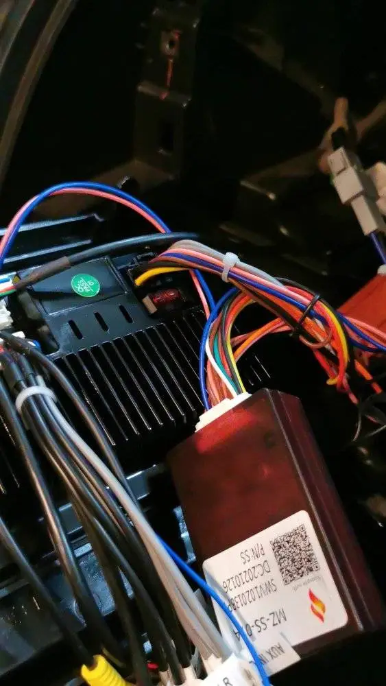

Hi jswinimer:
I may be able to help you. I own a 2013 (first gen) base model Mazda CX5 (Canadian Version). My infotainment unit works fine but has the common issue with Bluetooth. I recently purchased a similar unit (first picture) from Aliexpress 210.02C$ 50% OFF|Carplay 8G+128G Android 11 Car Radio For Mazda CX 5 CX5 2012 2013 2014 2015 4G LTE GPS Multimedia video Player 2Din 360 Camera|Car Multimedia Player| - AliExpress. I took a picture of my original unit and the seller suggested that I also purchase a canbus (the red transparant box). Based on the photos you shared, I only see the cables but not the actual box (it's literally a plastic box, see my photo). The red plastic connector is where you plug in the main connector from your car's existing wiring (the one that plugs in the biggest plug on your original unit). One of the white plugs goes into the canbus box (see my photo). Apparently, with the older CX5 you'll need the Canbus box in order to communicate with the new unit. I was skeptical at first but I'm glad I did spend the extra as they suggested. The seller helped me with the installation as well. I'm very unfamiliar with car stuff so I read a lot of posts on this forum and checked out a bunch of youtube videos. Finally after two days of messing around I was able to install the unit and add a reverse camera to my old CX5. Now I have a 10 inch console with wireless carplay and android auto. It's really nice.
Hope this information helps. Good luck with your installation.
