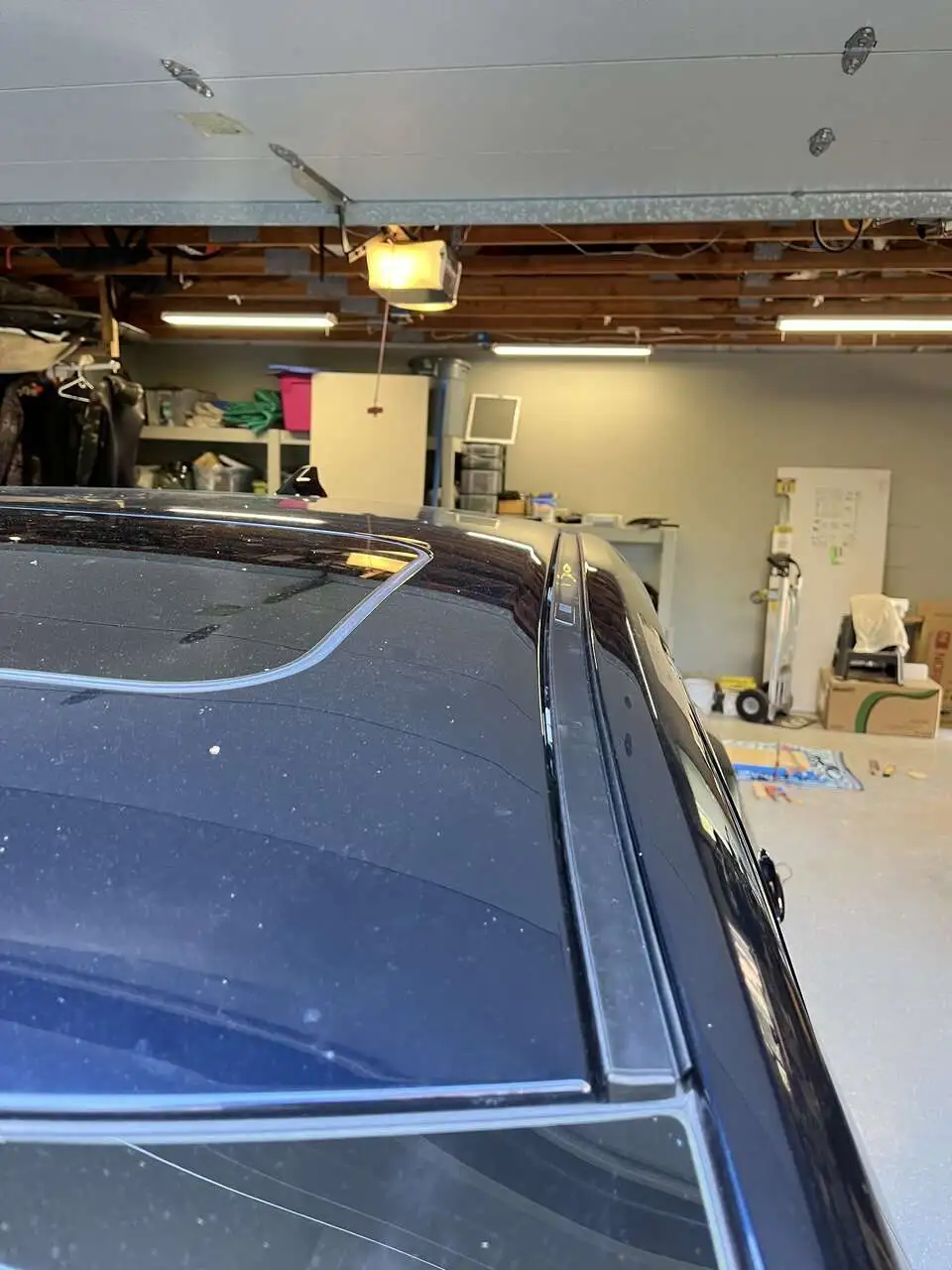

My 2021 CX-5 came equipped with the silver roof rails and I am looking to replace them with the plain black roof moulding. I purchased the replacement trim pieces from here: LINK and attempted to install it today. I removed one side and tried to fit the replacement trim piece into the channel and it was too narrow for the channel and didn't 'fill' the gap so-to-speak. I checked the website from where I ordered and it says the part is for 2017-2020. Although there are other sites selling the same part(number) and advertising it as 2017-2021 HERE . So now I don't know what to believe, do I in fact have the wrong part or am I just not installing it correctly/missing additional parts needed for the job. I can't be the only one that has removed the roof rails and installed the roof moulding. Does anyone have experience doing this? Please help :)

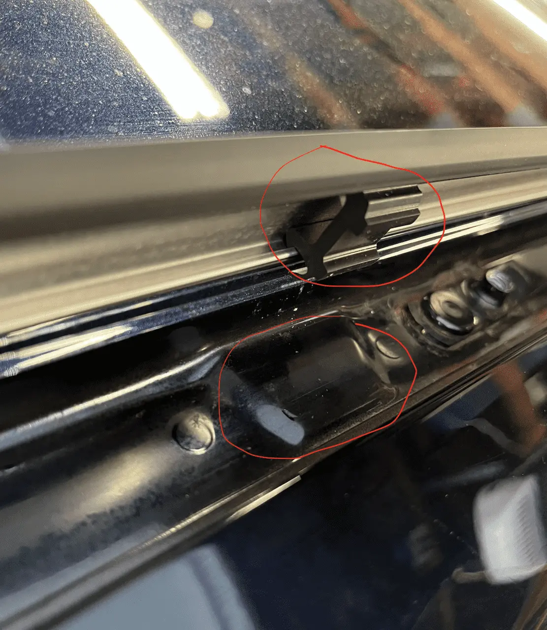

I went for install attempt #2 today. Did not go that well actually. There are two clips on each end of the roof moulding which fasten it to the roof. Other than the there are about 4 rubber 'clips' or pieces which do absolutely nothing. There seems to be a bump on the roof where maybe there should be a piece they slide into or something but there is nothing there. So with nothing but the two end clips holding it down the moulding piece wiggles a lot and does not seem secure. View attachment 313149

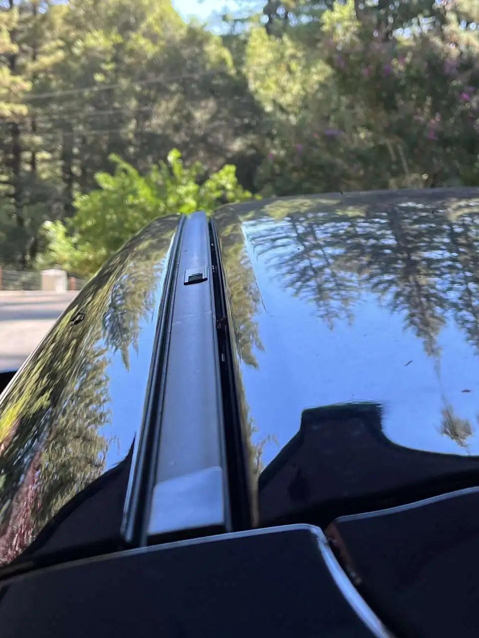

Thanks you. I have now watched every install and uninstall video of the roof rails on YouTube. A few things I learned are the 4 rubber pieces do go on top of the raised bumps in the groove. There are 3 clips attached to the roof that the mounding will clip into with enough pressure and the correct angle. There’s also two different clips at each end of the mounding you will need to clip into. When you buy the mounding(with cap) it comes with everything you need in the diagram other than this clip: Clip which is basically an additional peel and stick version of the same clips that are welded onto the roof.
After all that the mounding still doesn’t seem to fit perfectly flush and you can see parts of the clips and rubber pieces.
