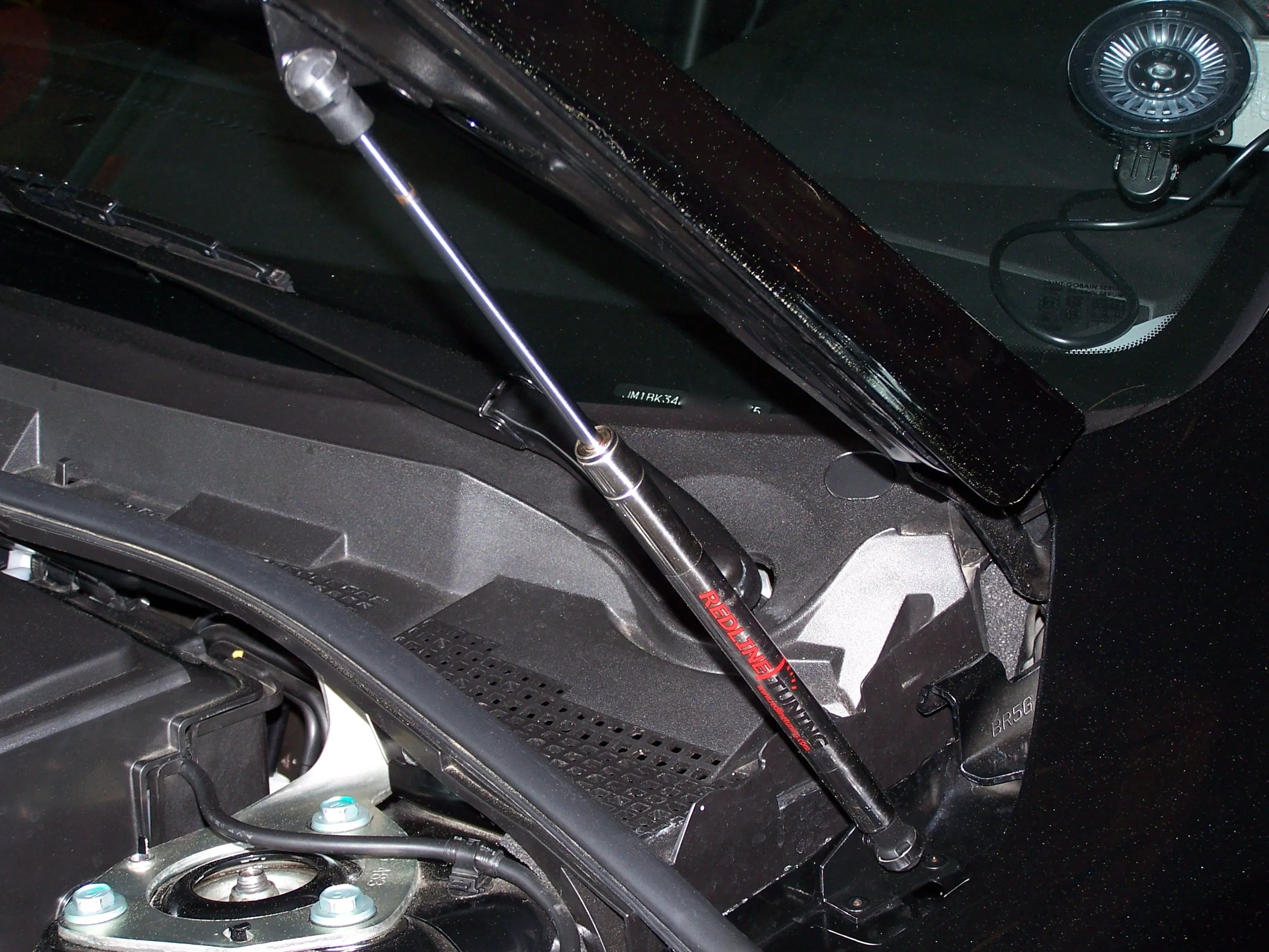

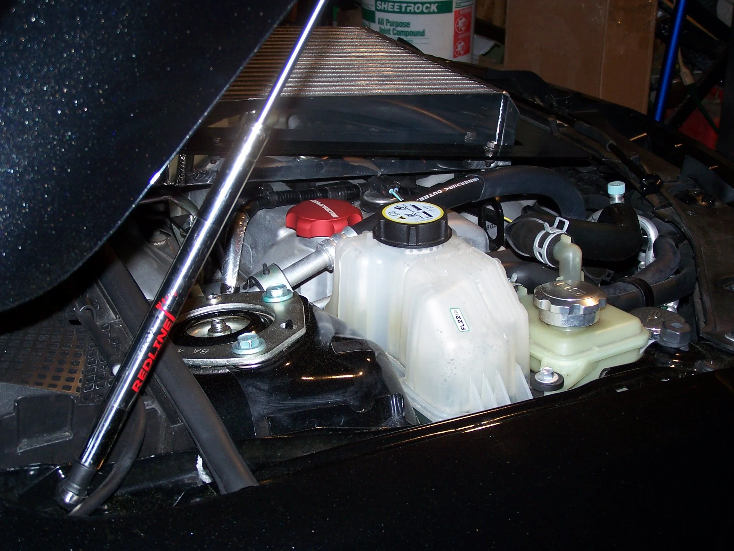

I decided I wanted to try a set of hood struts to lift the hood and hold it up without using the hood rod. I looked around a chose the Redline Elite in stainless steel. They make a set specifically for the Speed3 since the hood is heavier than the regular 3's. They give you stronger struts (A8's).
I was a bit skeptical that they would work, but they made me a believer. They do work, and work very well so far. I just put them on today.
The directions were very good, easy to understand---even for me. I had no problems and they went on with no issues. I did however, borrow an angled drill from my neighbor to drill the fender holes. It made the job easier since it was a tight space to work in.
All in all I'd recommend these to anyone that wants to add a little bling to the engine bay.

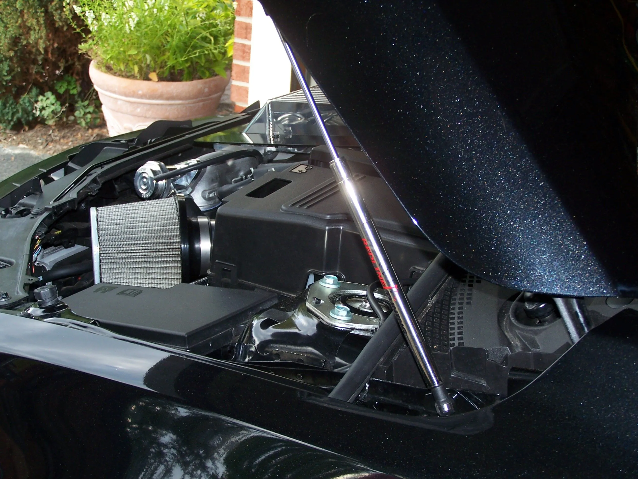

Looks good. After looking at the third pic (I could be wrong), but it looks like the washer hose may be pinched a bit from the strut resting on top of it when the hood is closed. You might want to run it on the other side of the strut and tie it down out of the way, if that's the case. After a while of opening and closing your hood, the strut may wear a whole in the hose. It might not be that big of a concern, but I thought I should mention it.

You are right, the hose does seem to be in the way. I hit the wind shield washers, and they work just fine. I still think I'll try to reroute the hose a little bit just to make sure it doesn't wear.
Good eye and thanks for the suggestion.

I tied back my washer hose to keep it from getting pinched, and it did anyway. The rear washer worked, but the windshield washer only worked with the hood up, so I just cut the tie-wrap. (hand)
