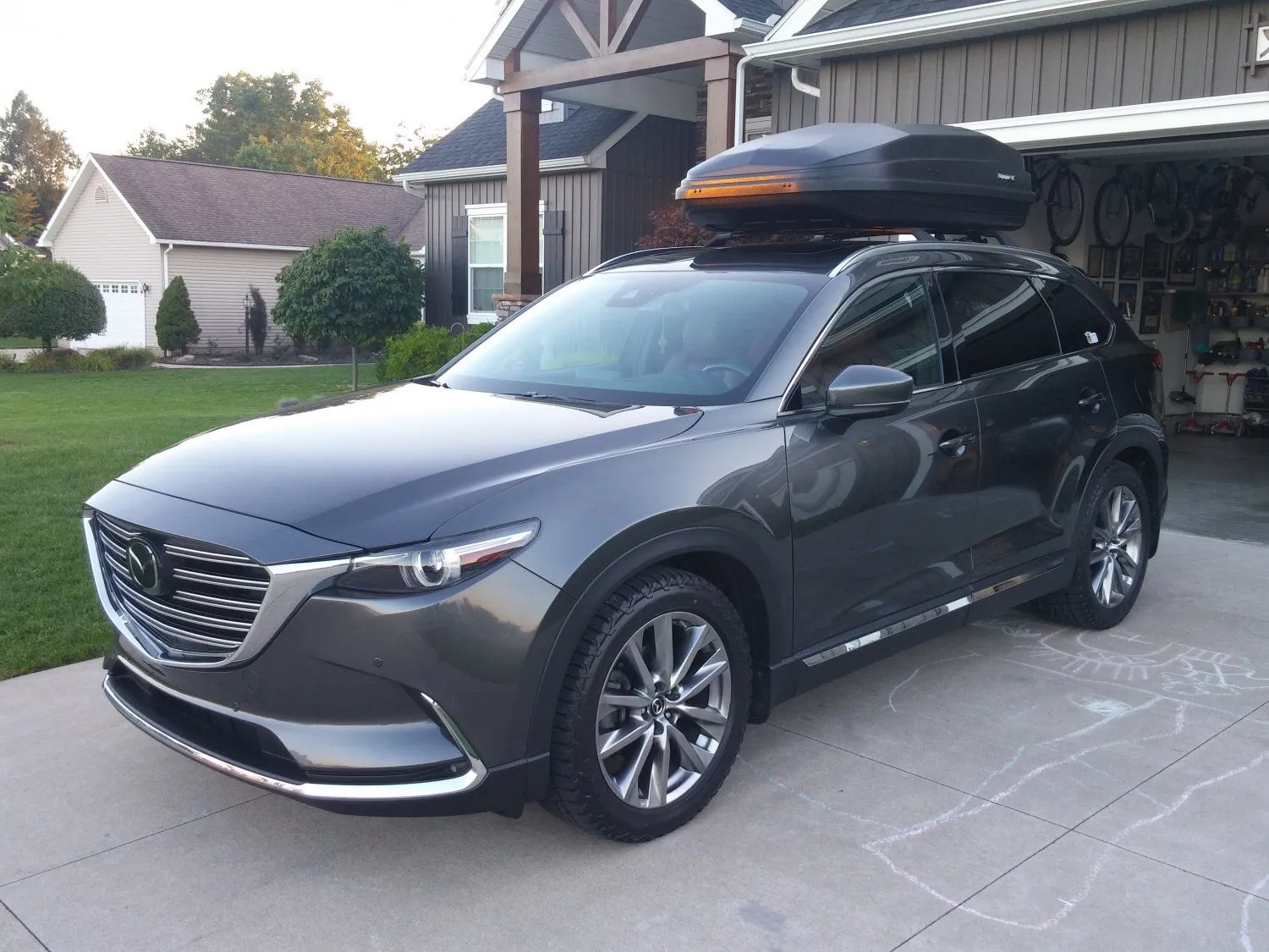

Bought a used but in great condition roof top carrier for $80, basically a Vista Sportrack XL (made by Thule) but mine was a branded version sold at Pep Boys, as there was no way to fit all our stuff in the CX-9. The three suit cases and backpacks, food/drinks where all in the 2nd and 3rd rows (we had 2 kids in the middle row outboard seats, and one in the 3rd row passenger side), and everything else in the cargo box. The carrier fit the factory roof rack very well, the the size was great at 18 cuft. Fit within the rails and roof length just right. The mounts themselves were crude, just u bolts that have twist nuts inside the carrier. I wrapped the roof rack cross bars with 2 layers of Gorilla duct tape to prevent the ubolts from damaging it, and it work good. Loading was a little tough, it opens from the rear, but Im 6'2" so could just reach up and place stuff in, then strep on the rear tire to move stuff around inside the carrier. The relatively low roof line of the CX-9 helps. Wind noise was minimal

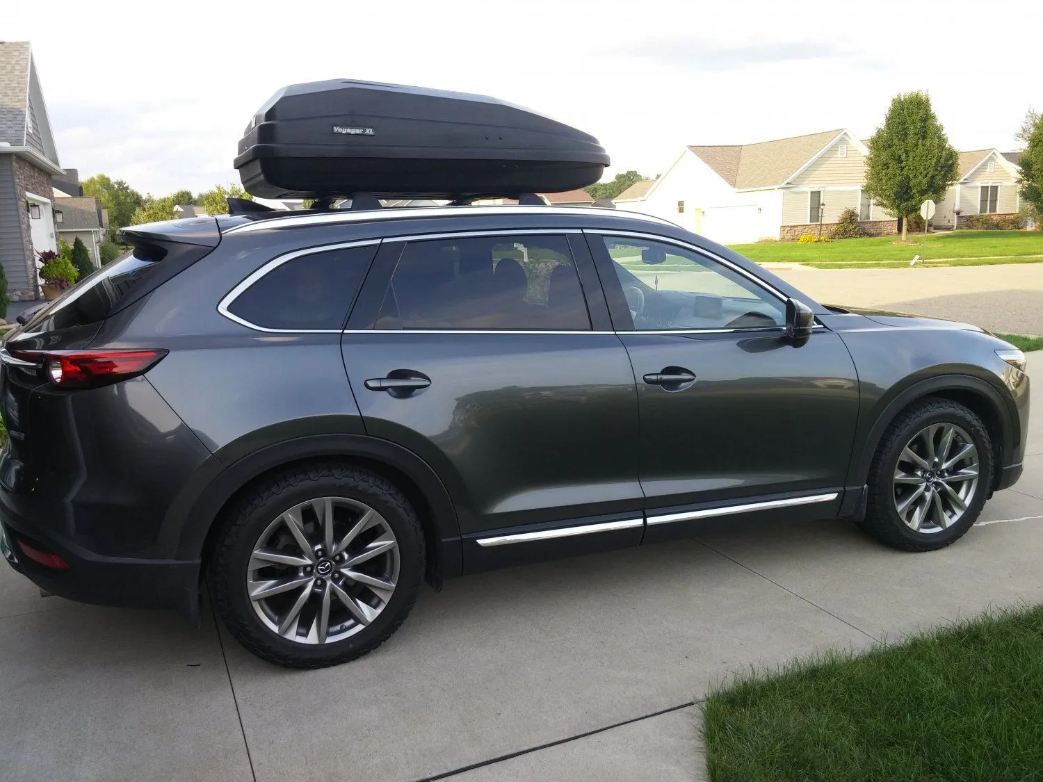

Power was a non issue through the mountains, and the handling was just ok (not the normal great ride and handling we are used to around town, etc).........mainly due to one issue, the rear end sag. I didn't actually measure the rear sag, but with all our stuff in and all of us in it (the 900 or so lbs), the rear sag was noticeable (see pic) visually and when driving. There was what I call a porpoising, like on a boat, due to the rear biased load and sag. I didn't happen most of the time, rather only over undulating stretches of road, and over bumpy roads. I just felt like the front end was pointed up and the front sag and softness induced at the rear, cause the car to porpoise.
I would guess the rear sat a good 1/2" to 1" lower maybe (see pic close up rear). This wasn't terrible by any means, just maybe worse than I expected, based on our previous and current SUV's. And I think some of this of course is a compromise of the great handling vs load / towing capacity the designers had to make with the CX-9, and based on the chassis being more geared towards on road performance.

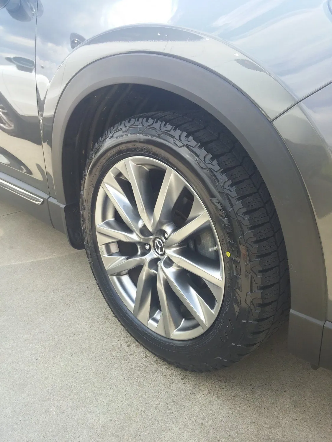

Had new tires for the trip also, 255/50R20 Falken Wildpeak AT trails, and they are great. Ride, handling, impacts, response, traction are all better than the pathetic OE Bridgestone's. Will have to see how snow and wear are in time. They are 3 peak mountain snowflake and have a 65k treadwear warranty, so I am sure they will hold up better than the OE tires. Noise is unbelievably good, especially when you consider the appearance and the fact they are AT tires with 3 peak mountain snow flake rating. very slight noise increase, that's hardly noticeable. I attribute a good chunk to our CX-9s excellent cabin noise attenuation. The look of these is the other reason I bought them, wanted to add a bit of ruggedness to the civilized CX-9. They have an aggressive upper shoulder, pattern, and cool sidewall lettering. Tread width is also wider so they look better especially on our wider than normal 8.5" wide OE wheels. Fuel Economy I'm sure took a hit a bit, but I don't care, maybe 1 mpg or so.

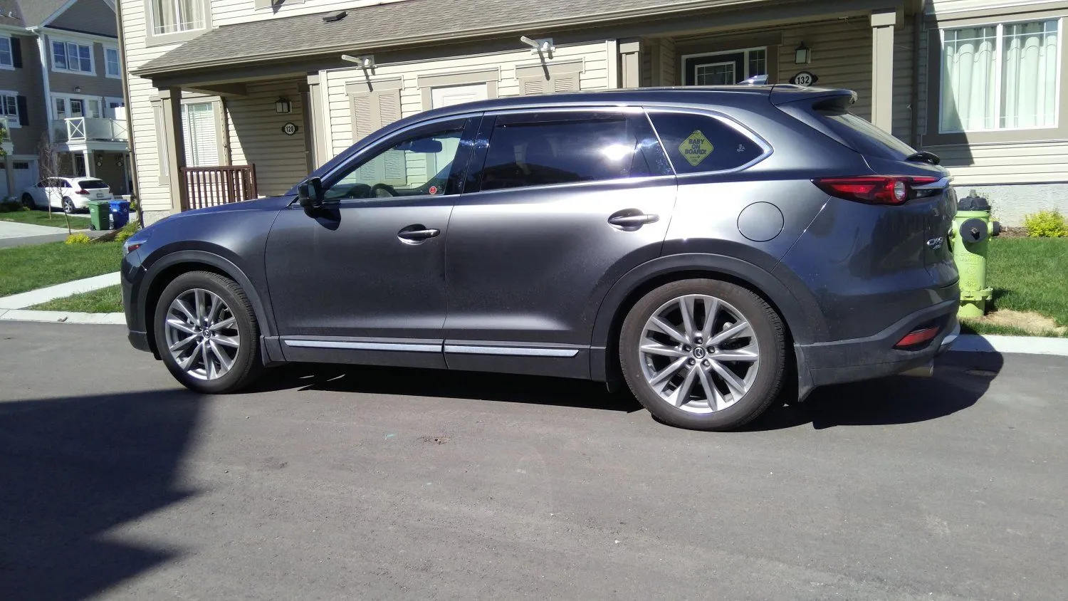

On a related note, when I moved from one province to another, I loaded my CX-9 down with about 950+lbs of weight plates and other gear, plus my wife and baby. I never had any of the issues you described with porpoising, but to be fair the roads were very smooth and the drive was pretty straightforward with few hills and curves.
Thanks sm1ke, thats about what mine looked liked loaded up.
