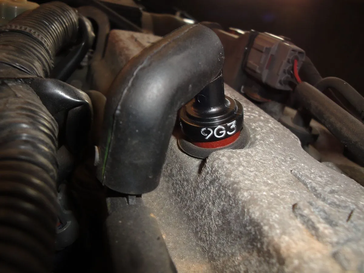

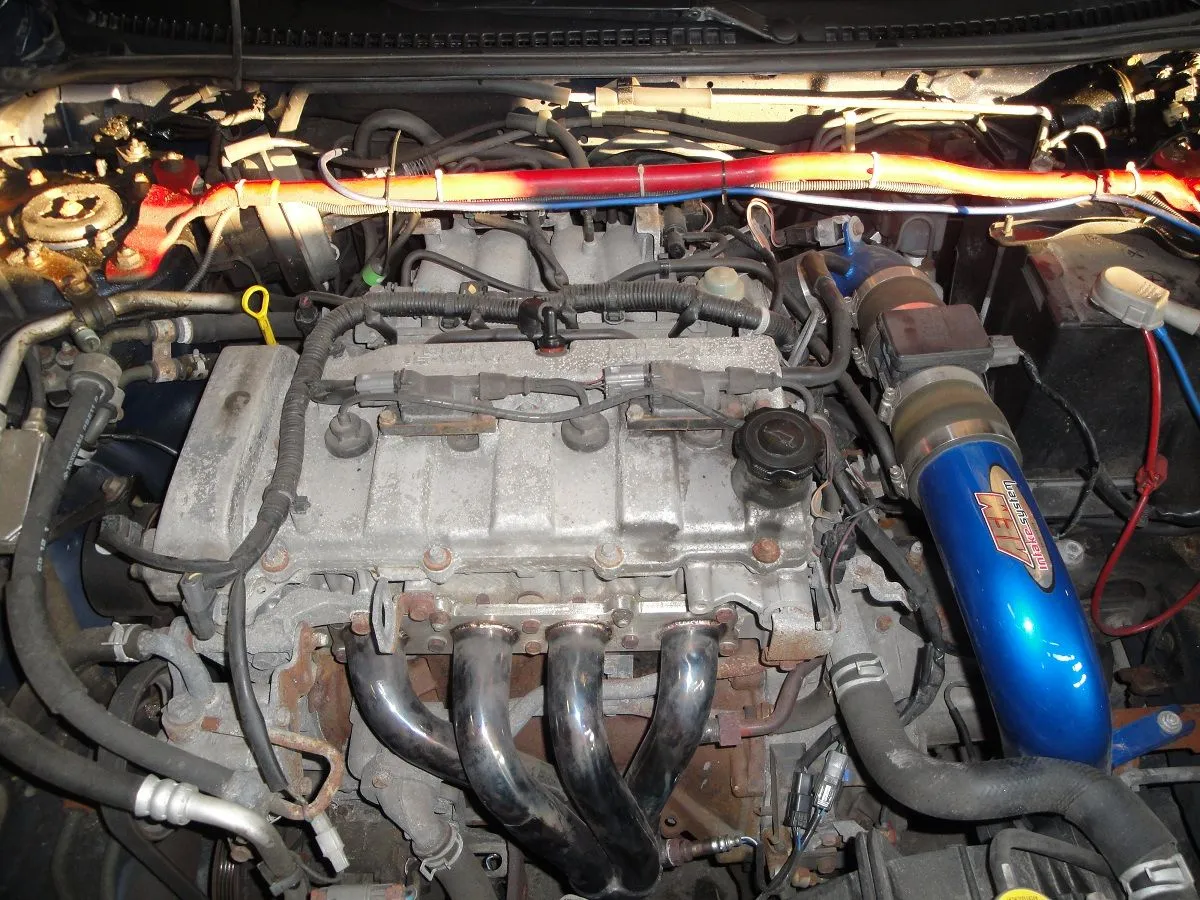

Hey Guys, just to let you know... I didn't calculate right cause I'm using KM not miles... I've done 1200 miles so far, not smoking at startup anymore and I've installed the PCV Valve from the millenia here's what it looks like
"Yeah sorry those two and a half quarts I added must've missed the hole on the valve cover, my mistake."
