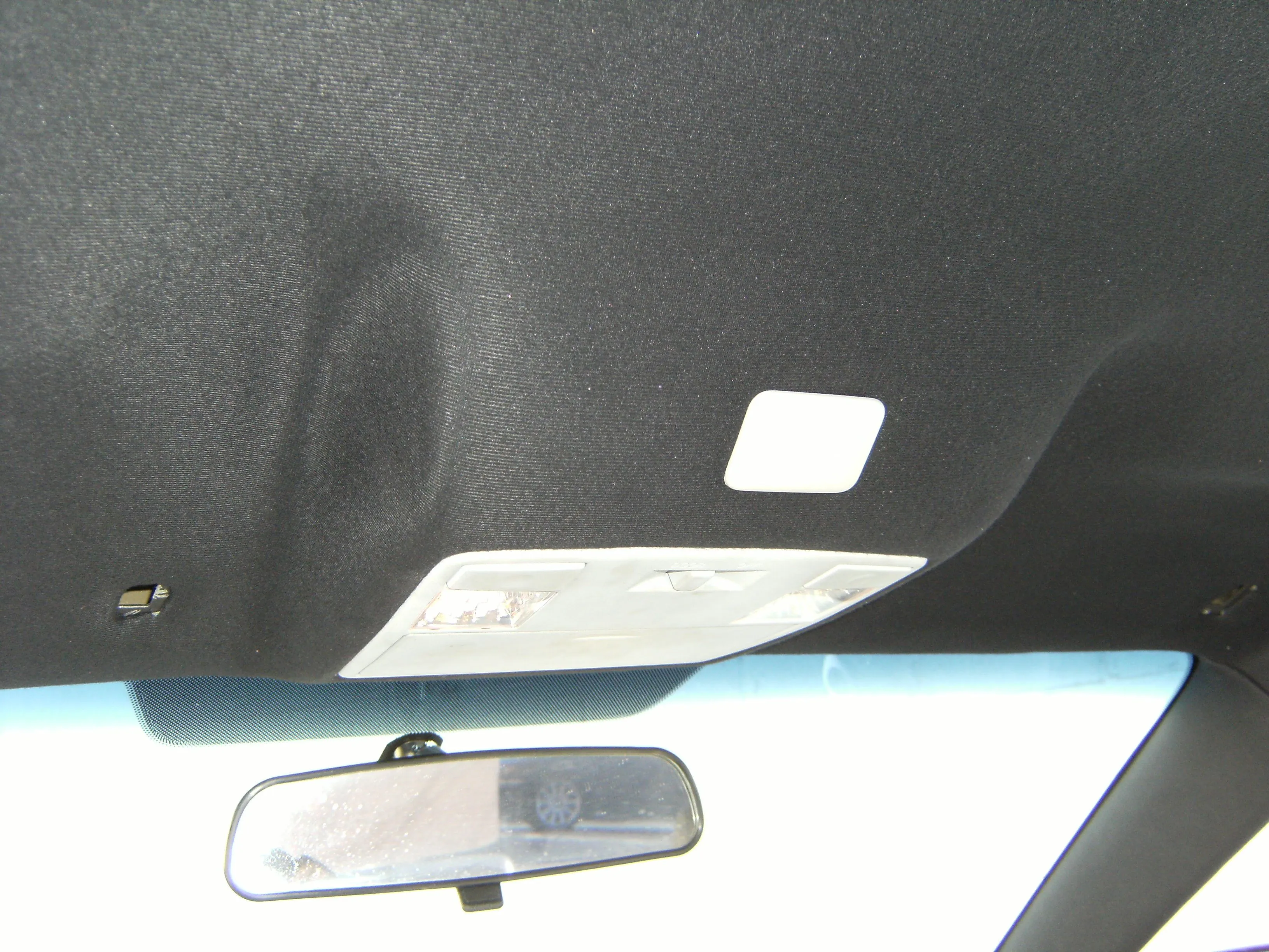

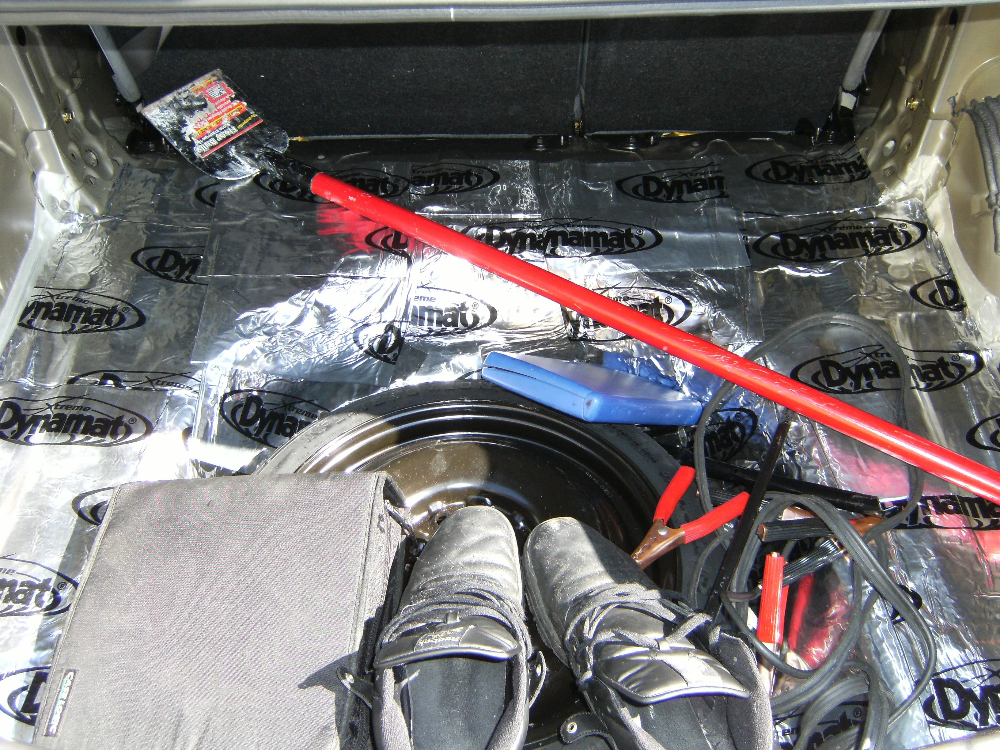

If you are reading this you know I did not trade in my 6s for a speed. Way to much for the monthly and i'm upside down like a mofo. So I took that down payment money and started my build. I will post pics of every step from dynamating to fabing the trunk, kicks, other things. the build should take roughly 2 months being that I work on it once or twice a week. The only thing I am waiting for now is my camera from dell. I have already dropped the headliner, a, b , and c pillars and sent them to interior, and the roof has been dynamated. Next will be the floors and innner and outer skins of the doors. Following this will be the pre wire of the car and kick panel fab and trunk fab stay tuned. Cam should be here in 3 to 5 days per dell. I will start photos the same day I get it.

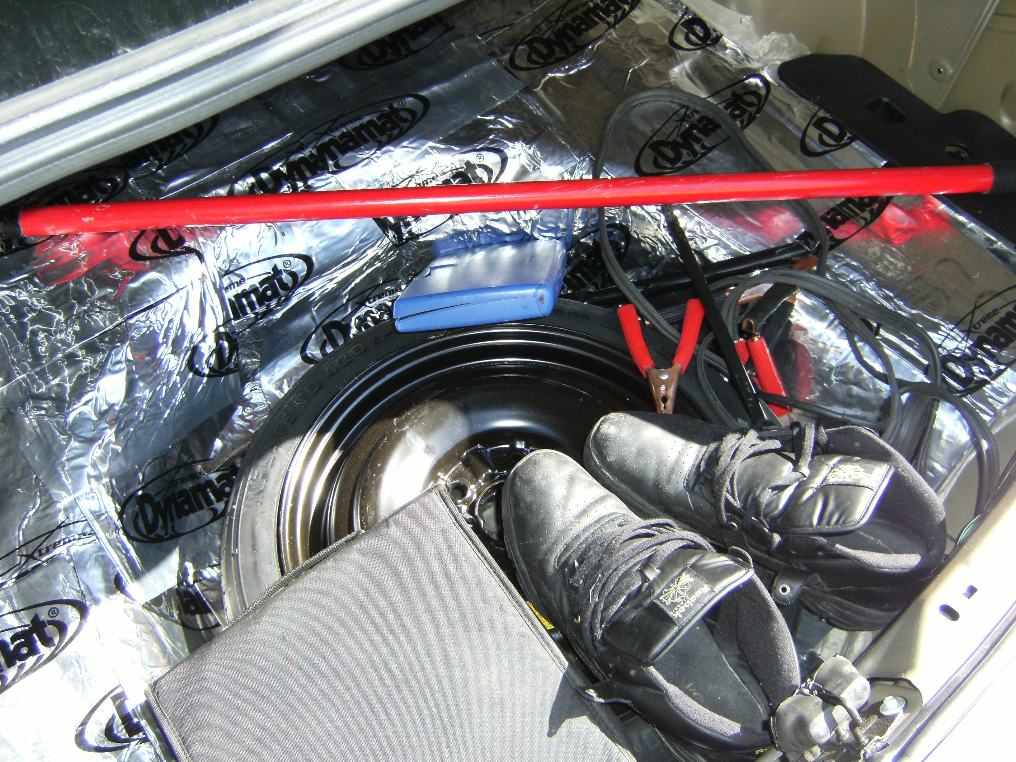

SOUND DAMPENING- DYNAMAT EXTREME 2 BULK PACKS SO FAR (roof done so far I will start the trunk on sunday or monday)

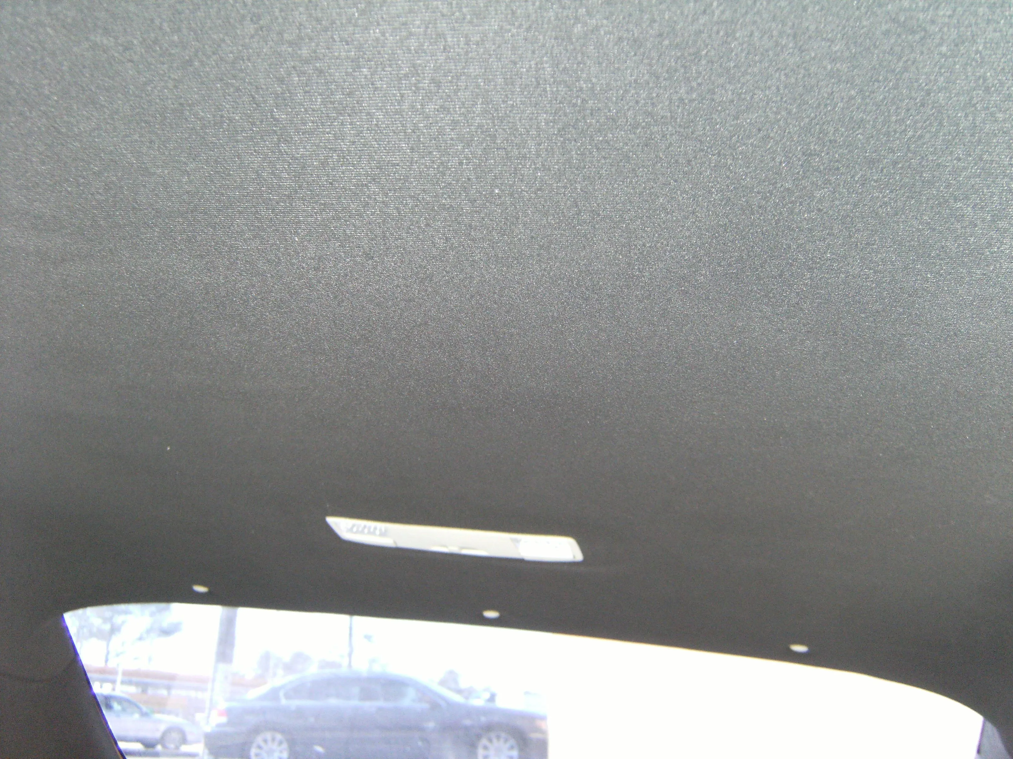

headliner redone in black

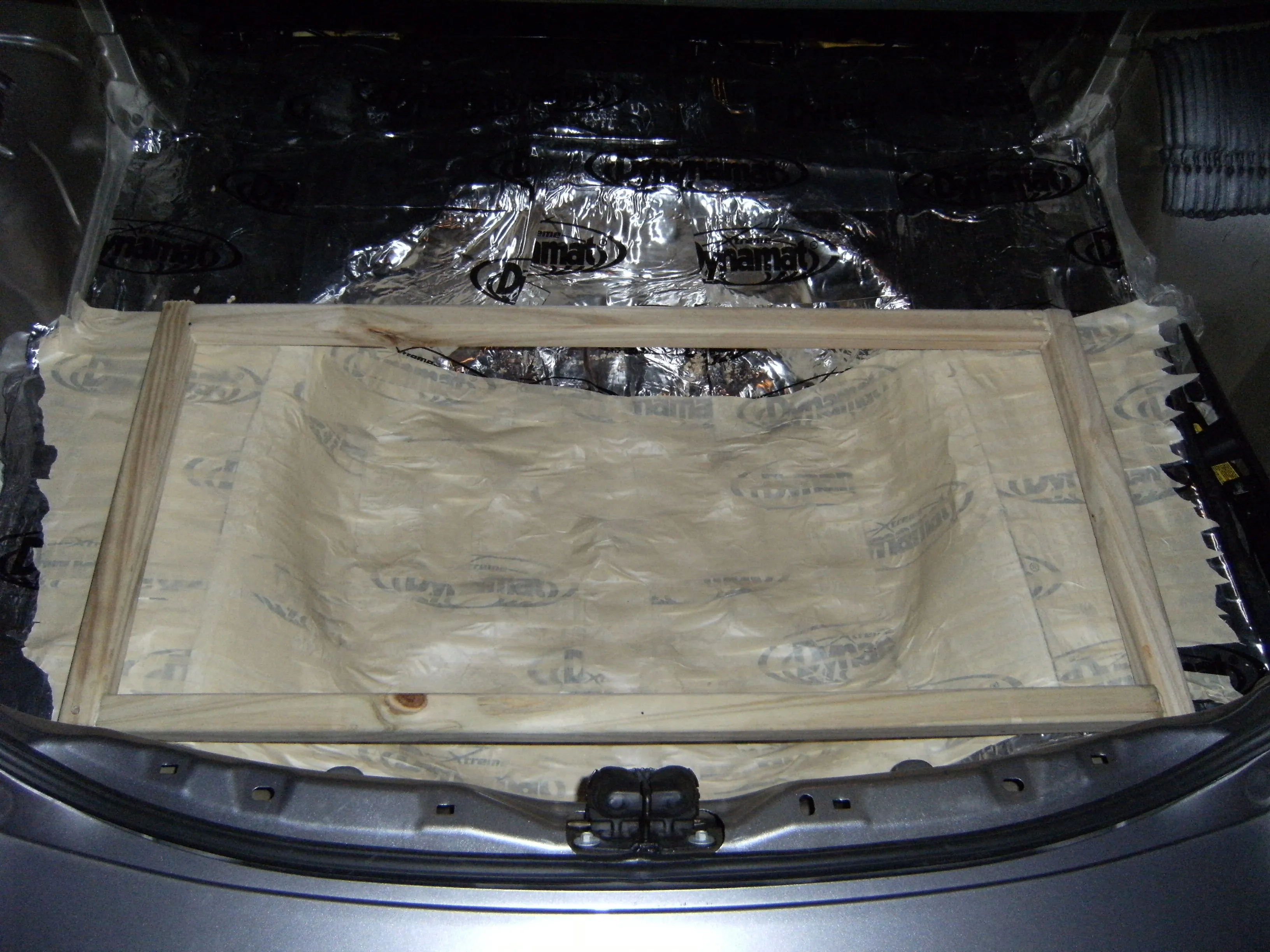

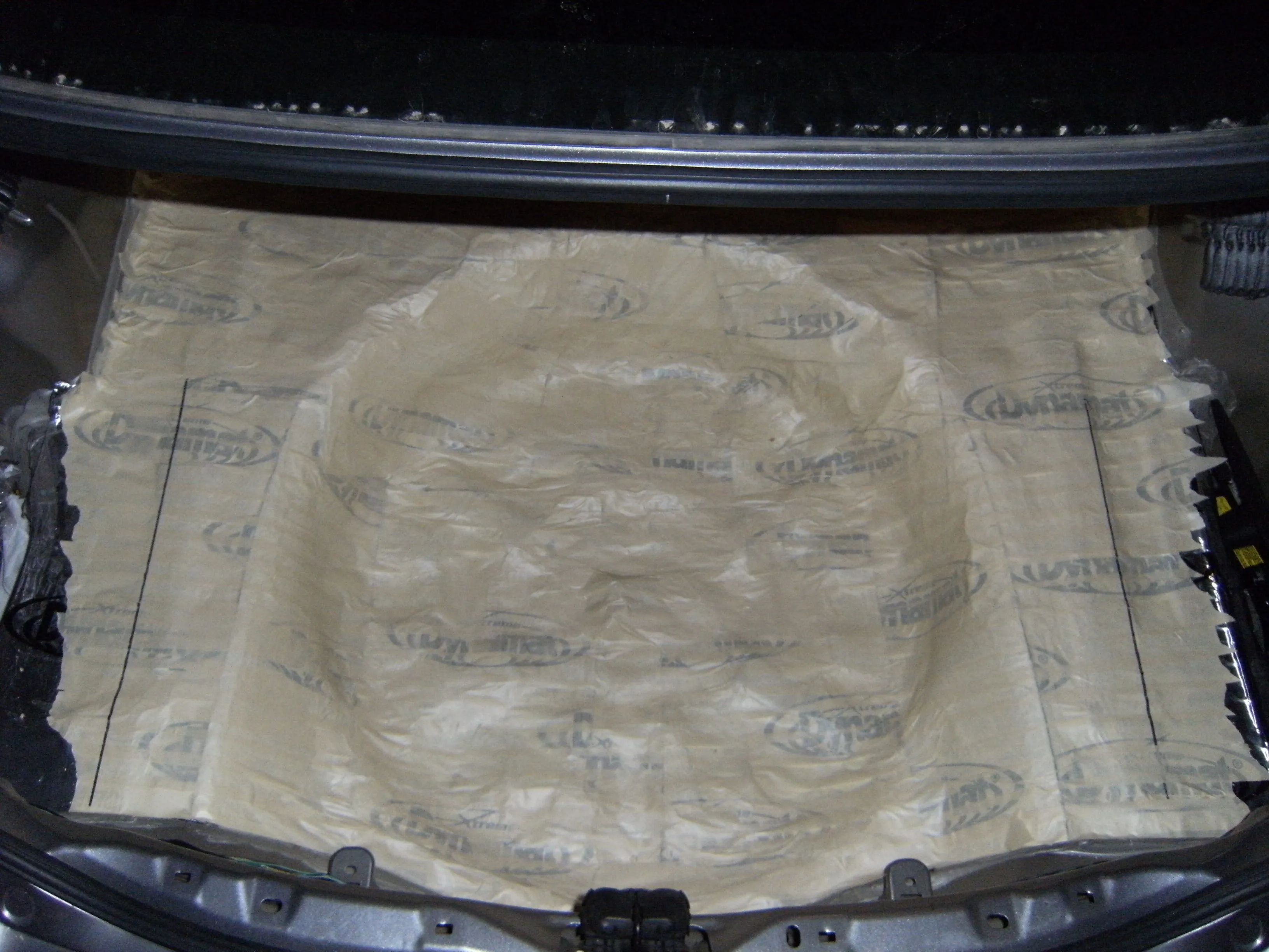

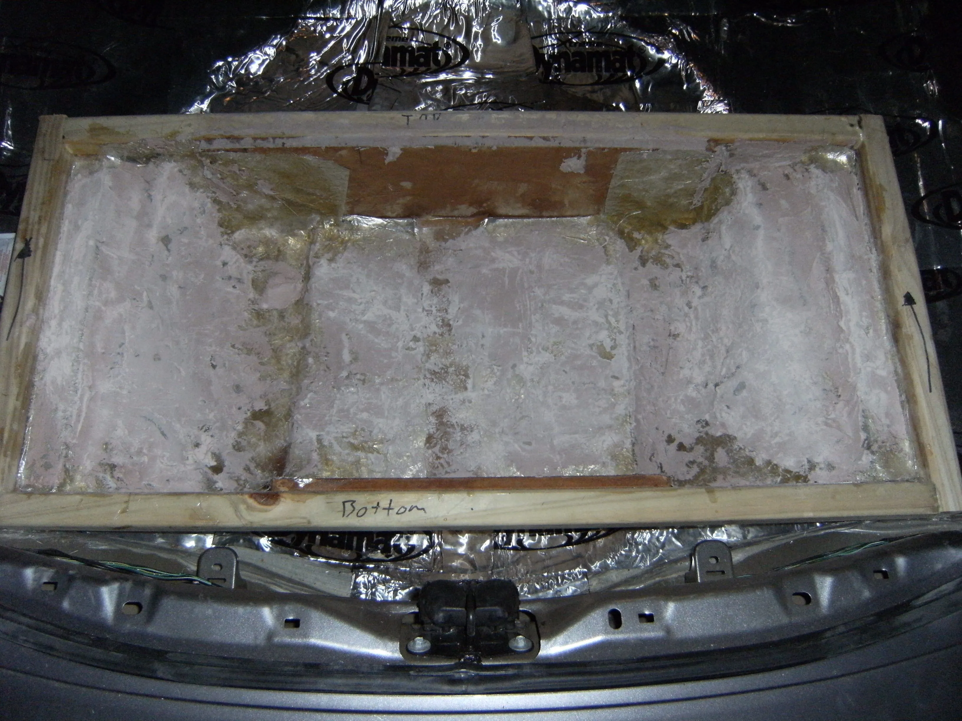

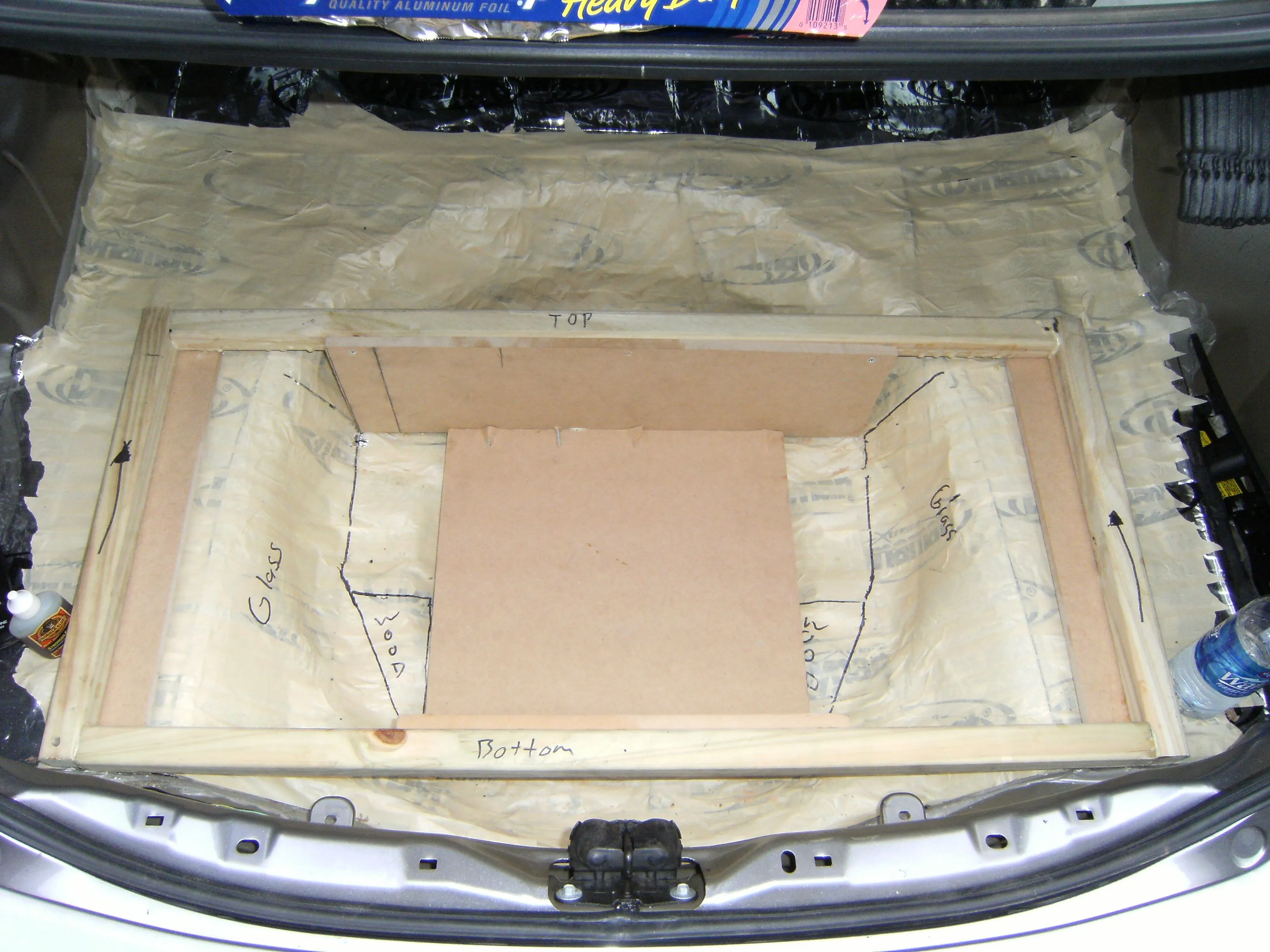

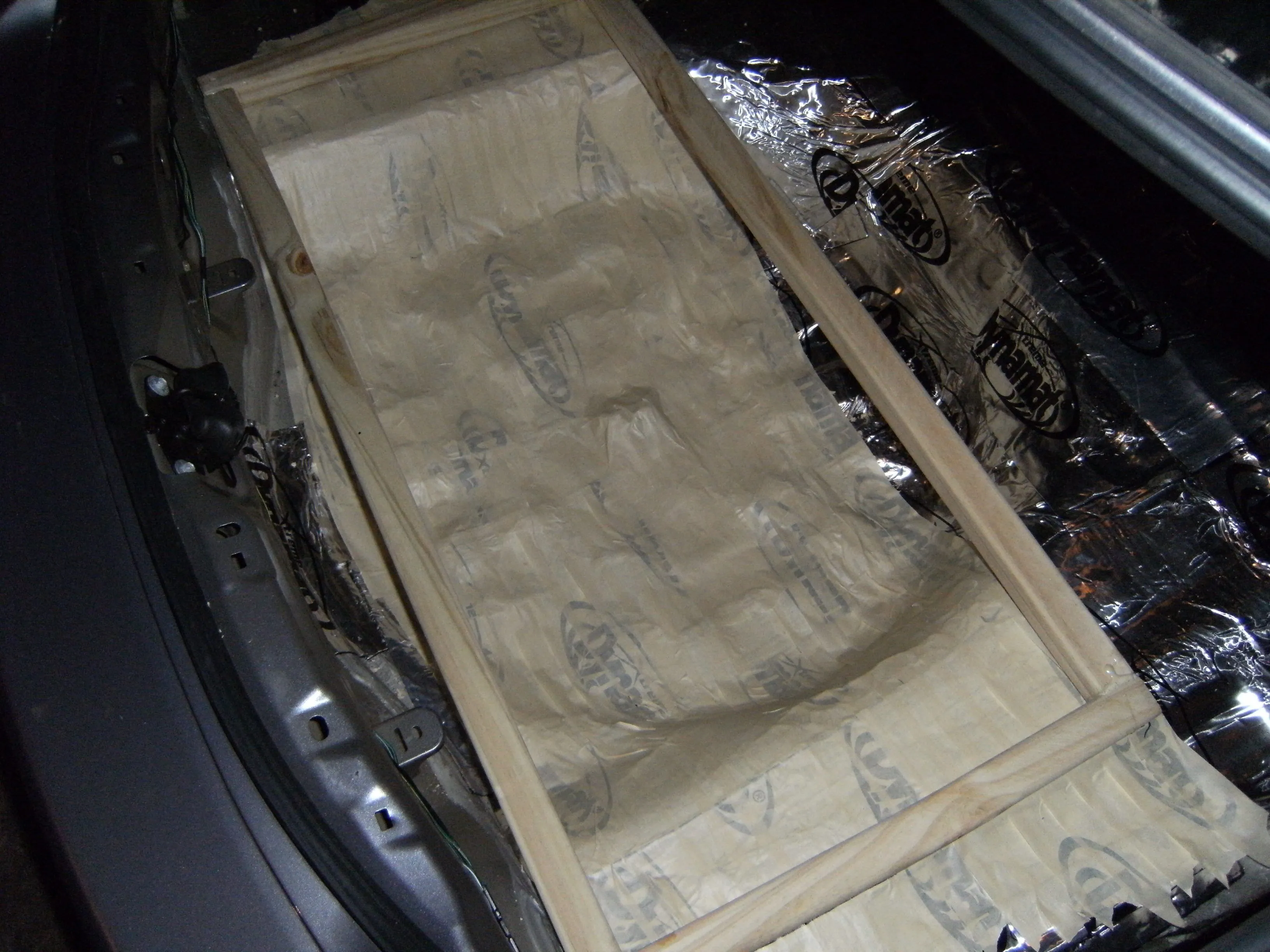

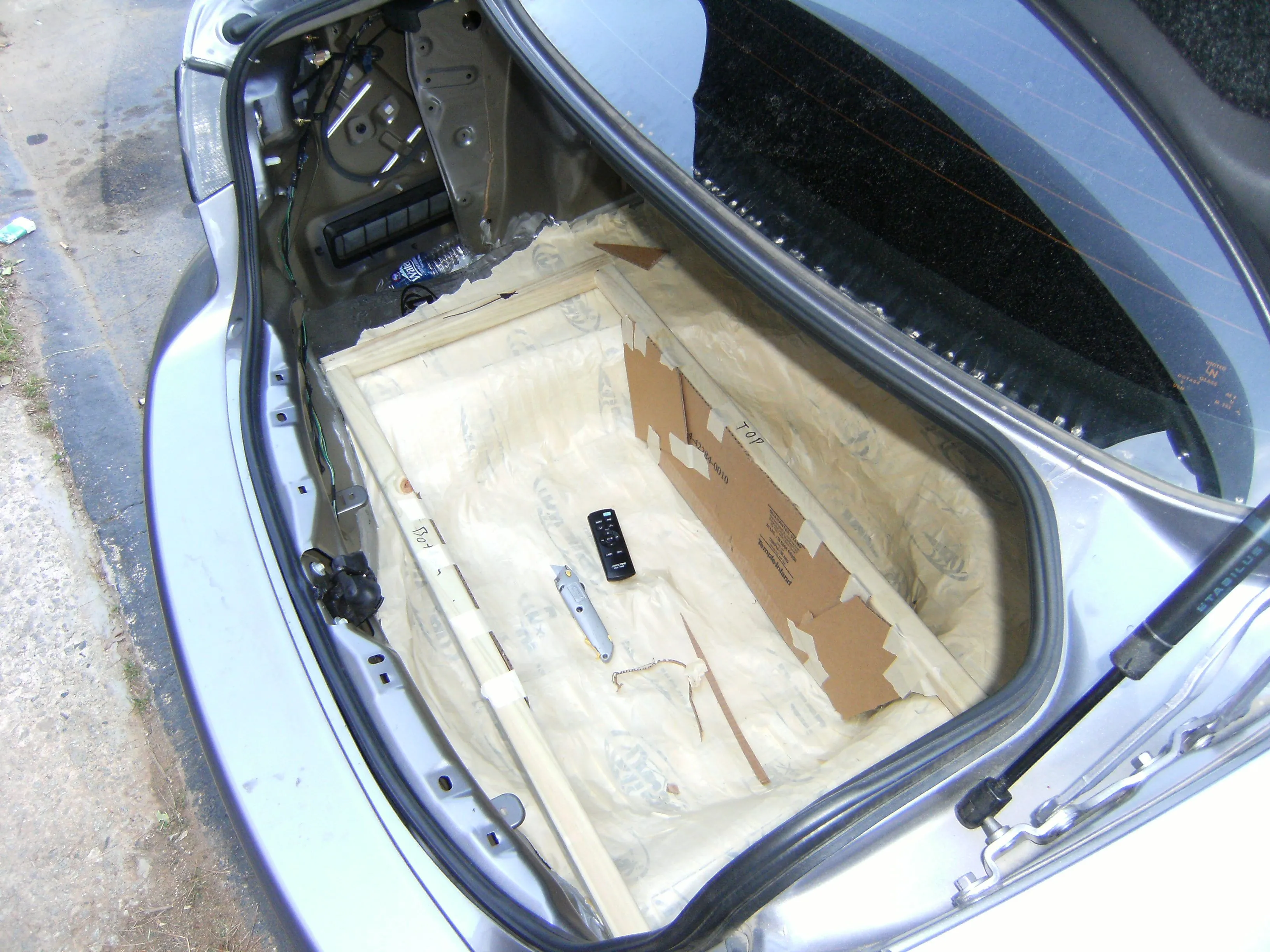

masking and frame work stage 1 frame I will add on to the frame and you will see the box starting to form I wont start the glass until thurs or friday since the temp. will be alot better for cure times with the glass work.

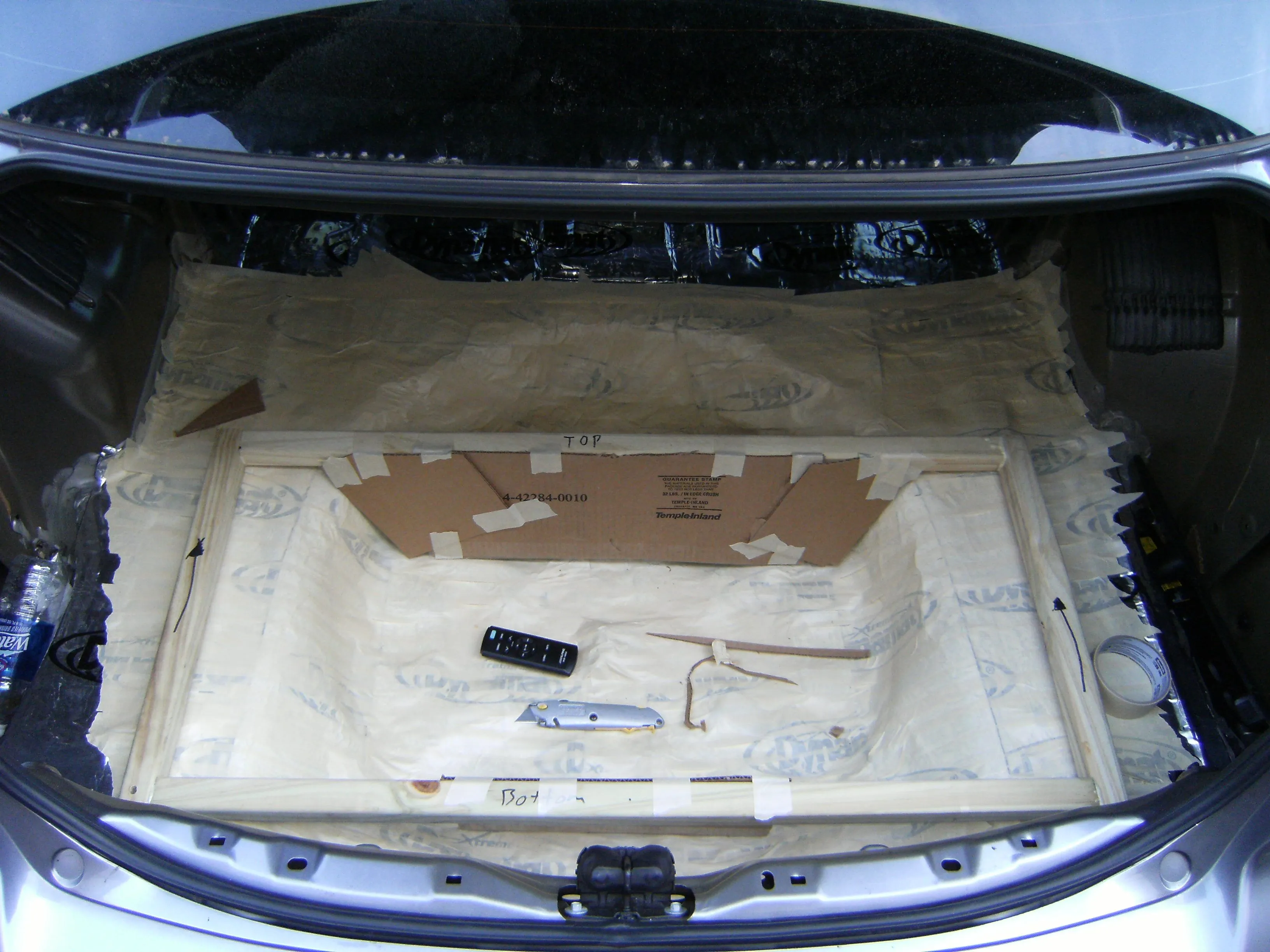

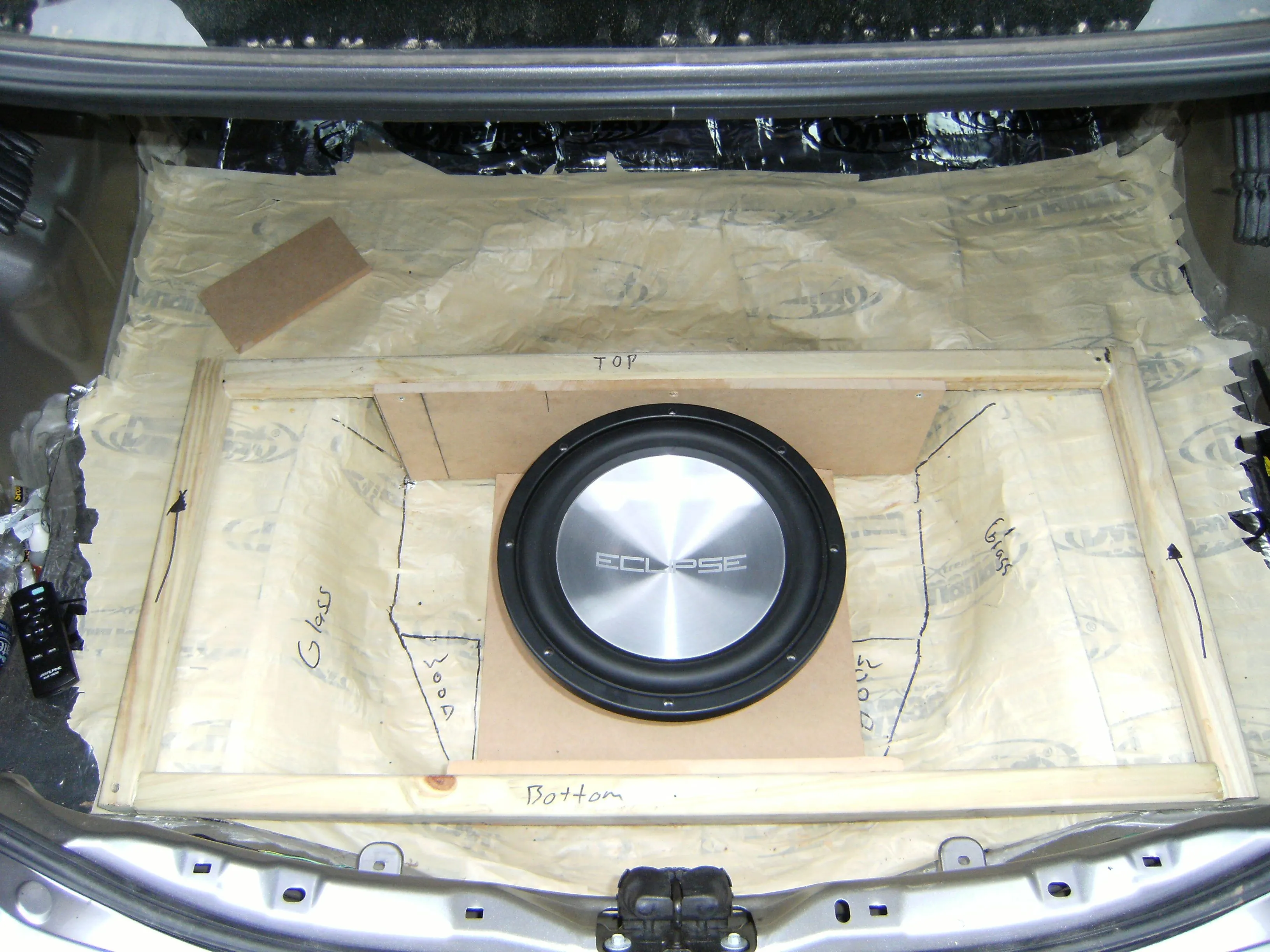

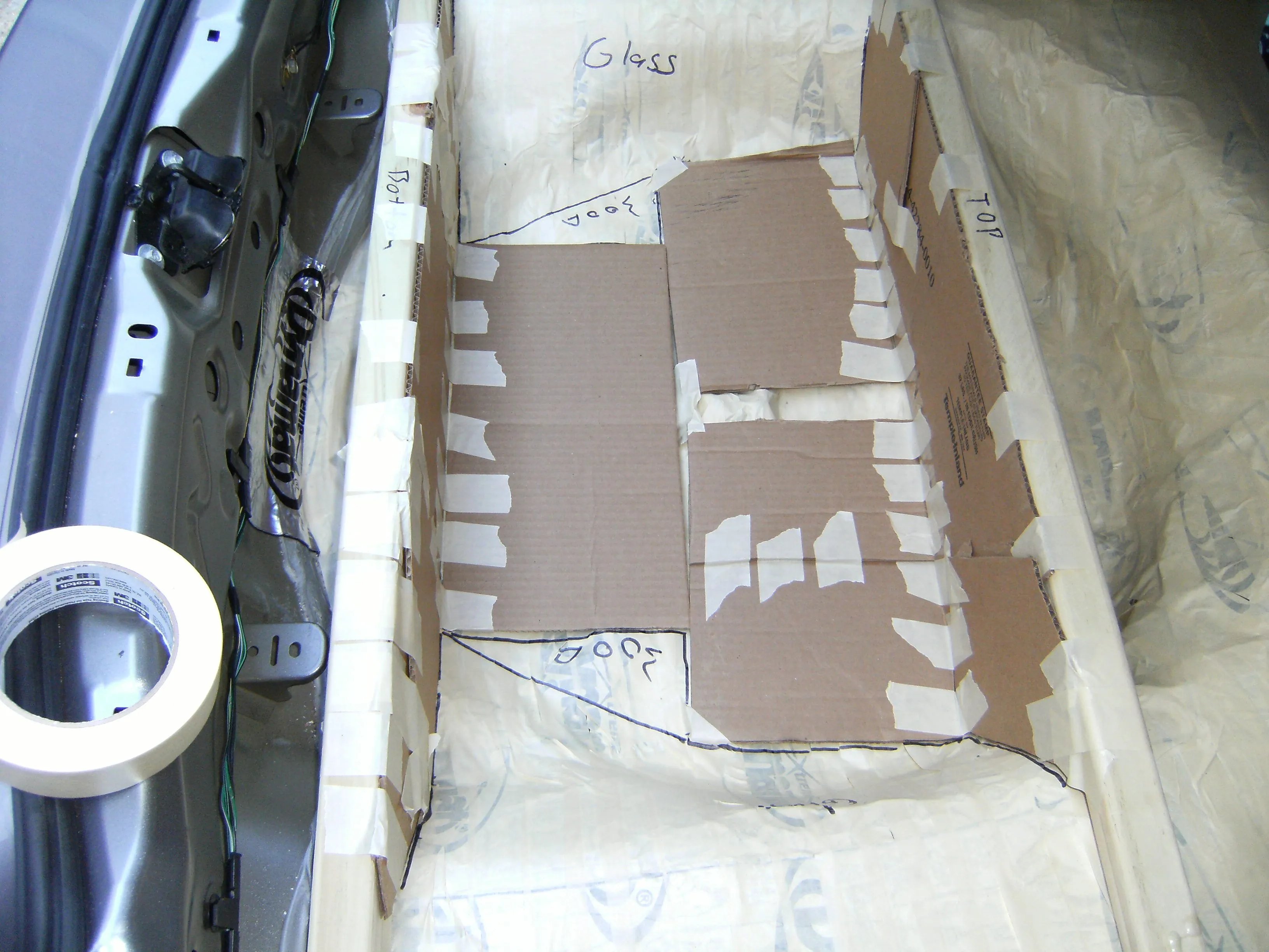

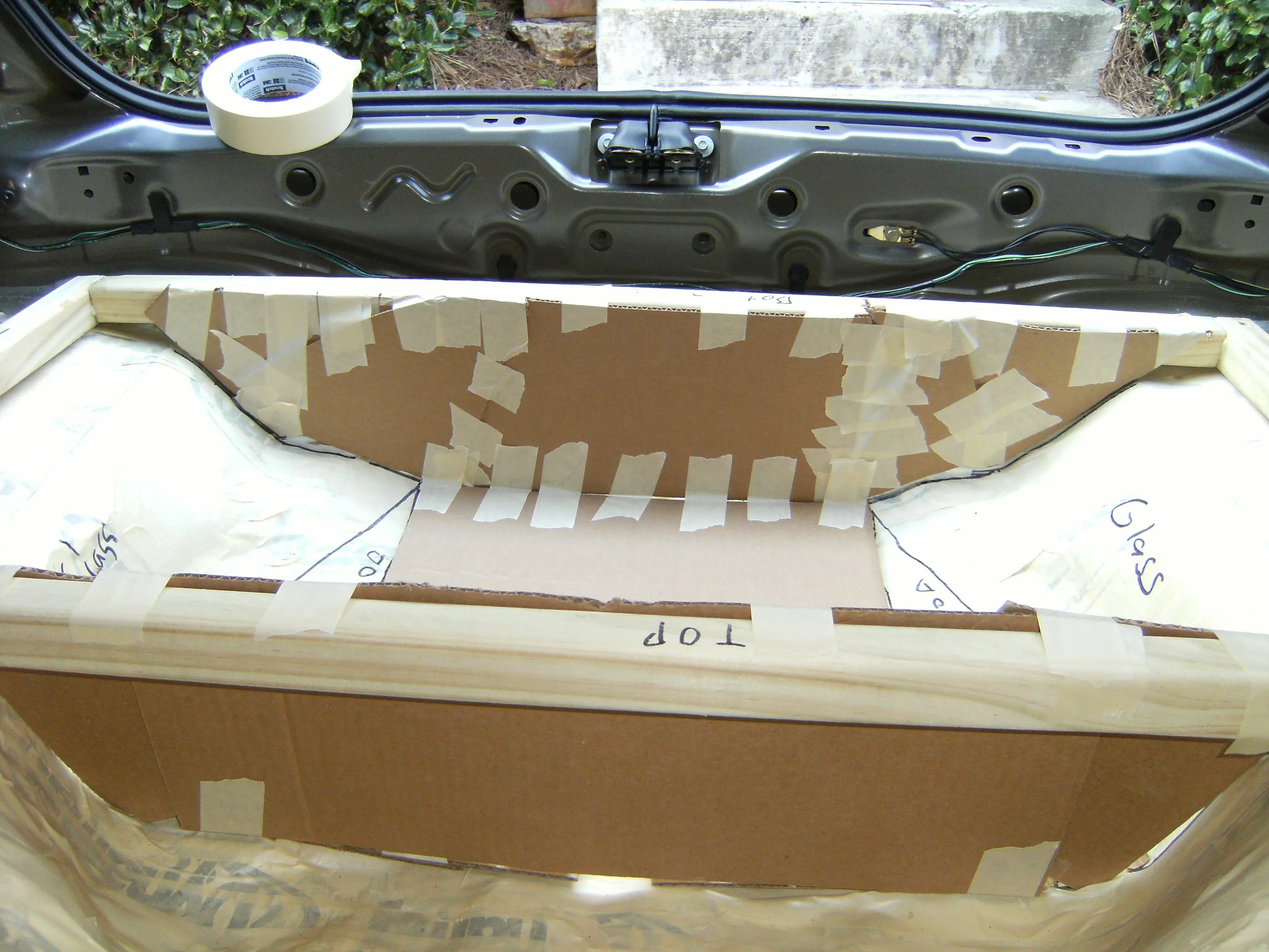

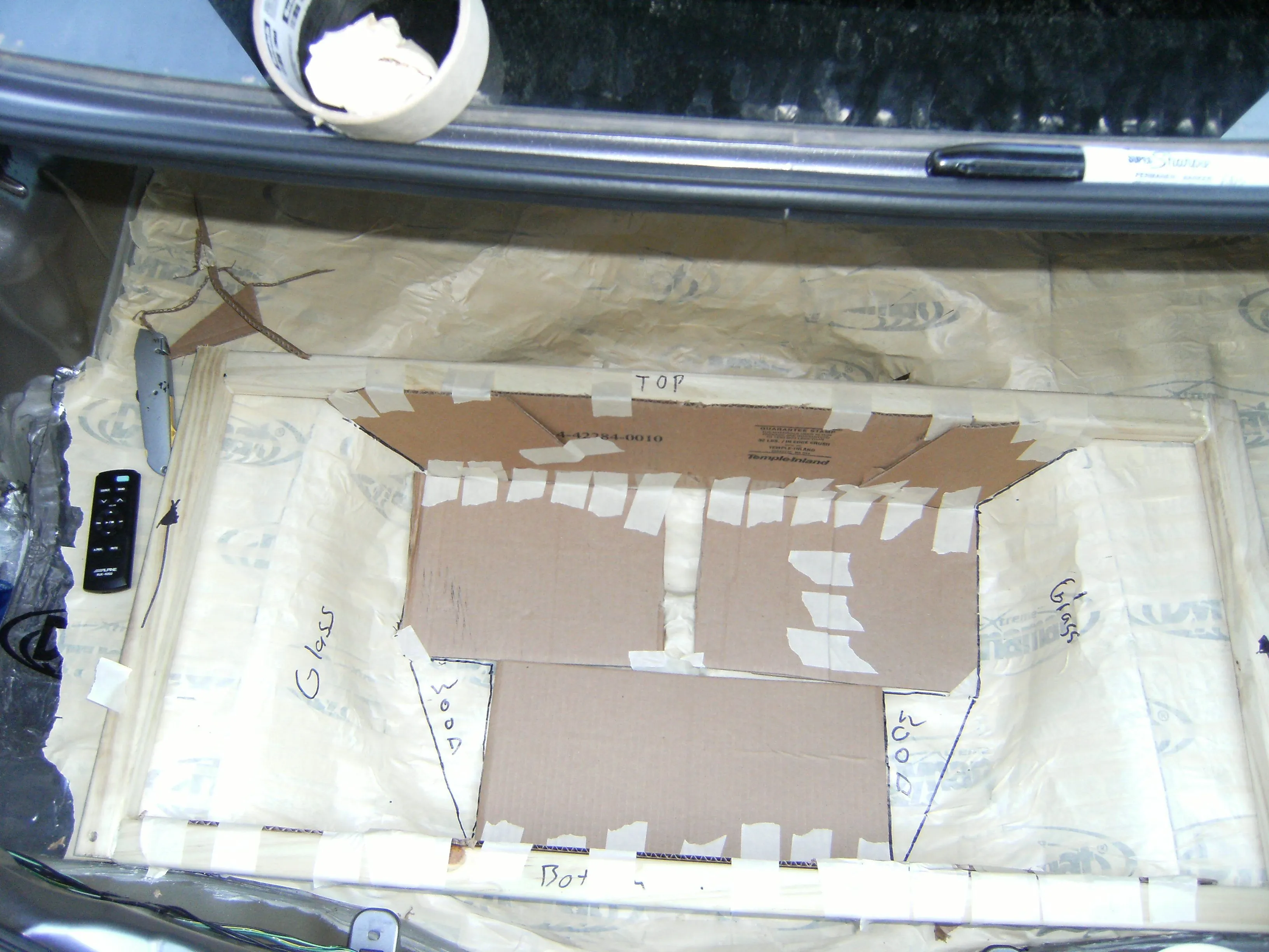

card board moch up for the wood framing on the inside of the box

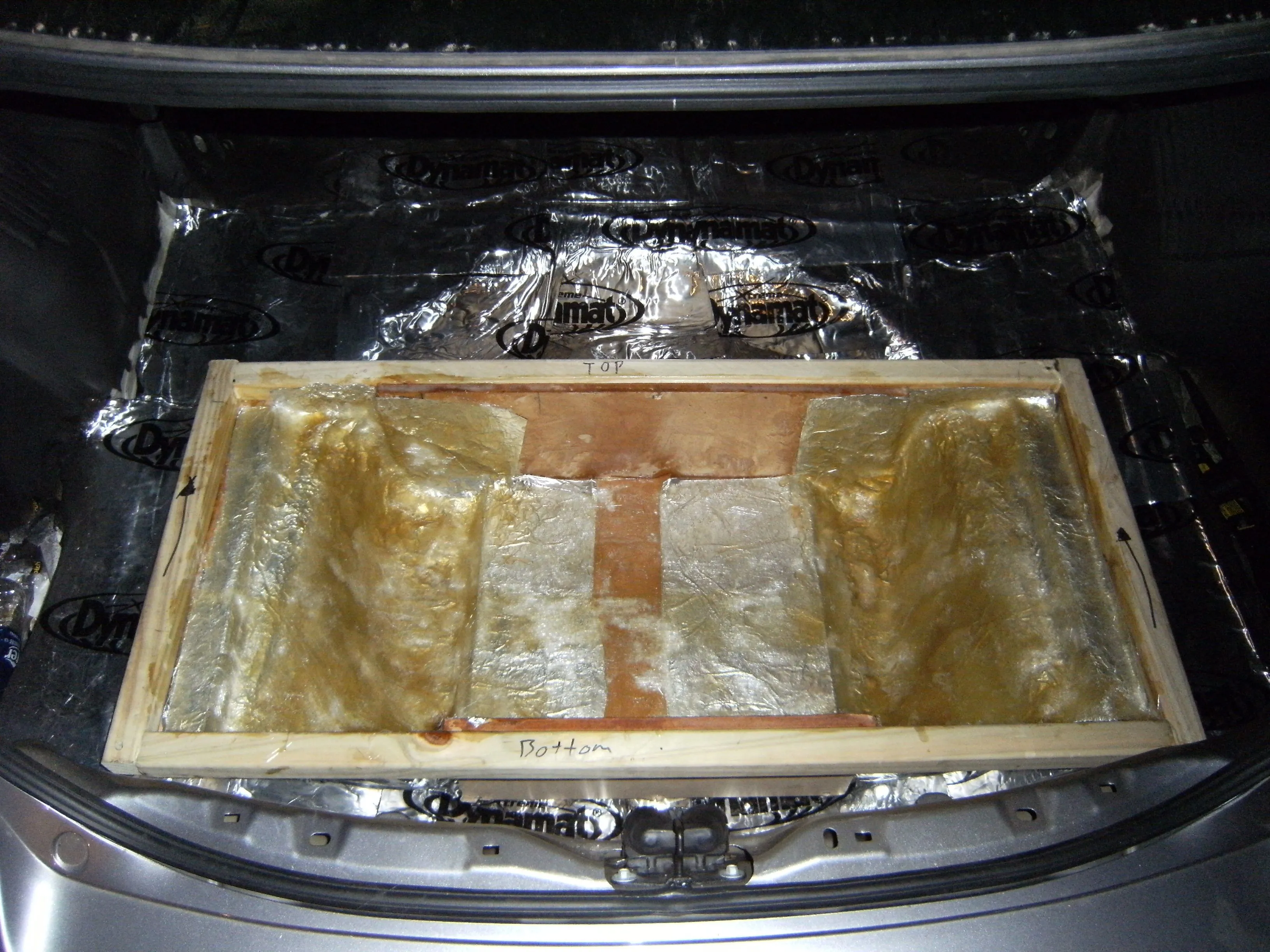

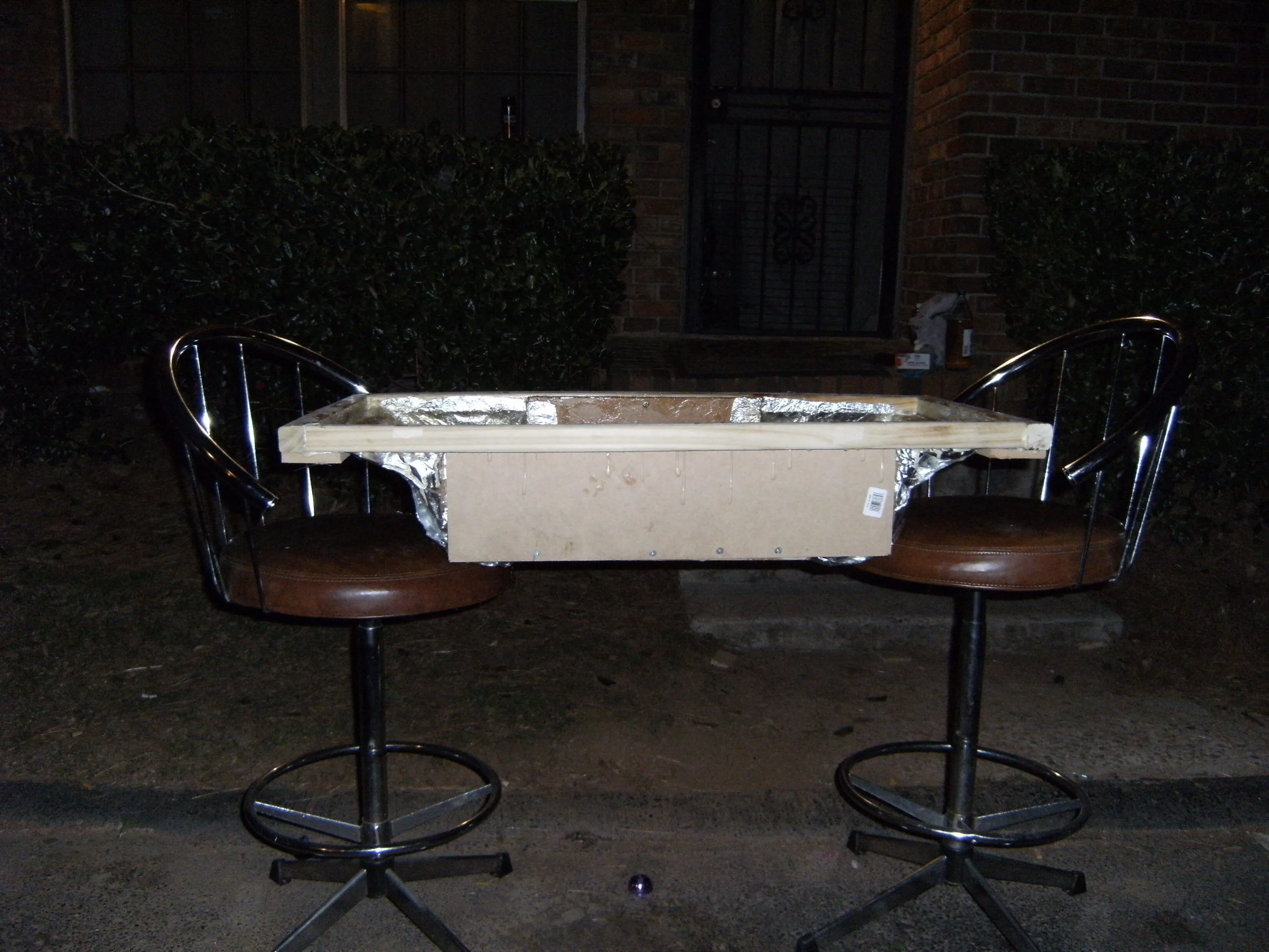

box is pretty much done just needs body filler for added strenth should be done next week weather permitting
