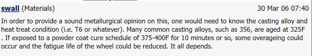

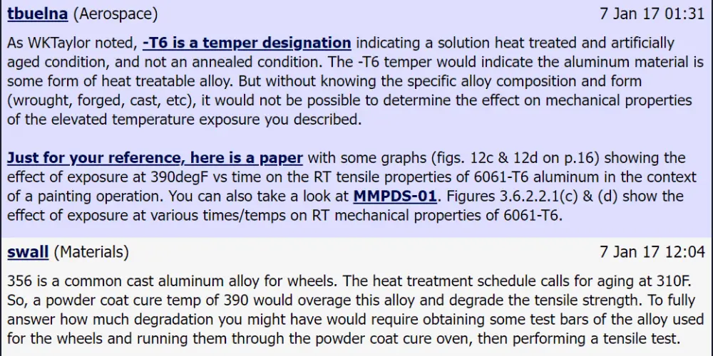

So went to the engineering boards...
Apparently most cast wheels use
Alloy 356-T6 aged @325°F
While forged is 6601-T6 aged @ 350°F.
Any exposure (even 10 minutes) above their aged temperatures can age the wheel further, weaken the wheel & increase it's brittleness factor.
Usually Powdercoat is done at 375° to 400° F for an hour or more.
Supposedly it will weaken the wheel, maybe not significantly but will change it from a T6 to T7 condition.
Not sure how much affect this would have on an already 20 year old OEM high mileage wheel. But apparently some manufacturers like Enkei void the warranty if Powdercoat.
Need to re-think this and maybe find shop to get sandblast and painted instead.
Or since it's a cast alloy, inquire if they can only bake the powder @325° F and no higher. and then hope they actually do it @ 325°.

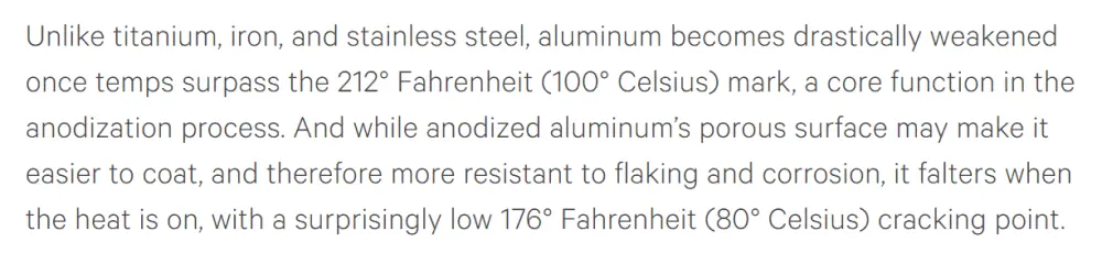

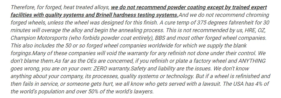

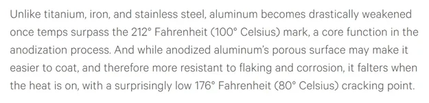

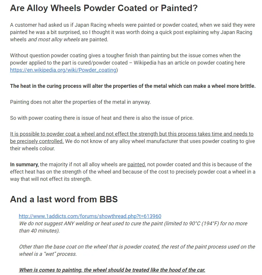

See attachments below.
Also, Inquired of six different manufacturers and received two(2) responses that recommend against powder coat and the rim companies noted that powder-coat heat ranges WILL ALTER the structural integrity of the wheel.
One has to remember that alloy wheels are not just aluminum but combined with other metals like silicon(7.5 %) and magnesium(approx. 1/2 to 1 %) which might be weaker. The rim is only as good as it's weakest link. it sounds as if not only is the aluminum altered at powder coat temps, but apparently something happens to the silicon crystallization when reheated, especially at powder-coat temps and magnesium, well hey its magnesium.
Also, from what am learning so far, it appears that some wheel manufacturers may powder the prime process @ low temps(that is key), but then liquid paint(am assuming they mean spray paint as well) and clearcoat the rims without any further heating process.
If there are any aftermarket manufacturers that do a full color powder coat, it would be interesting to find out what temp and time they bake at. Most likely it's a low bake.
Be aware that a manufacturer Powdercoat at controlled temps/times which has a vested interest in limited liability is different from taking your wheels to a shop for a Powdercoat re-bake where you have no control over what temp and time they bake your wheels, nor how lax their quality control is(f.e. baking at higher temp or leaving in longer)
My original post was concerned with having my wheels re-done not a factory powder-coated finish.
From metallurgy boards, Aging temperatures for alloy 356-T6 is between 310 and 325 F. Going above those temps(which most powder-coaters do) can alter/weaken the wheels. Some research even suggest that any temp above 200 F can start to cause changes in the alloy. Again you would need to consult a metallurgist.
Can wheels be powder-coat? yes
Can it alter/weaken the alloy structural properties? Yes, it appears so, especially dependant on cure temperature & length of cure. Higher, hotter and longer may mean less strength and more brittle.
How much will rim be weakened with increased brittle? A metallurgist would best answer your question as it depends on the alloy and what it was combined with, the curing temperature and the for how long it was heated.
Will it be unsafe to drive on? Depends, so far two(2) of the manufacturers appear to think so and have advised against it.
Will I powder coat? probably not. Will get professional sandblast and paint.
Local shop here powder coats at 375 F. Seems alot of shops, at least in USA powder @ 375, 400, 450 F, etc. Found a shop in Australia that only powders @ 180 F so the alloys aren't altered/weakened but still achieves a decent powder-coat. *;Powdercoat can cure at as little as 160 F. Don't understand why shops here can't powder at lower temps. Think it has to do with $$$, quicker in, quicker out.
It appears that powder coat itself isn't the issue, it's the high temps that shops want to bake them that causes potential issues.
Sadly if you want powdercoat, you may be better off buying an old stove, keep it outside, spray/powder the wheel yourself and bake it at 180 F.
At least you can low bake & control the process. Please be advised there could be ramifications from breathing any gases , consult the powdercoat msds and wear appropriate PPE masks, etc.
Again do your own research and contact your own wheel manufacturers, etc. and take your own risks.
