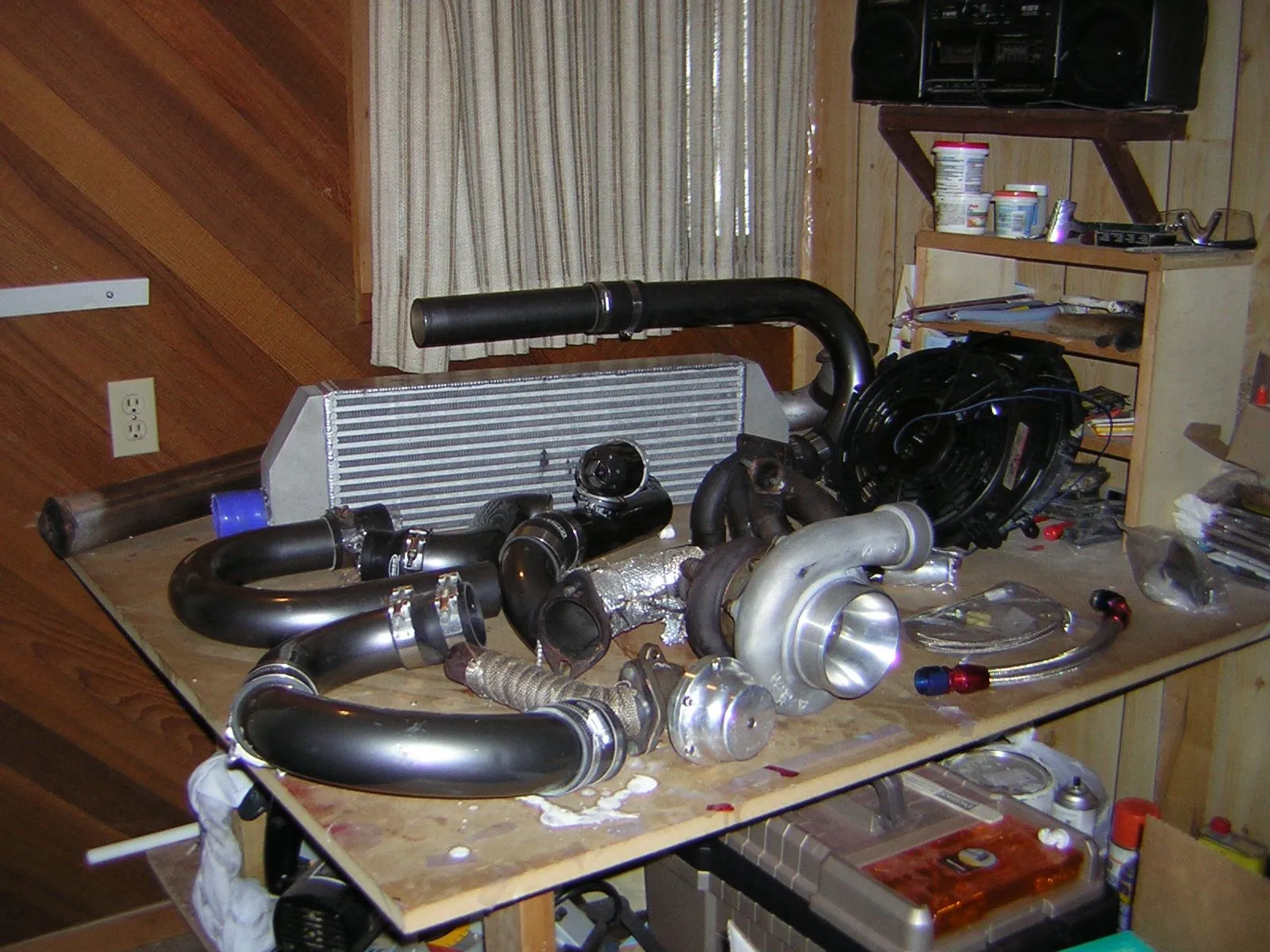

Hey everyone, just bought Bryan's old turbo kit (Asian6er) and I am going to do the install soon. Can you guys post some pict so i can take a look at your set up?
And do I have to upgrade the injectors and clutch right away...or is this a suggested thing to do...lol
Thanks guys!

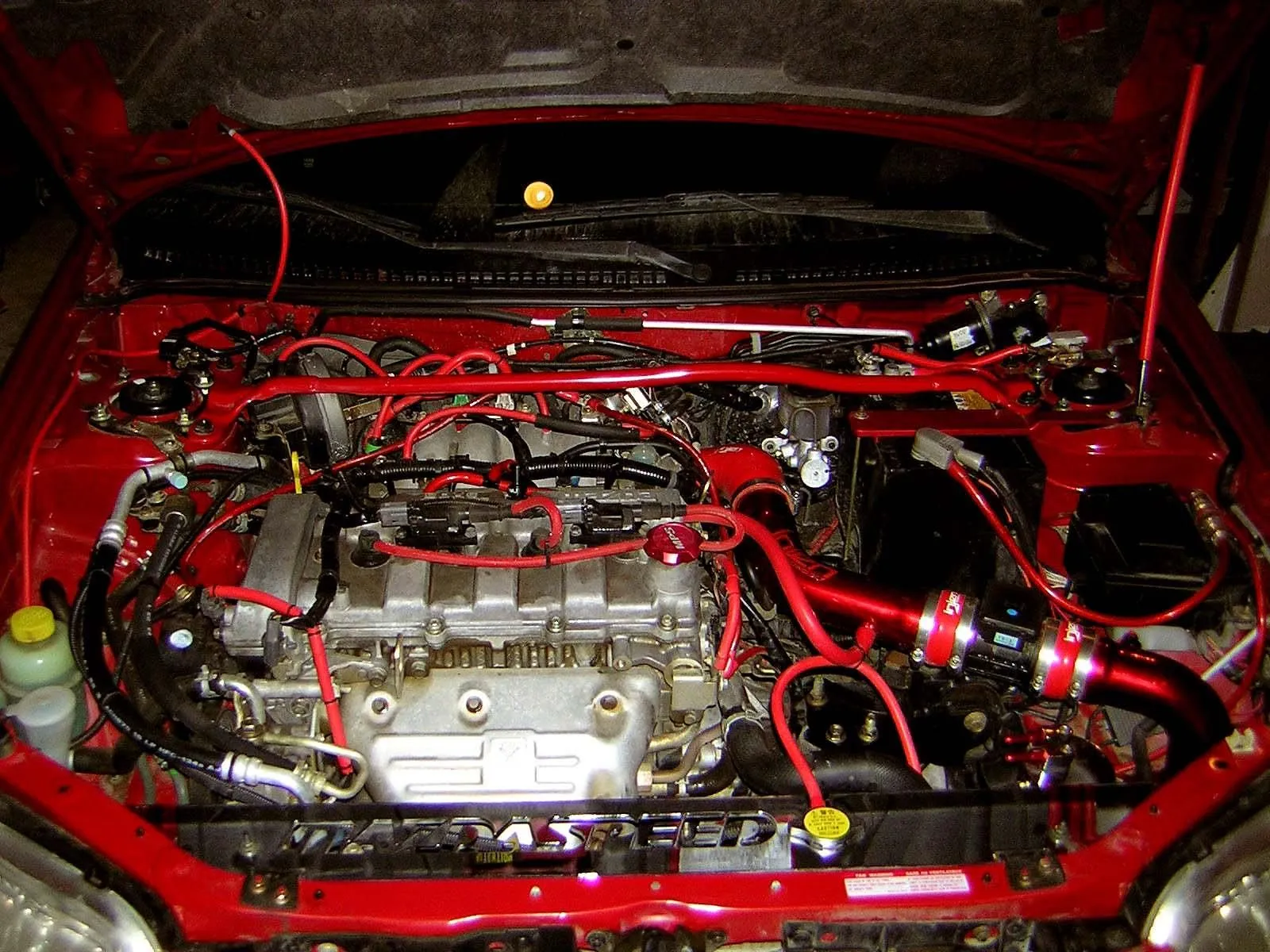

Here are a few pics of my kit installed, however it is a MAM SS kit so It may not help as much with your install.
As to answer your Q's, it would all depend on how much boost you are planning to run. If you are running 6ish pounds, you will not require upgraded injectors. However, I do not see any form of fuel control in your pictures. You will need at least a voltage clamp, FPR & possible upgraded fuel pump to add additional fuel under boost conditions.
The clutch will eventually be required also, some people on the forum have had good luck with the stock clutch lasting for a while, however may have found that after a few hard pulls the stock clutch will begin to slip.
Hope this helps.
