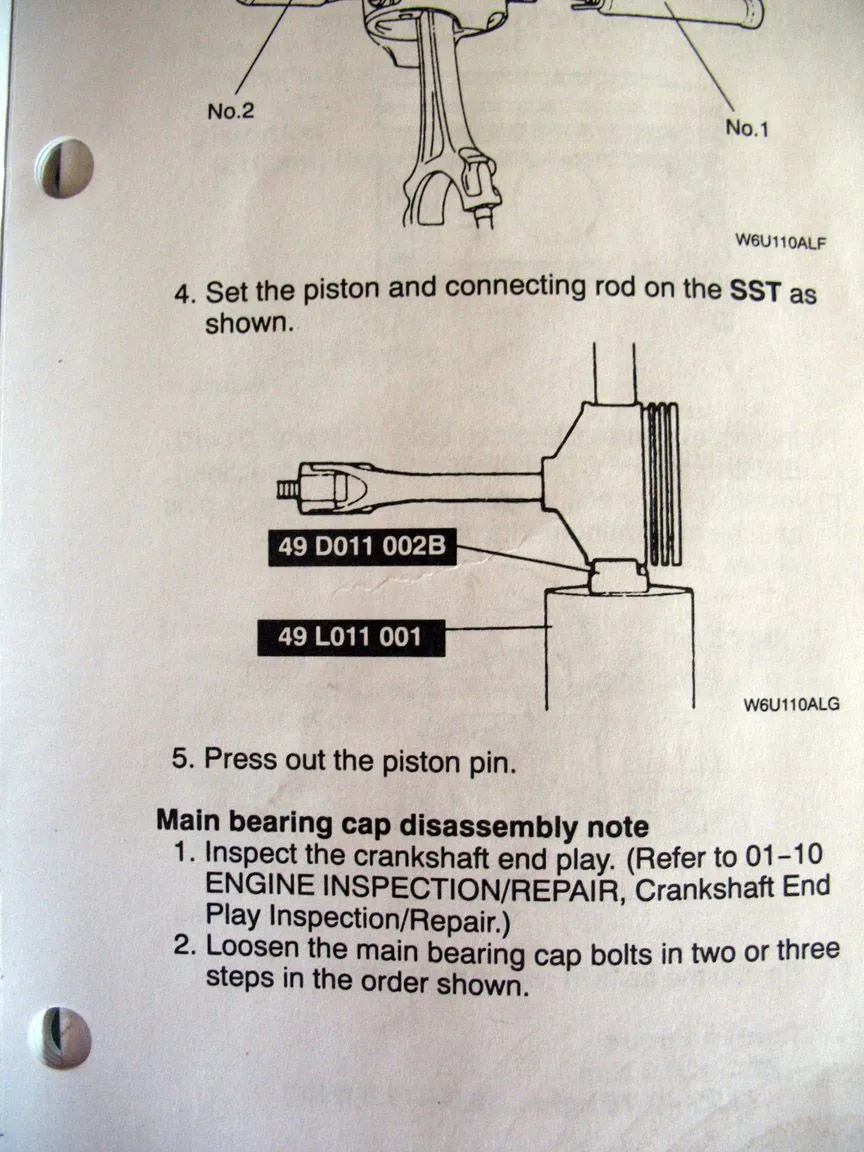

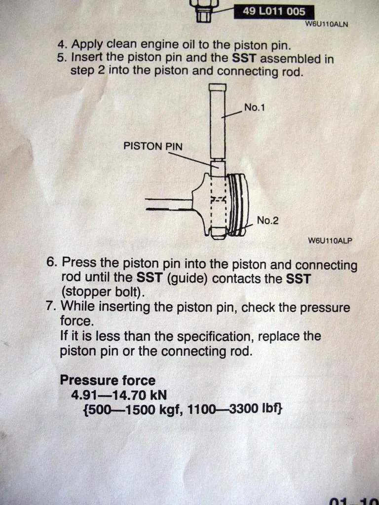

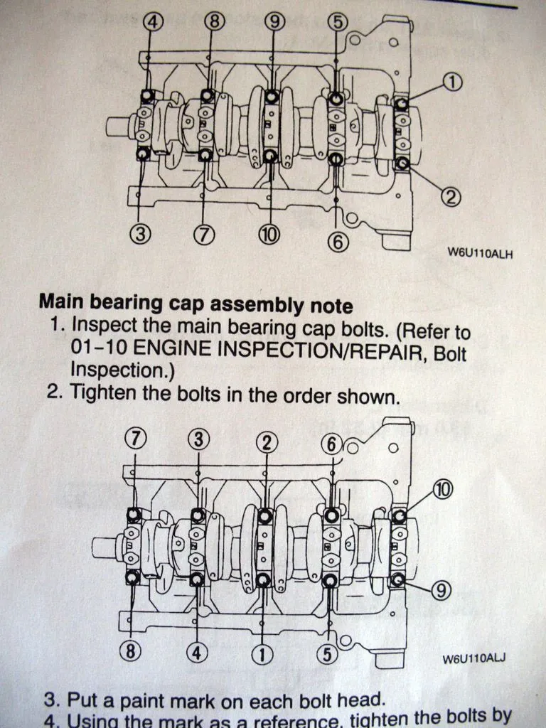

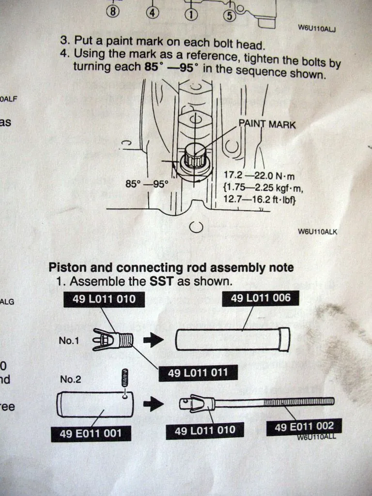

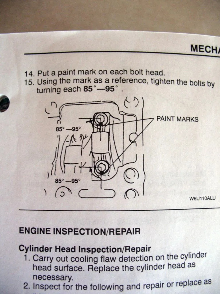

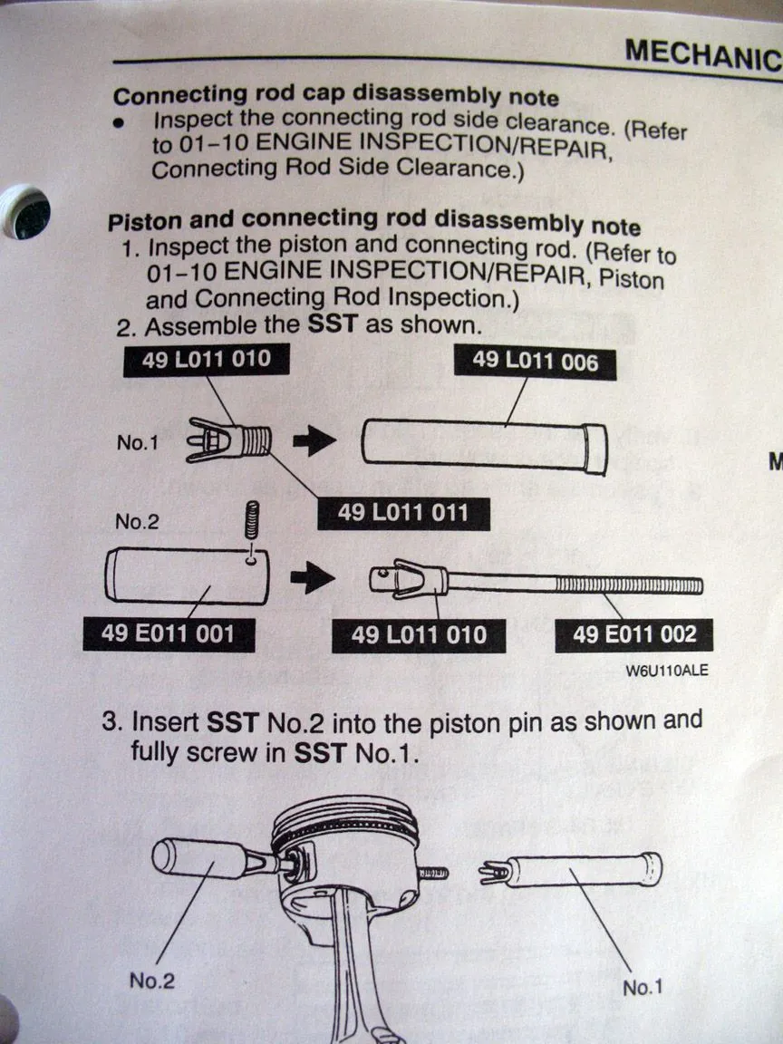

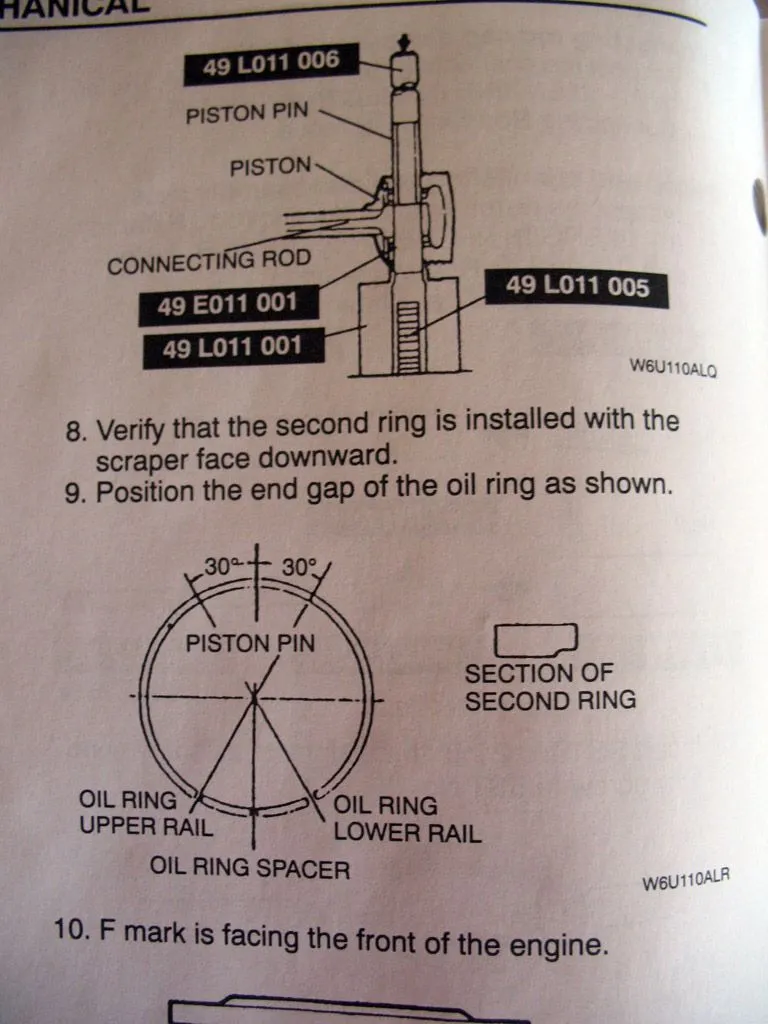

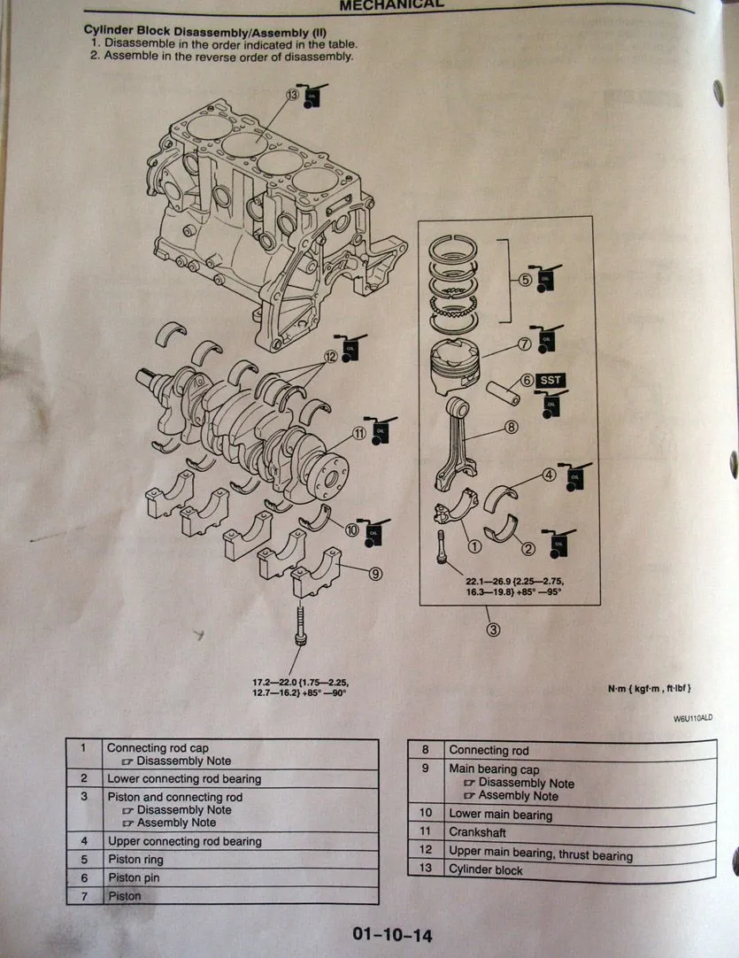

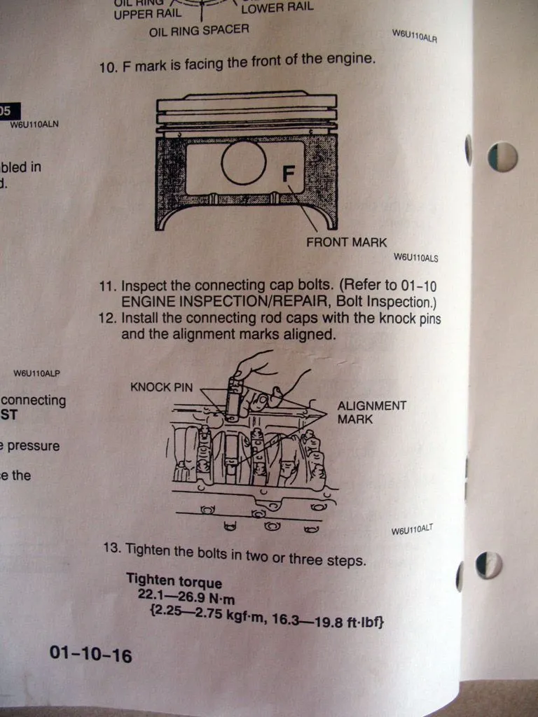

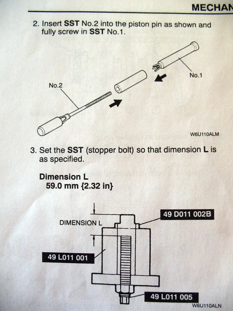

B bakketti Member Apr 21, 2007 #6 I am also looking for a 2002 Protege connecting rod torque spec. I have already purchased a service manual from alldatadiy.com and no luck. Thanks
A azeli73 Member Contributor : 2002 Protege 5 Turbo Apr 21, 2007 #7 here it is from the manual Attachments Page_1.webp 100.5 KB · Views: 2,354 Page_2.webp 109.5 KB · Views: 1,097 Page_3.webp 101.1 KB · Views: 1,287 Page_4.webp 108.3 KB · Views: 3,473 Page_5.webp 92.8 KB · Views: 1,229
A azeli73 Member Contributor : 2002 Protege 5 Turbo Apr 21, 2007 #8 cont. Attachments Page_7.webp 98.6 KB · Views: 860 Page_6.webp 85.4 KB · Views: 711 Page_8.webp 62.2 KB · Views: 719 Page_9.webp 73.4 KB · Views: 716 Page_10.webp 84 KB · Views: 793
